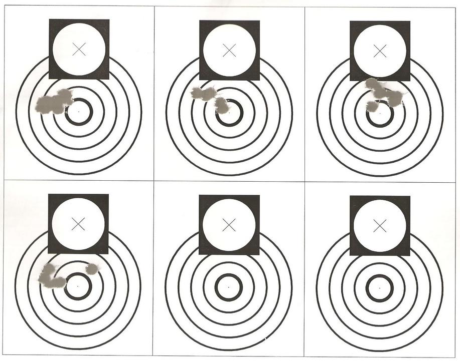

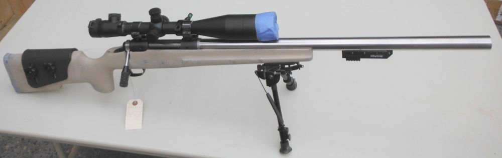

I built a 223 Sav 110 rifle this week. I used a Lothar Walther Chrome Moly barrel.
It still needs more paint.
I had some ammo I loaded 8 years ago, 33 gr Vmax 15 gr Blue Dot, mixed brass FL sized with .246" neck .
I took it to the range today and fired 3 shots at 50y to get it sighted in and then 4 groups of 5 shots at 100 yards.
The 4 groups of 5 shots at 100 yards:
1) 0.426"
2) 0.533"
3) 0.533"
4) 0.900"
What was affecting accuracy?
1) wind
2) forgot the rear bag, and the cross hairs were jumping around with my pulse rate, as I used my left hand fist as a rear bag.
3) The Copper fouling was increasing with each group, in this never shot before barrel. It needs to be broken in. The round count is 23 rounds, time to clean.
4) The light was so dim I had to reduce magnification to get the exit pupil up. That got rid of the fuzzies.
5) Heavy gun and light bullet, makes the gun not change direction much before the bullet exits.
What was not affecting accuracy enough to matter?
1) The recoil lug touches nothing but the barrel, the receiver, and air. There is no epoxy behind it, only air.
2) The muzzle has no crown. It is unchanged from when the manufacturer turned the barrel. Rough and with a countersink for a live center.
3) The ammo was not tuned to anything. The blem bullets weigh 33 gr and should be 35 gr. They are moving ~ 3500 fps.
4) The action does not touch the stock or bedding. The action touches two home made 1/2" pillars fitted to the receiver radius.
5) The action is not trued. This is from 1988, days before Savage went bankrupt and never made this 4.522" between screws action again.

I did not figure this out, I accidentally cut a chamber with the reamer wobbling .005" all the way to headspace.
Then it shot a 0.75" 3 shot group at 100 yards. That was an old take off barrel being put on a surplus Mauser in 7mmRM. I did not expect that accuracy if the chamber was dead on.
I had been dialing in barrels with a 0.0001" Intrepid test indicator on a spud like that was important.
Had the ammo been .005", we would expect a ~ 2" increase in group size, per ABBATIELLO's example with a 30-06.
