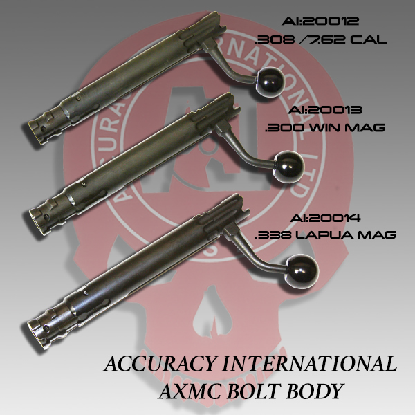

Hi,
Well it looks like someone needs to inform AI and Sako that their rifles would and could be much better in the extreme elements if they would flute those dam bolts......
Don't they know anything about rifles operating in the elements......
Sincerely,
Theis

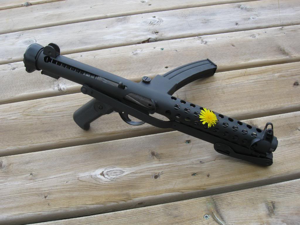

Sterling sub machine guns have fluted bolts. I can see the benefit with an SMG, but not
with a bolt action rifle
Hi,
Sincerely,
Theis

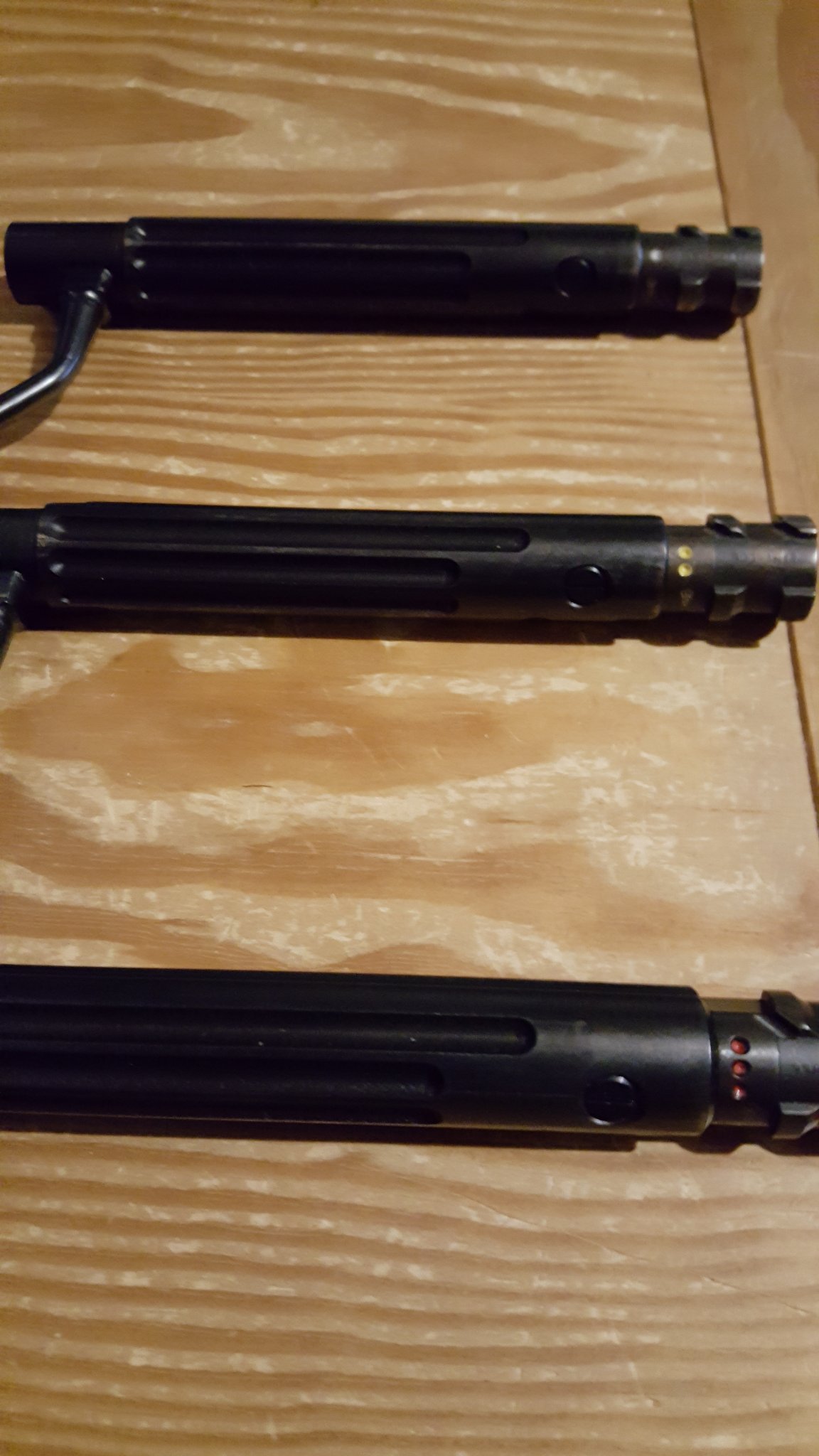

Did you tell AI already? :)

Comment from Tom Irwin of Accuracy International on SH thread dated March 18, 2017: @tomirwin
Mar 18, 2017
The flutes on the AI bolts started with the AW back in 1991. There was a requirement from the Swedish Army to hose the rifle in water and place in an industrial fridge for the weekend, after which the bolt had to open. Without the flutes it was frozen solid, with the flutes it was fine. An added feature is that it assists with clearing sand and dirt.
Tom Irwin
Mar 18, 2017
Tom Irwin
I guess he is full of shit... lol
- Carl
The AI has a full diameter bolt body and is fluted in the bearing areas between it and the receiver bore, NOT in a wide open, no bearing area of a 2 lug, reduced bolt body diameter Remington or clone.
Not even remotely comparable.
True, but the OPs question was " What does bolt fluteing do?", NOT "What does bolt fluteing do in a wide open, no bearing area of a 2 lug, reduced bolt body diameter Remington or clone", so sorry...

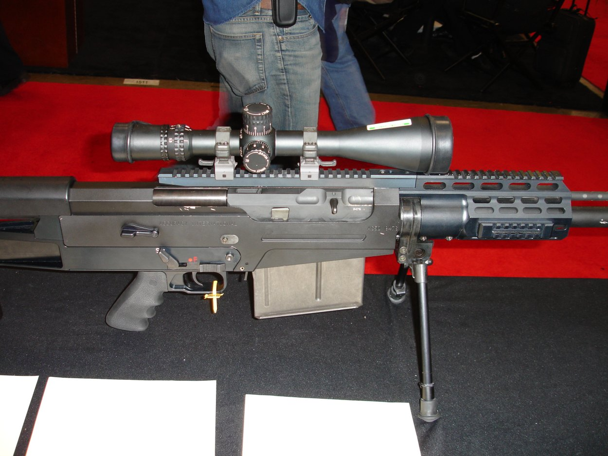

Too late. Vulcan arms has, or had interrupted threads on their 50 bmg rifles but they apparently had a habit of implanting the bolt in to the shooter.

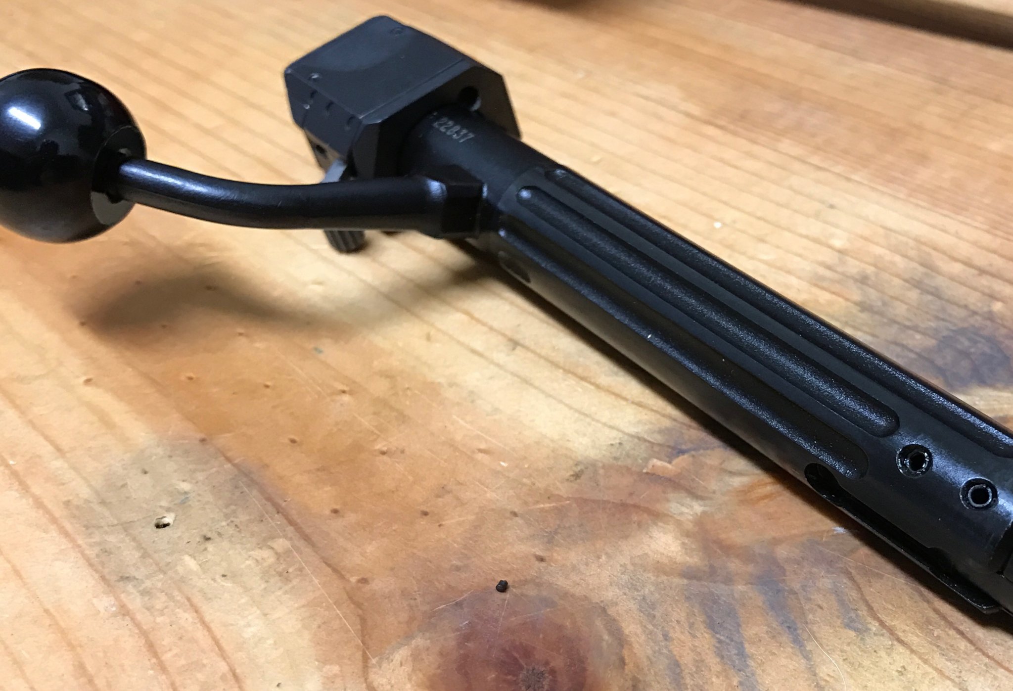

One thing I know it helps with. Ice. years ago I did a rifle for a client who owns an outfitting service in MT. The scenario went like this:
Wake up at the crack of dawn and head out. Ride around in a warm pickup for X number of minutes/hours till you get where your doing your thing. Truck is warm, guns are in the cab. They too are warm. Leave and head out in heavy snow fall. The stuff lands on the gun and melts. -for awhile. Before you know it the rifle cools off and its now got an ice cube growing on the outside of it. The light flutes that came with this particular action were not enough to crunch through it.
So, we were asked to pick up the existing flute and cut em deeper. The report back to us was that it solved the issue.
Its not something I normally use as a sales pitch for this kind of work, but in this instance it did seem to help. We never had another complaint.

I have had bolts freeze closed on a few occasions. Most if not all involving temp change, rain and or snow. It is a fact that the fluted bolts open better in icy conditions.
Reactions: abn31c
Not sure if the flutes cut the ice, induce stress points for the ice to break or simply provide less close contact surface area where ice can freeze the bolt closed.
