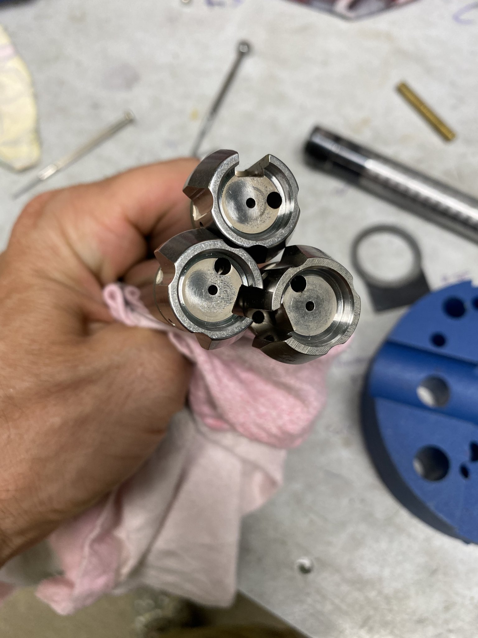

You can start with a .473 face.

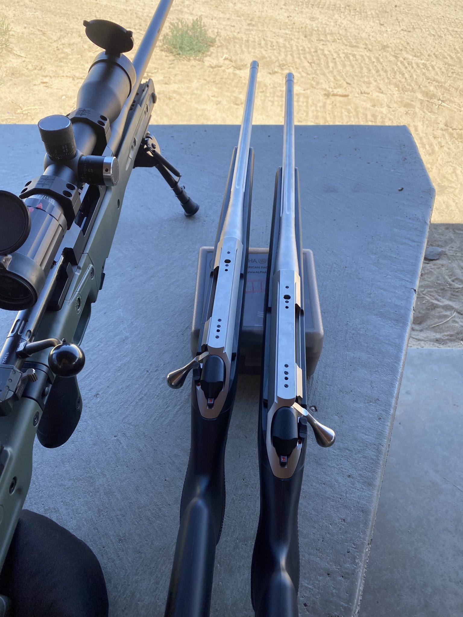

Here are two that started as Creeds..
I am new to the gun building world. Can you explain why it wouldn’t have to be a magnum with the .532 bolt face?
Thanks,
Josh
It DOES need a .532 bolt face if you're not going to change the way it came from the "factory". Shooter71 is saying that a .473 bolt face can be enlarged to .532 by a machinist/gunsmith, as he did above.
