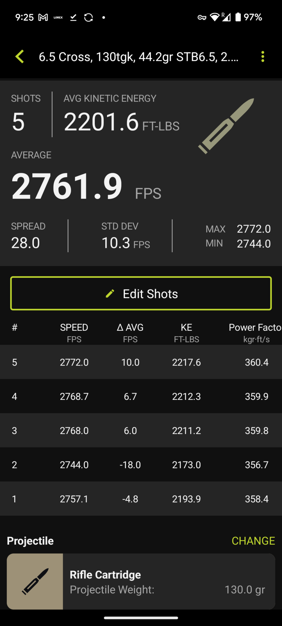

    I'd honestly give Staball 6.5 a try, it's been a great shooter for me and has usually given at it near top velocities, even with lighter bullets. Here is one of my 130gr loads for my Sig Cross, admittedly an 18" barrel, but also a heavier bullet, I'd expect you could find a good load around there with your 123gr if you wanted to.

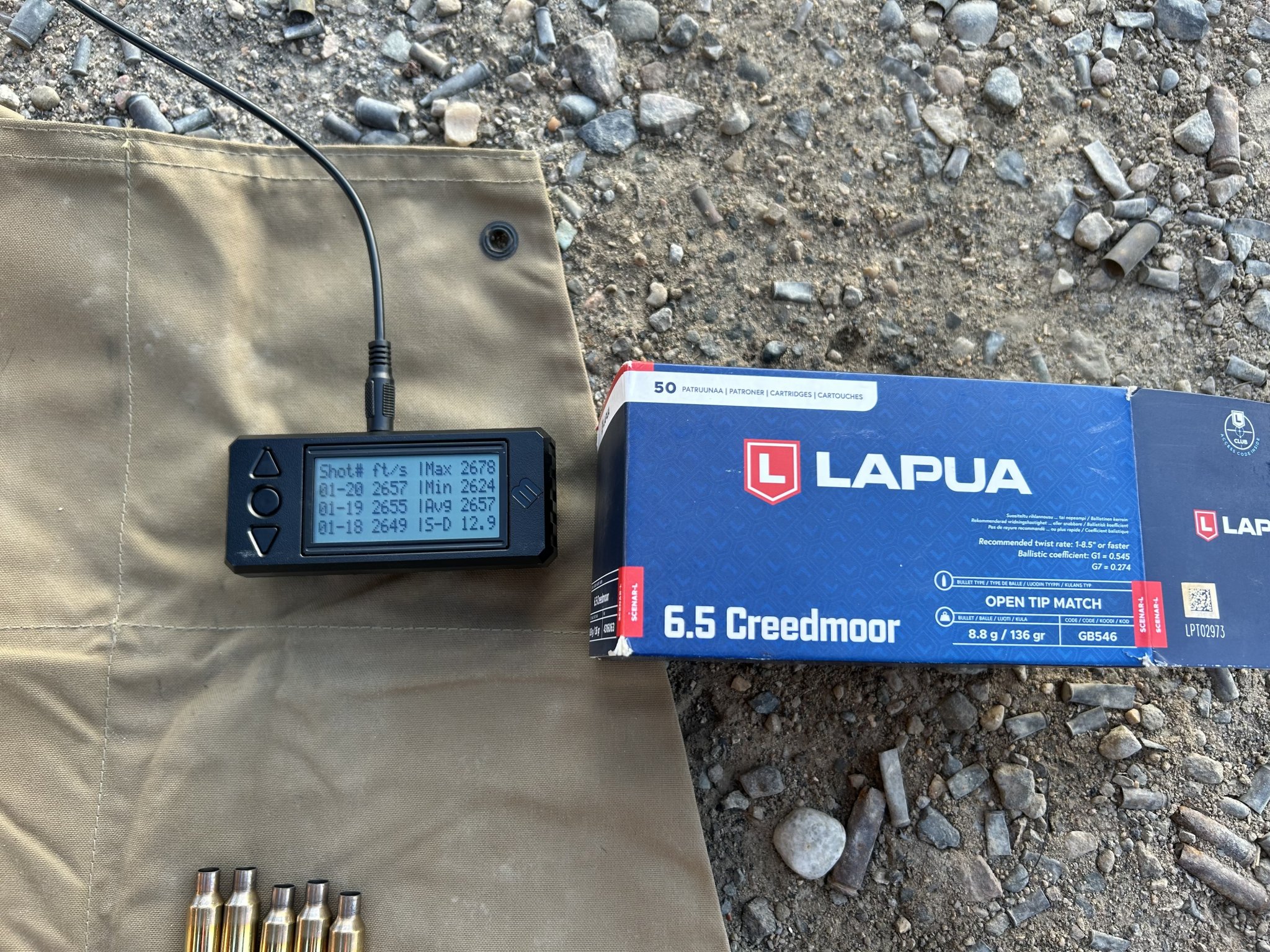

    I'd say that's quite slow. My go to load in 6.5 Creed is 140 ELDMs at factory COAL (2.200" BTO) with 42.0gr H4350. That gives me 2650 in an 18" barrel, 2720 in a slow 24" barrel and just shy of 2800 in a 26" barrel.
