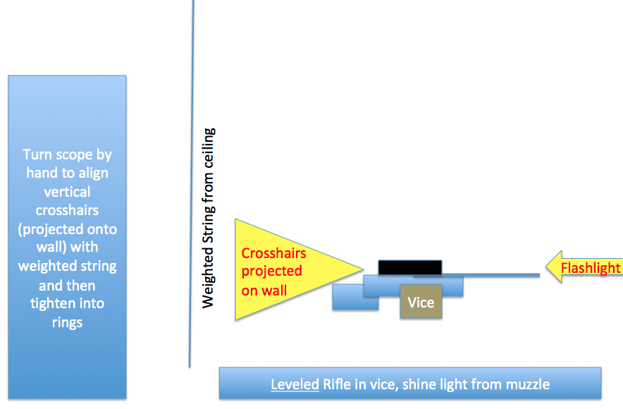

Here's the oddball method I use:
I use a torque screw driver, weighted string, vice, flash light, and a small magnetic level.
I put the rifle in the vice and get the rings attached to the rifle receiver per torque specs. I use loc-tite although I know some say it's not necessary. Then I put the magnification all the way to the max and set the eye relief. Once I get the fore/aft set right I get the scope leveled.
I have a weighted string hanging from the ceiling at one end of my bench. I dim the lights and shine a flashlight through the scope from the muzzle end and it projects the crosshairs onto the wall out past the butt stock.
I also have a very small magnetic level that I put on the rifle receiver. With the small level showing the rifle is correct I twist the scope until the crosshairs projected on the wall are straight up & down with the weighted string--all while making sure the rifle itself is still level. After everything is aligned right I torque everything properly and repeat the weighted string test to double check.
Maybe I'm doing it wrong, but in theory that should give me a perfectly leveled scope. It's worked out pretty well in practice thus far.

Here is how I do it. There are probably better ways but this has worked for me.
Reactions: OH_FAL

Poor fit is a poor excuse given today's highly adjustable options.
When the error induced by leveling the scope to the horizon and not to the rifle is so damned small, your expensive suggestion to satisfy dogma makes no sense.
