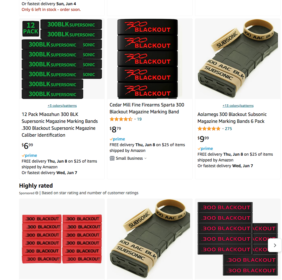

S strikeeagle1 Private Full Member Minuteman Feb 13, 2017 1,514 1,493 Jun 2, 2023 #3 Jun 2, 2023 #3 davidwillis said: They both use the same mag, so it would be very easy to accidentally shoot the wrong bullet. Click to expand... I just ordered some of these. Reactions: Keith E. and Queequeg
D davidwillis Private Minuteman Jun 2, 2023 12 2 Idaho Jun 2, 2023 #4 Jun 2, 2023 #4 Thanks! It is good to know that it will not blow anything up, or kill me. I also like the idea of the labels on the mag!

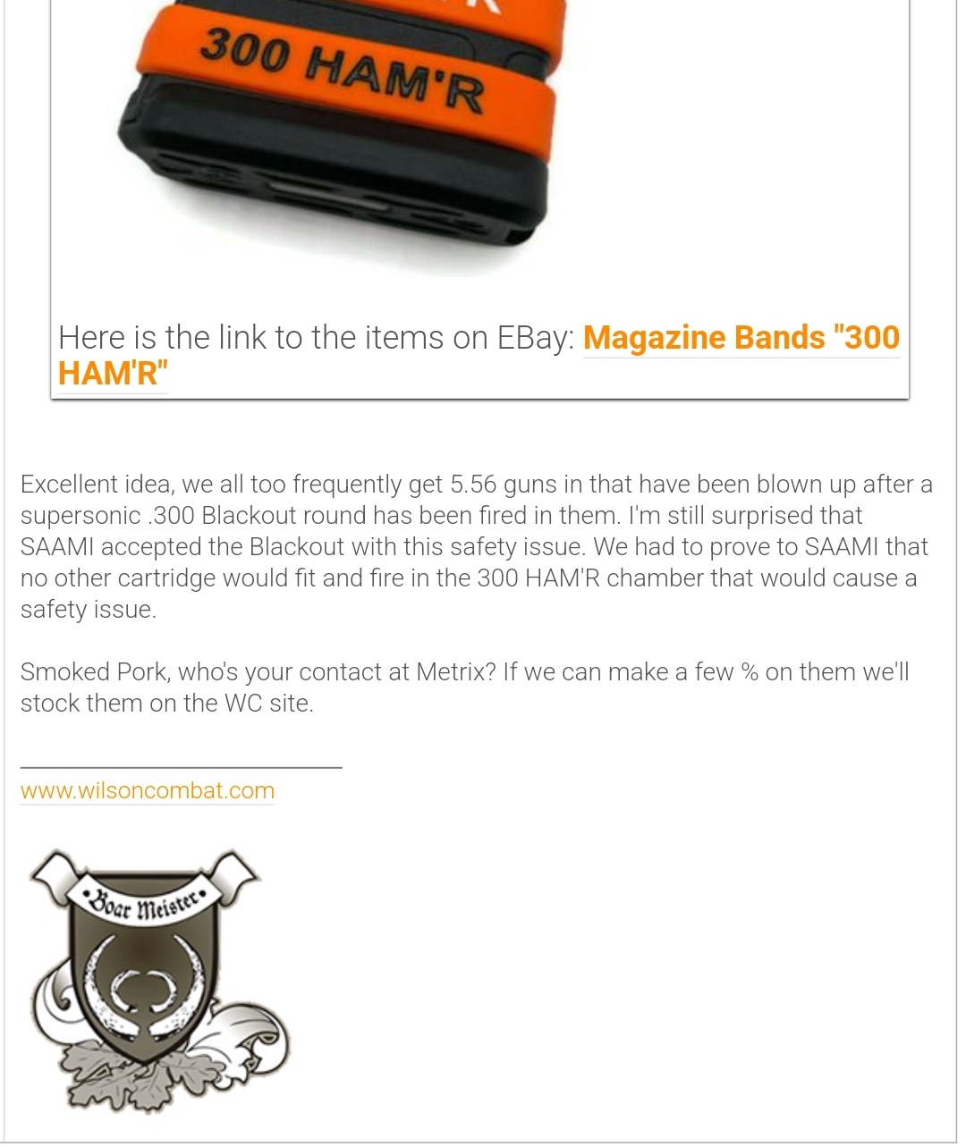

Ernest 5.56 Sergeant of the Hide Full Member Minuteman Apr 14, 2023 382 410 East Jun 2, 2023 #9 Jun 2, 2023 #9 Here is what Bill posted over on texas hunting about other calibers in the Hamr Reactions: Queequeg

Queequeg Door Man Full Member Minuteman May 16, 2008 1,646 21 65 Florida, Hillsborough county Nov 28, 2023 #11 Nov 28, 2023 #11 strikeeagle1 said: I just ordered some of these. View attachment 8153928 Click to expand... I did the same. Possibly around the time you did!
