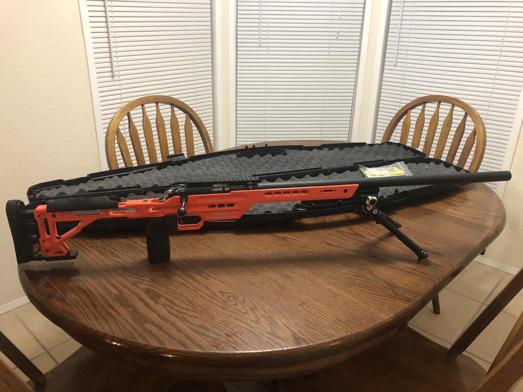

Just picked up a MPA/CZ rifle . What height 34mm and 30mm rings are lowest you can go with a 50mm objective?
Would seem to me lowest you can get would still work , just like to be sure before ordering.
