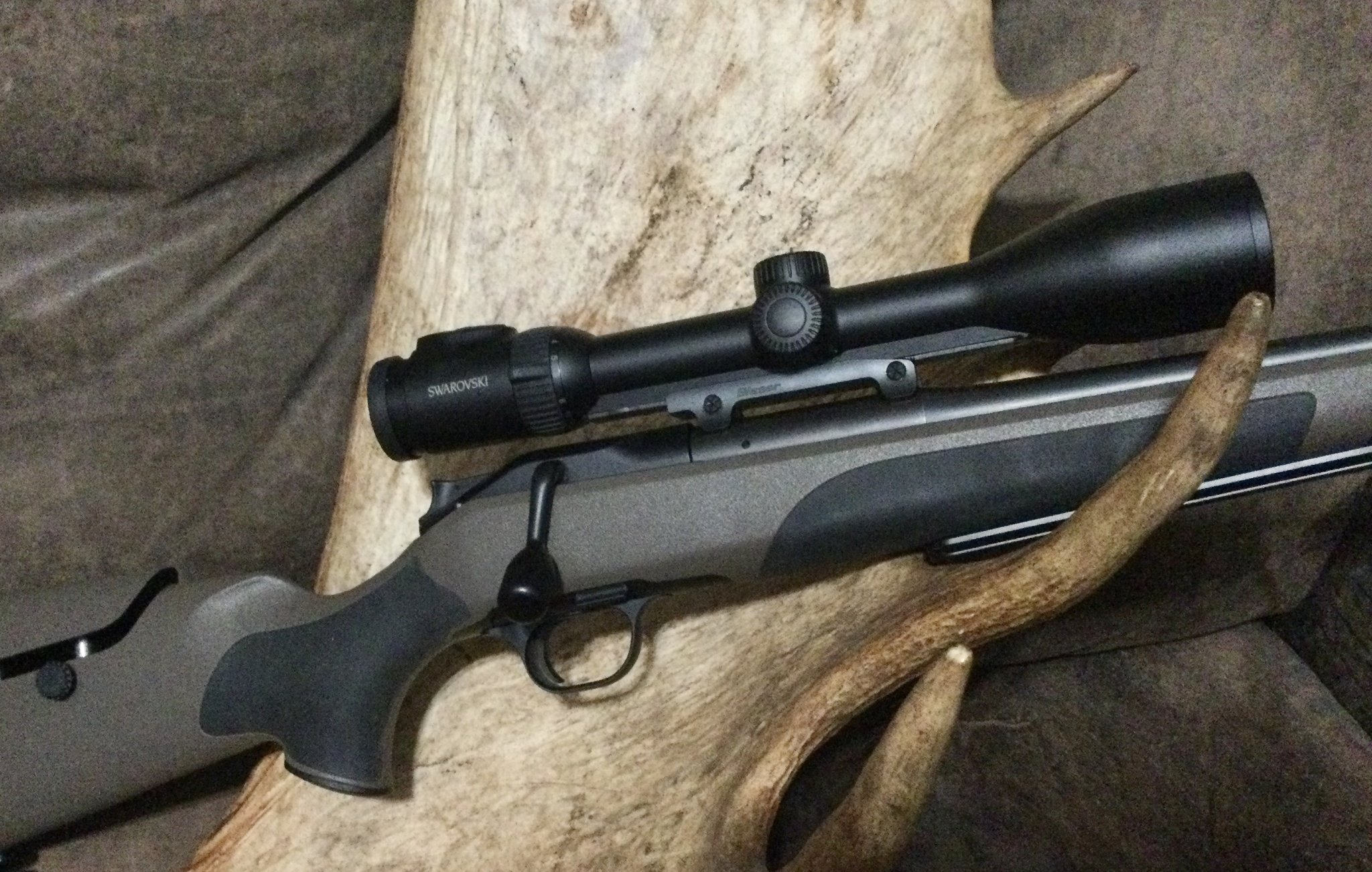

Why do you need rings at all? Just a stupid old design.
Just put a Pic clamp on the bottom of the scope.
This is the answer. For a while way back almost all mil scopes in Europe at least were STANAG. Scopes had mounting bosses and threaded holes fore and aft
Screws came in the bottom of the mount (here, a QD mount on a Sig 550) or even through the top of the receiver for direct mounting in some cases.
Starting to see integral mounts a lot more of late again and I like it. Mostly custom things like the Aimpoint T1 footprint cloned by Holosun et al, but then no clamping, no alignment, etc you just screw on whichever base, and mount it right up. VCOG is a full sized scope with an integral pic base. They use it cleverly to also mount the battery out of the way, but the principle even without that I quite like.
