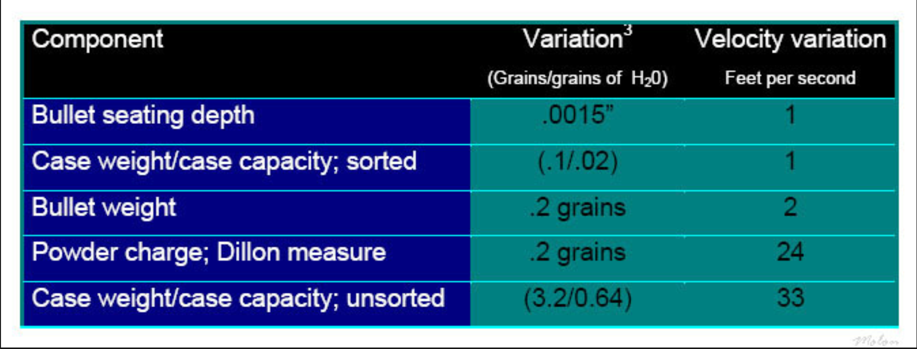

    .1 - .2 grains on a load in the 30s of grains could make some difference. That's a pretty big spread - in my smaller powders, I hit the mark exactly on a .02 increment scale. Powder charge is one of the elements that's most in our ability to control, so why not do so?
    I've found that neck tension variance does play a role. I documented it in a thread where I was documenting the differences when using a mandrel and neck lube:
    On the shoulder, more movement means more opportunity for error. Consistency obviously matters here too.

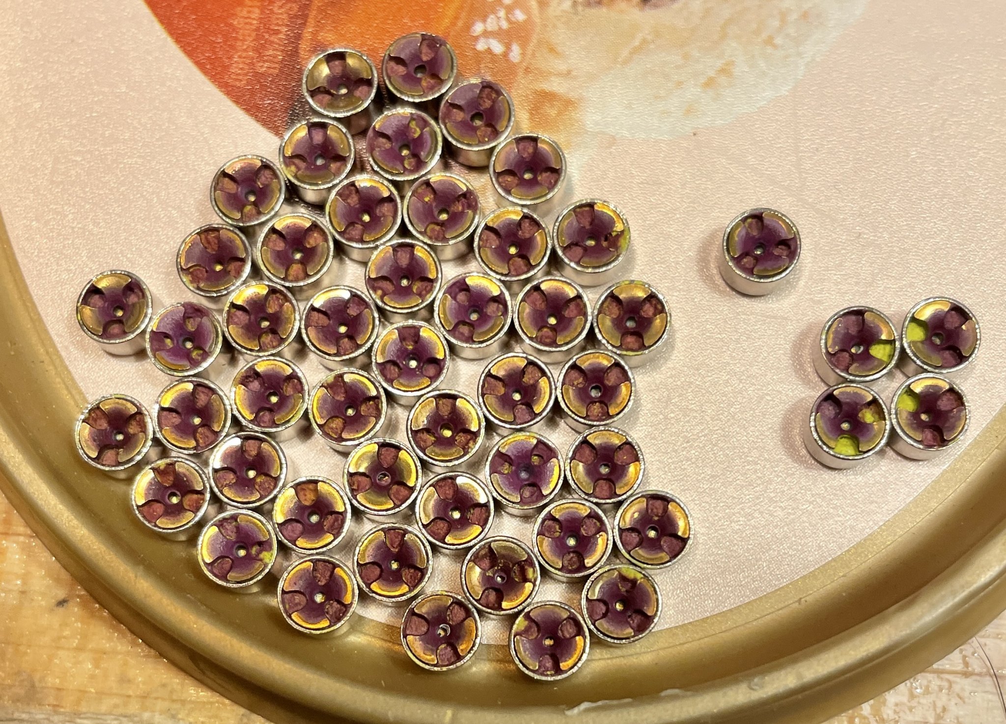

    Inside flash hole. I found raw VS deburred had a huge influence on ES/SD. Lapua doesnt have much at all (drilled flash holes) and have not tried peterson, but hear its excellent.
    The usual suspects are hornady, winchester, federal, S&B, norma to some extent, starline, etc..

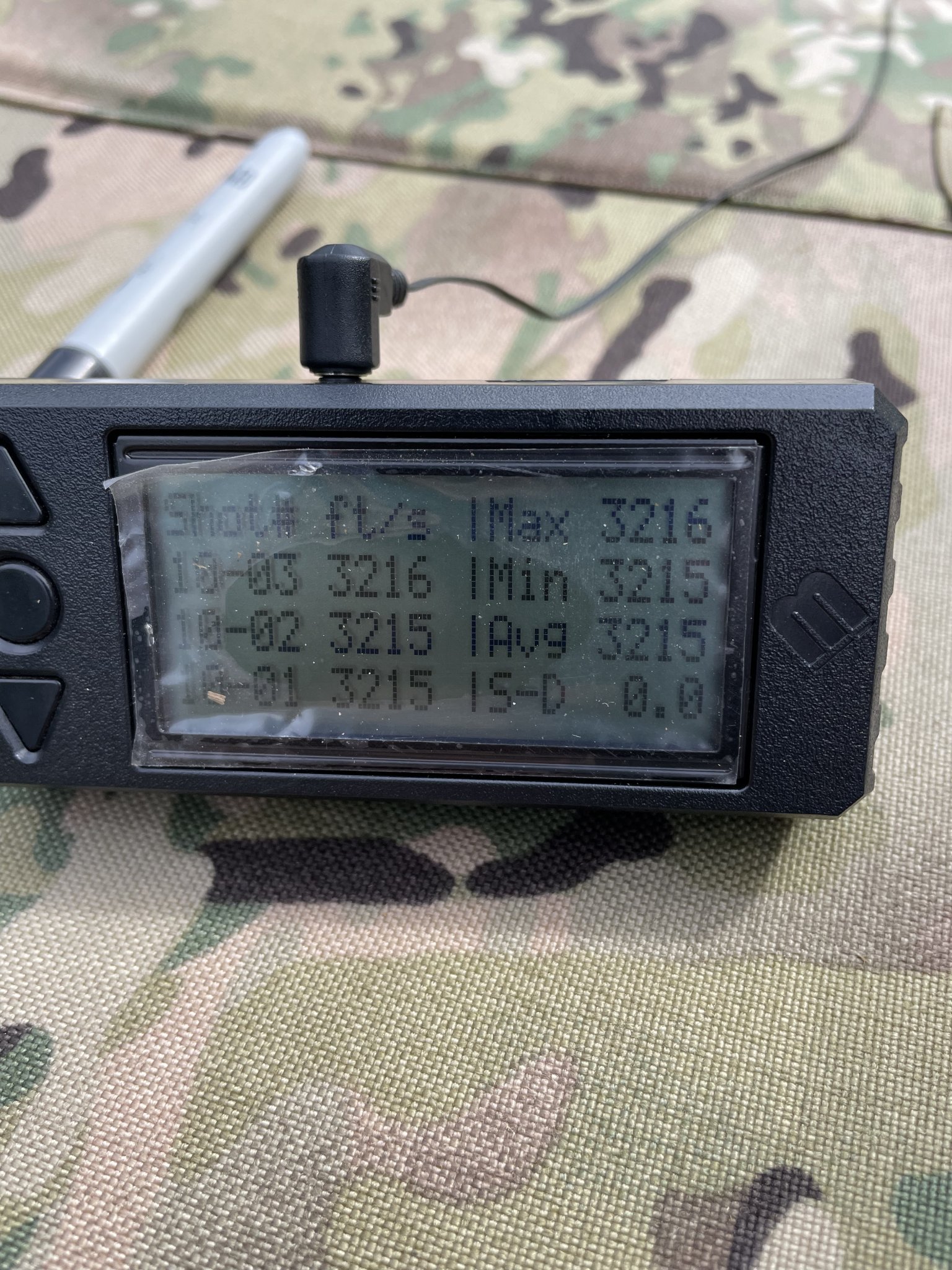

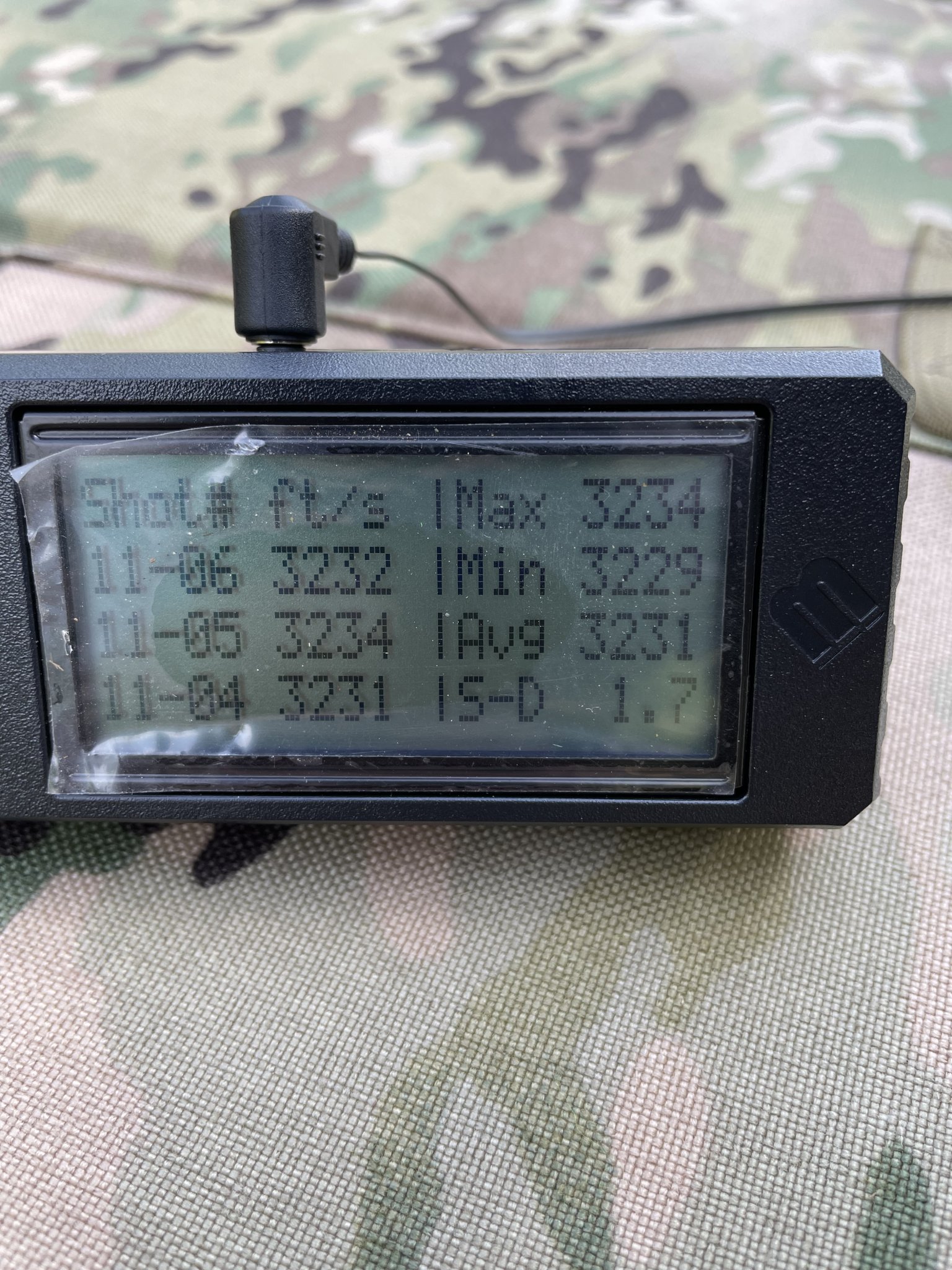

    I will add that I proved to myself also that how you actually shoot believe it or not matters a lot. For example if you shoot one shot with your shoulder pressed firmly into the stock and the next shot you allow more movement of the rifle... it definitely has an effect.
    Your question doesn't really have one answer as many factors affect velocity and any one may have the greatest effect. If you look at the entire process you have many things going on that interact. First is ignition and combustion. The primers needs to be consistent and the powder column needs to be consistent at the time of ignition. In some cases the powder will burn differently if charge shape is different. This is likely to happen if the case is not close to full. Because the burn rate is a function of pressure the point on the pressure curve where the bullet releases is important so neck tension is going to affect the burn rate and peak pressure and ultimate velocity. Different case sizing between charges will affect the energy absorbed in expanding the brass hence different energy available to the bullet. Obviously charge uniformity is important but if you consider a 0.1 gr variation in 223 that is on the order of 12 fps but in a 308 it is about 6 fps and in a 30-378 Weatherby its 3 fps.
    The bottom line is having a realistic exception for SD for your needs, pay attention to the your loading and strive to maintain consistency. There is also one overriding thing to remember, SD and ES are test numbers and while they have importance the goal is bullet on target. Don't lose track of that fact.
    Lapua does not have drilled flash holes. The worst flash hole burs I have seen were actually in some gold box 243 brass.

    So is this red layer actually a sealant that has no effect. This is 50 primers out of the brick I’m currently using. You can see how the 4 at the lower left are only partially filled. The previous brick was much worse, probably 15% were that way. I’ve been sorting them by fill and would like to skip that step if it’s not important.
    Edit: … 4 at the lower right ….
    Reactions: Jefe's Dope
    I wouldn’t worry about sorting primers. Personally I think uniforming pockets and a consistent seating depth or anvil crush is more important…
    Don’t be the guy that sorts primers by measuring and weight sorting primers 😉
    It's not sealant, it's just dye to mark them. It looks like they are all filled about the same to me.
    Some on here have done extensive primer testing. I have only tested a few and only to see if it effected my speed and POI between Winchester and CCI. There was no difference in what I tested.
