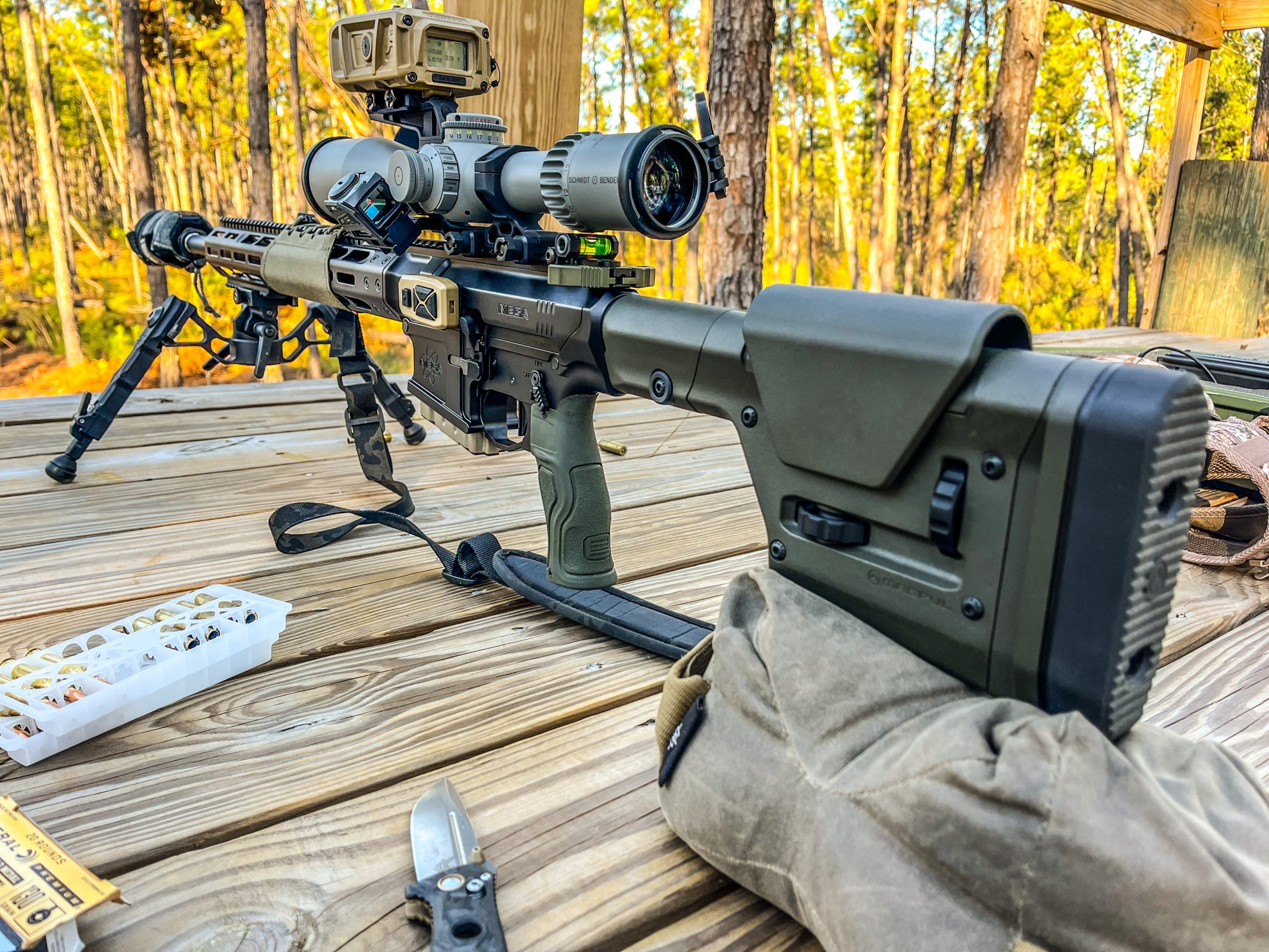

I like my Gibbz.
Try Diamondback.

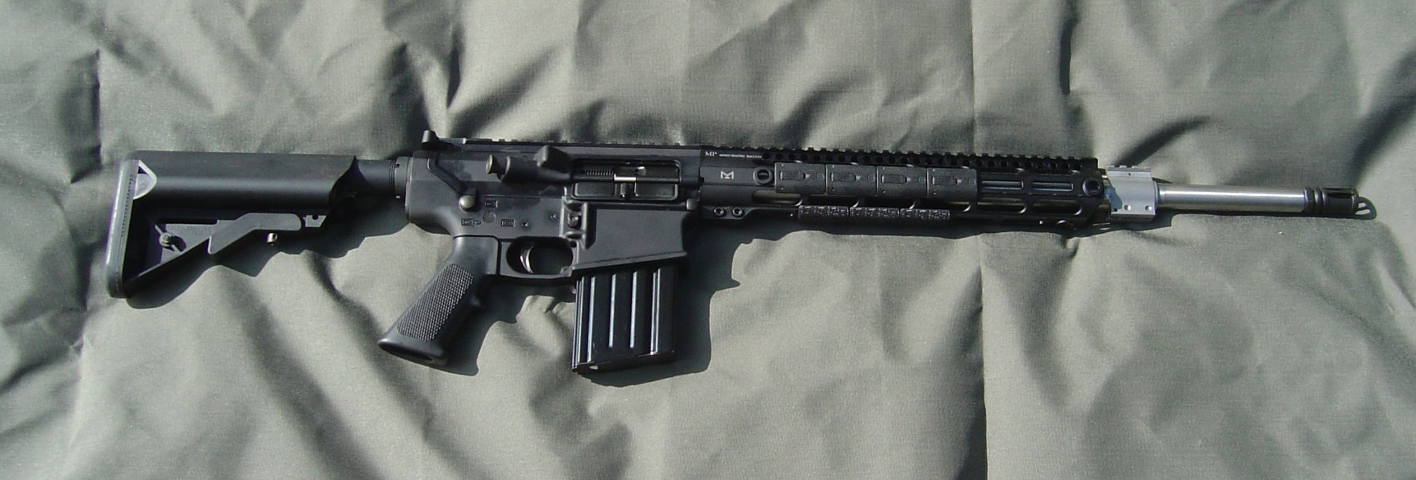

Finished gun:

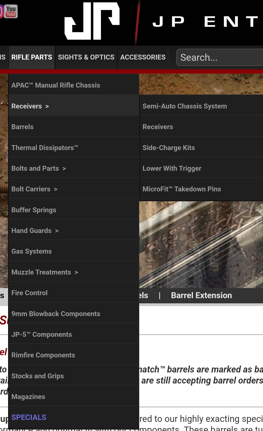

I appreciate your input. I'm really leaning into JP, but I might also pick up a Zev or Nemo while I'm at it. Which ever one I go with, I plan on using handguards from them too. Radian doesn't make large frame rifles, not yet at least.
