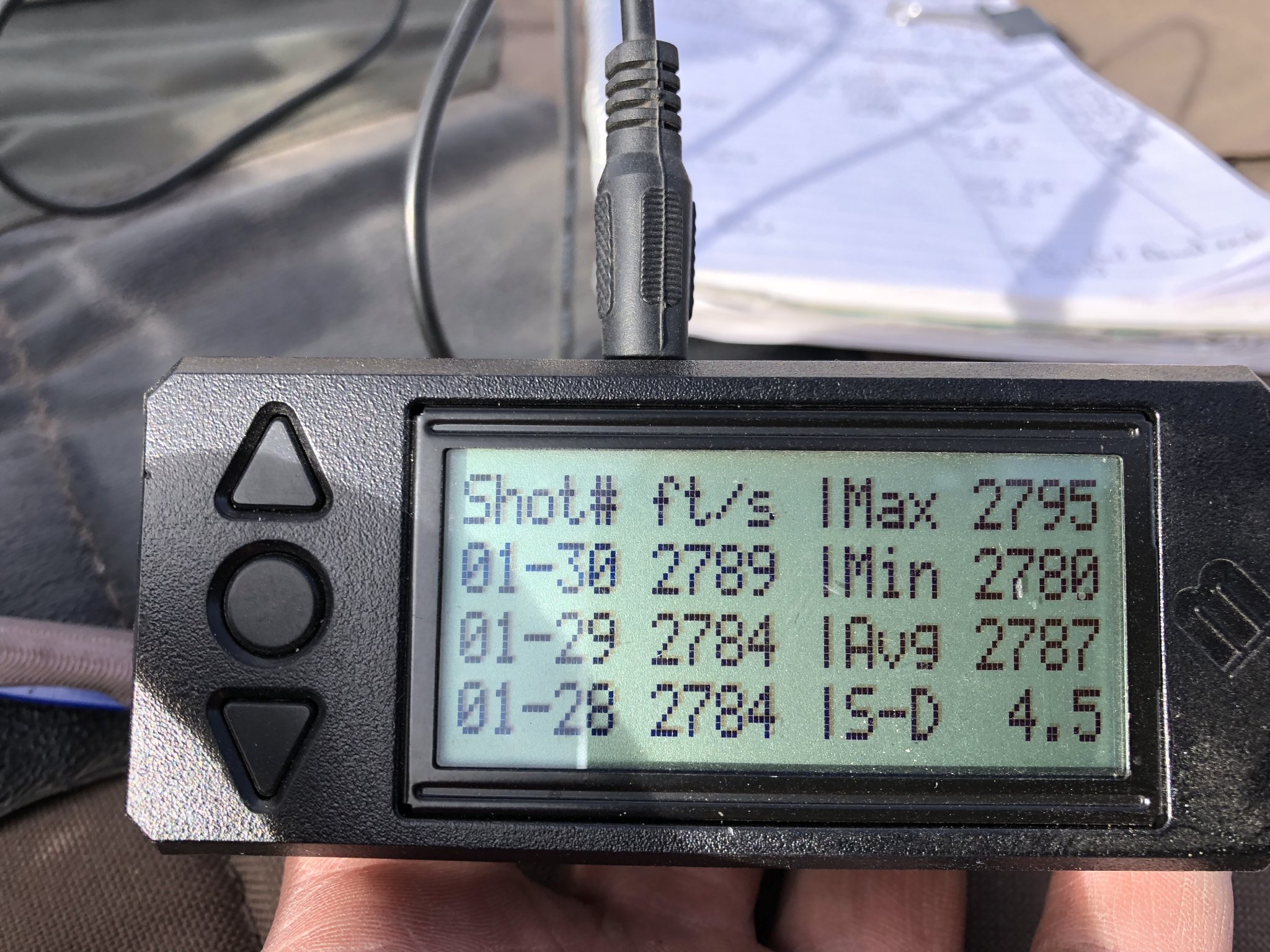

if you take a large sample its very hard to have numbers in the single digits...ive had several 5 shot groups with 0 to 1FPS ESs and 0 SDs but once you start taking larger samples that all changes....if your in the low doubles for ESs your good.
This was 30 rounds yesterday....the first 5 had a 5FPS ES....
Reactions: LA260
