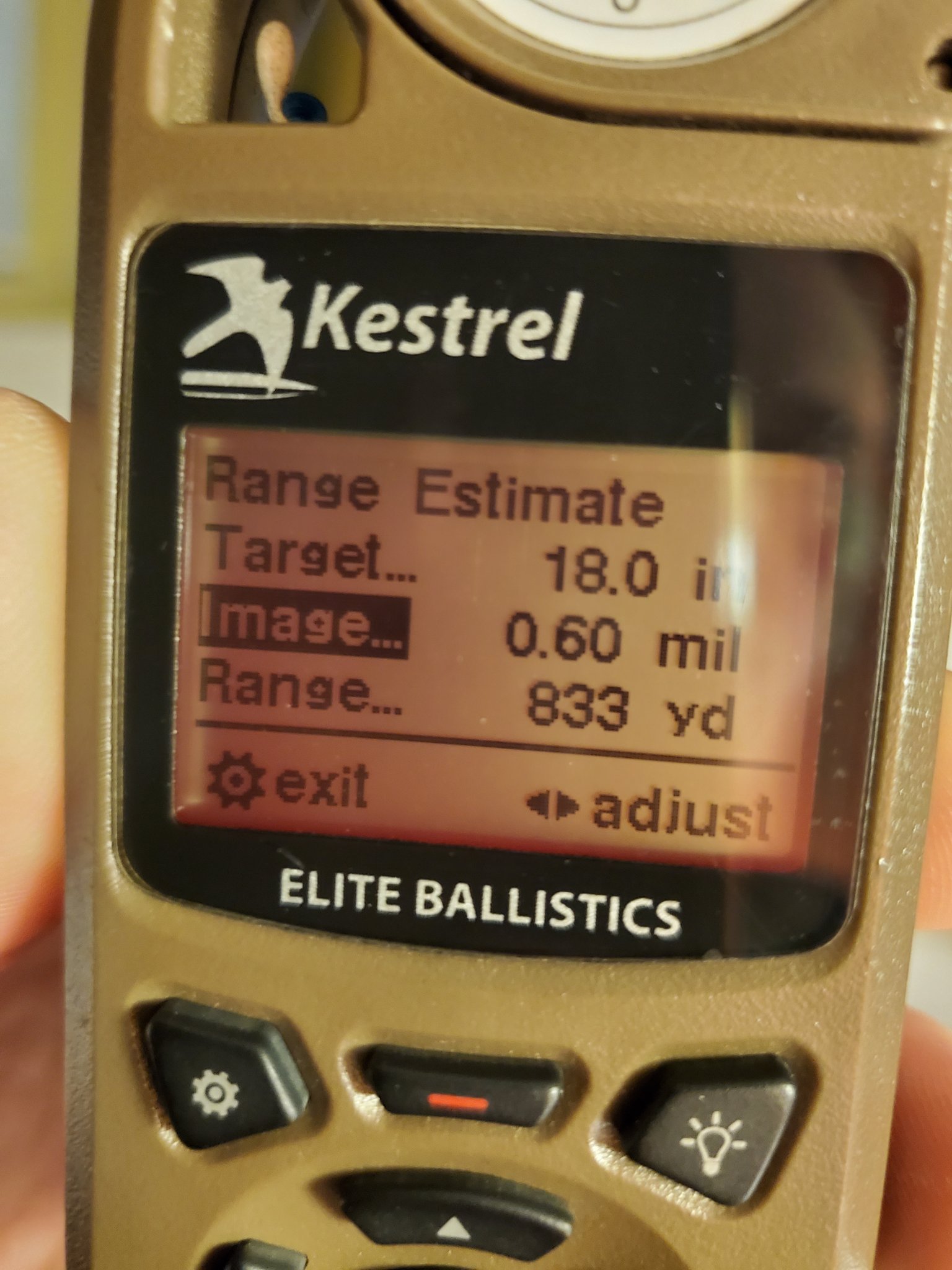

The one I shot last year at Karstetter was blind. You were given the target size and that's it.
I came up with my own strategy. The Kestrel has a range estimation feature buried in it where you measure the target with your reticle and input the amount of mils the target spans and it gives you the range.
I had a drop chart in my wrist coach already once I had the range.
So I went prone, found/measured the target with reticle, inputted that measurement into the kestrel, took the range it gave me and consulted my drop chart on my wrist coach, dialed and shot.
There were four targets at four ranges and I managed 7/8 hits and was super pumped with that result.
So the formula was simple, target size was 18". 18" target measured .6 mils which the kestrel gave a range of 833 yards. My 850 yard dope (off my chart) was 5.9 so I dialed 5.7 and sent it.
There were four targets ranging from 400-900 yards.
I saw alot of guys using different interesting methods. From using mildot masters to T3 reticles. I found my method expedient and accurate.
