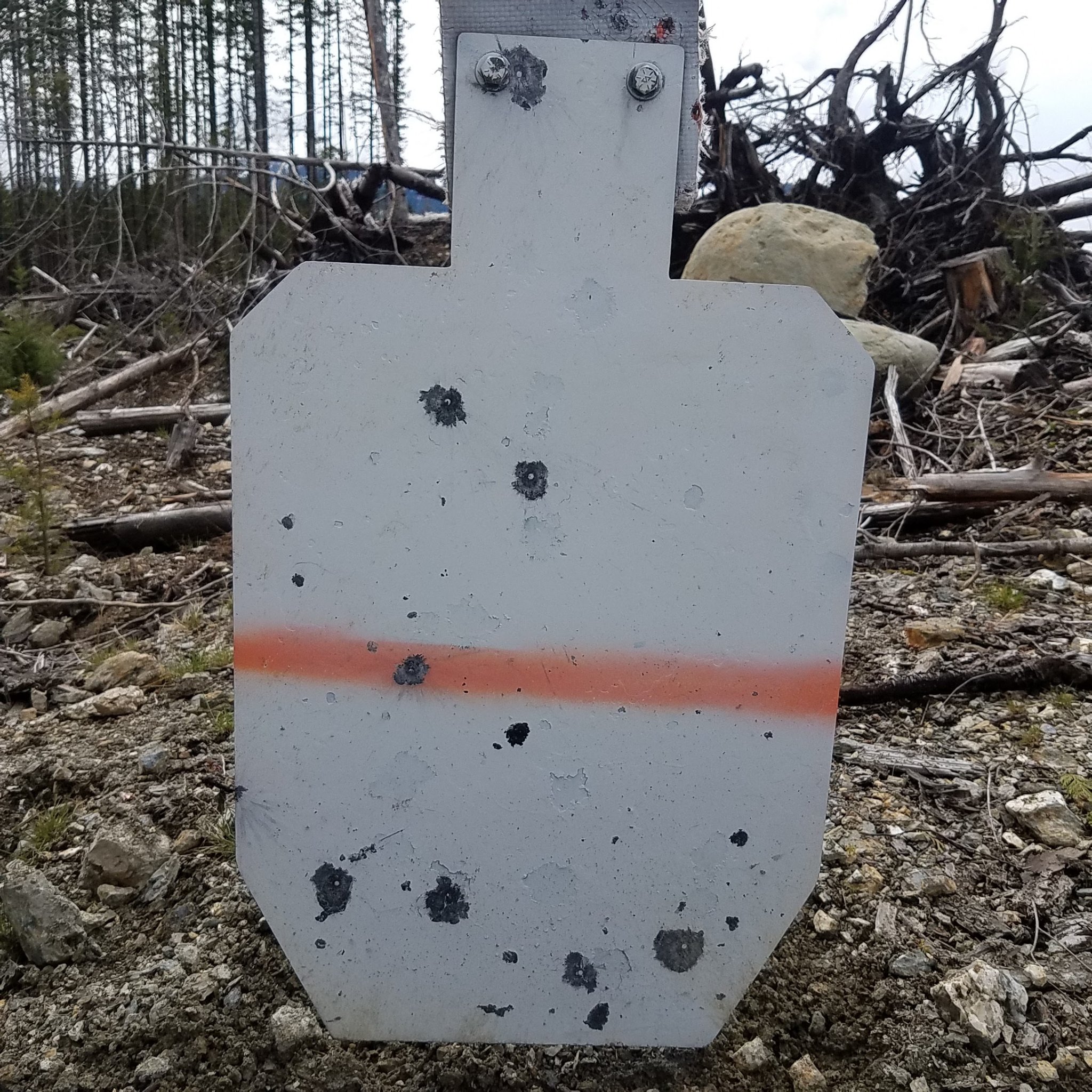

Here is a 10 shot group at a mile that I shot with a 300 Norma.
1 mile is where the going gets tough, real tough. Hitting that target depends on all the usual factors magnified by the range. A great group is 1 MOA - absolutely outstanding at that range - so about 18 inches, but how many shots? the more the merrier LOL. Wind is the critical factor. And repeatability. And variability. Good luck!

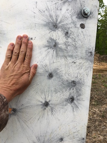

Was that directed at me, since I am the only person that said they had shot a 10" group? I can assure you this was not the case. It was at a LRSU milk jug challenge a couple years ago. Plenty of witnesses. It was 3 consecutive shots. I have the backer.
