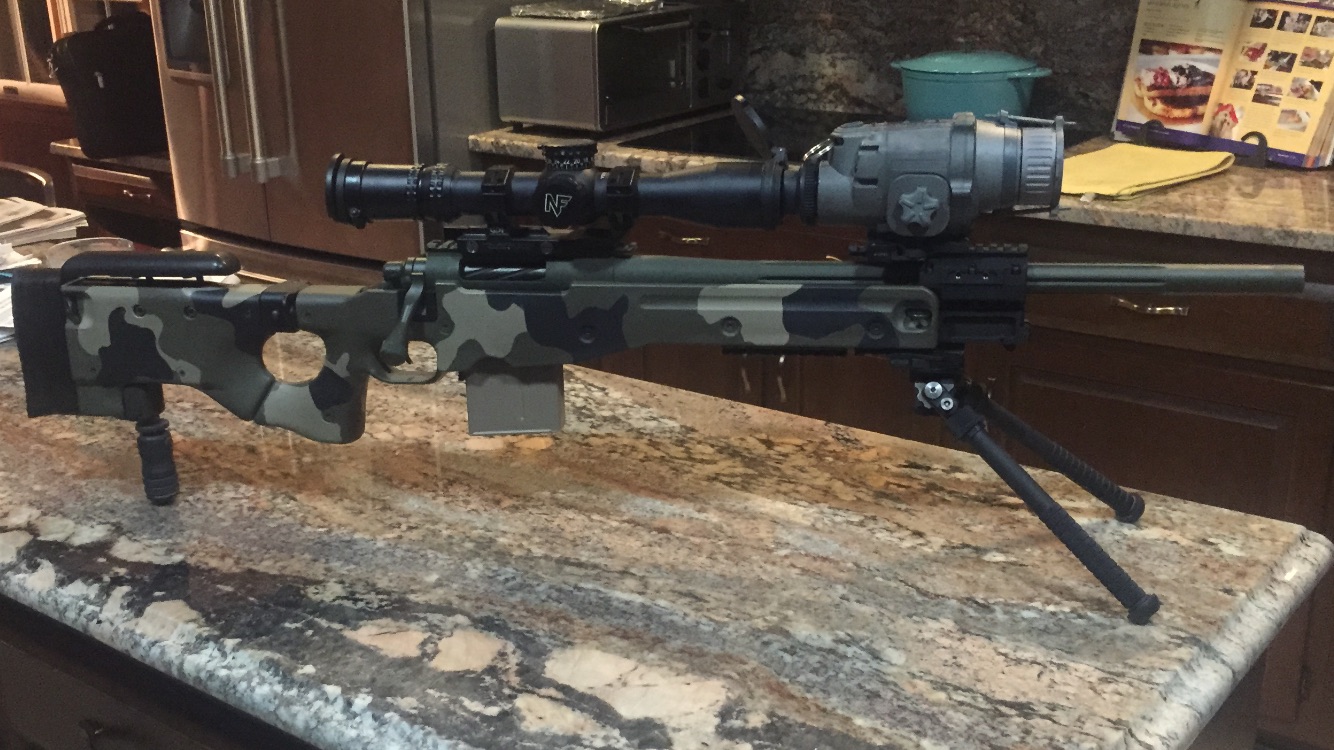

A little baffled at what the culprit is in my setup. I have a 6.5 CM build by GAP and I just received my Thunderbeast Ultra 9 6.5. Shot a 3 round group at 100yds without the can to compare POI shifts. Put the can on, check for obstructions and everything lines up great according to my eye. Shoot a 5 round group and my POI shit is 7-12" left and 4" high at 100 yds! No baffle strikes, brake and can are not loose, no copper streaks on the end cap. I am completely lost as to who the culprit is. Thoughts?

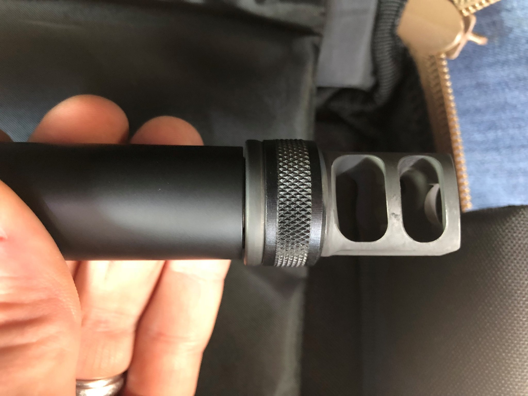

GAP thinks it's the can, have to pay for shipping if it ends up not being the rifle.

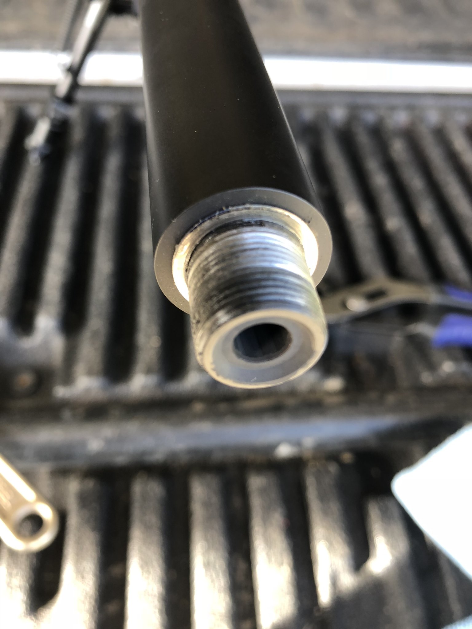

Thunderbeast thinks it's more then likely the threads on the barrel. They want to look at the barreled action and the can to make a conclusion. Have to pay for shipping for that also. I'm not sure who I should send my stuff too.
Peel washer for the CB Brake?
There is some sort of washer it looks like. GAP installed the brake.
This is at 100 yds.. POA was the 7 on the right. The hit was without the can and the other 6 shots were with the can on. Ignore the taped holes.
Also I just got home and took a hard look down the barrel. The can is slightly overhanging the bore from 3 o’clock to 6. Should I just send the can or send TBAC the barreled action also?

I'm willing to bet the rifle isn't threaded concentric or all that extra stuff on the threads is causing problems. Even if the round does not strike the suppressor it can be affected. The easiest thing to try would be too remove the brake and washers and clean the threads up. I'd then screw the brake on without worrying about timing it (i.e. no washers just butt the brake snug up against the shoulder) and then attach the suppressor. Double check down the bore to make sure you wont get a baffle strike, then go shoot.
Also, I'd try that suppressor on a different rifle if you have access to one. That should point out the problem right, quick and in a hurry.

Before you flip shit you should investigate a little more. TBAC called me and asked me to take the brake off and inspect the threads and washer (see post #26).

The threads either aren't concentric or there was something on the threads or between the brake and the thread shoulder that caused the can to be not perfectly aligned. There is a tiny chance there is a defect in the suppressor or the muzzle device, but pretty unlikely.

FWIW you can get 36" precision ground soft tool steel rods in various diameters +/- 0.0005 shipped directly to your door from McmasterCarr. A precision ground 36" 0.246" diameter rod is $6 + shipping ($10 or so, might as well grab a whole gamut of sizes for your other caliber rifles) a great addition to your kit for verifying the integrity of your barrel and suppressor interface.
I run the appropriate diameter rod down the barrel after attaching the brake/mounting device and suppressor just to verify. Run the rod all the way to the closed bolt face, it will be laying in the barrel and will easily indicate if you're clearing the suppressor baffles and endcap.
Well took the rifle to the range with the newly installed brake and guess what.. The rifle now groups less then 1" below with the can on. So the excessive thread lock and distorted washers were the culprit. If anyone has George's email I would love to message him and let him know my experience.

I'm not sure I understand how you mounted the can with the brake that was installed. If it was a direct thread then the brake would have had to come off first, but that wasn't stated. I also don't see a way for a can to attach to that brake so how was it mounted?
You also mention a newly installed brake so what was different about your install?
It mounts on that lovely tb cb brake... (the threads are under the knurled thread protector)
