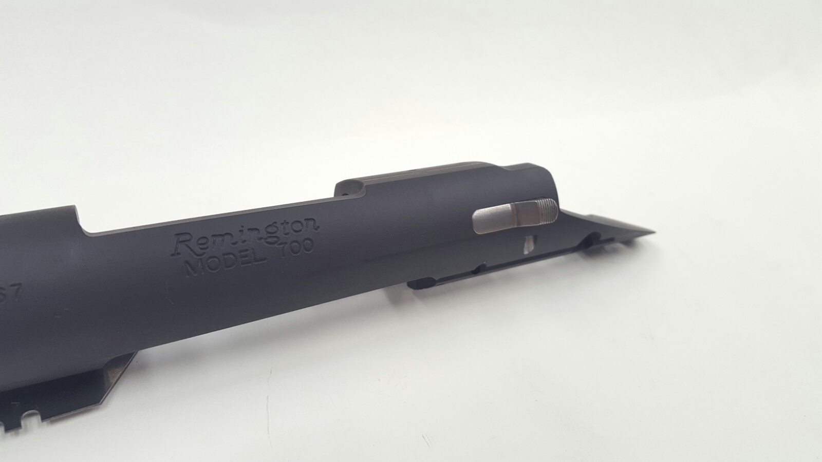

Yes the Remington can be modified to have a side bolt stop....

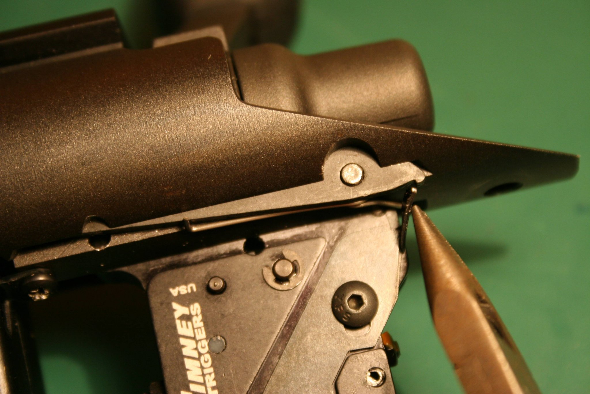

Factory bolt stop, button on the bottom of the trigger pushes the side slide which actuated the lever.
Side bolt stop installed to eliminate the trigger mounted lever, just push on that side button.

You’ll have to reach in beside the bolt and move the bolt stop out of the way...a toothpick is long enough to accomplish this...when you want to remove the bolt.
Never thought of a toothpick. Always used a very smal flat screwdriver to release the bolt on our XP-100’s. Works but as been said, it is a PITA as it really takes three hands.
