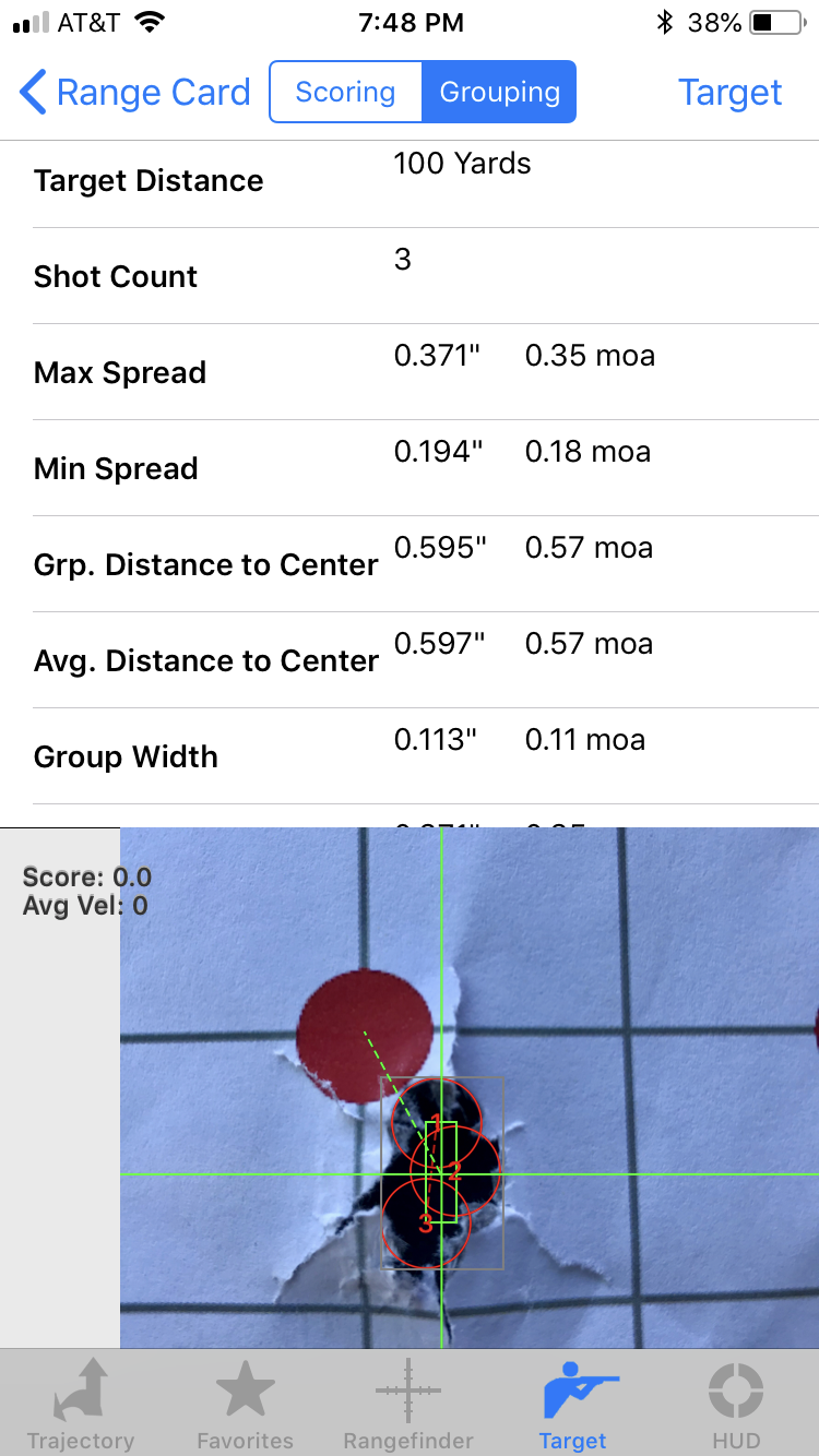

below is a group with my hand loaded 300 berger otm ammo. Typically performed a ragged hole at 100 and touching at 200.
Reactions: lash
