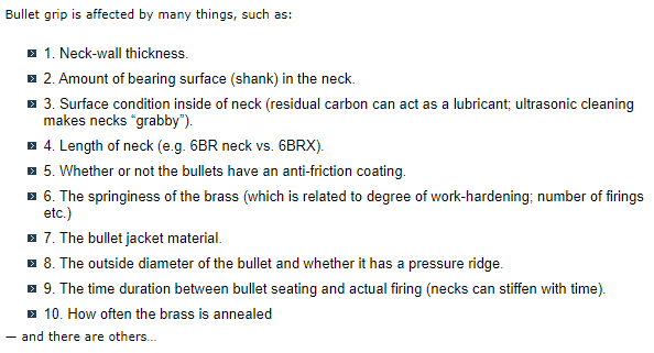

You didnt want links but you should read this link
All of that makes up bullet grip and its really really hard to measure outside of a lab. Numbers 6 and 9 are particularly hard to quantify your control of for consistency.
All of that makes up bullet grip and its really really hard to measure the actual bullet grip outside of a lab.

Very detailed explanation and informative references!
Towards the end of your posting you referenced tension amounts (.004", .002", .001") and associated the .001" tension with a Benchrest shooter.
Do you think that lighter tension inherently produces more accurate ammunition? Just asking your opinion or thoughts on this.
Don't go overboard as I know this subject can get really drawn out.
