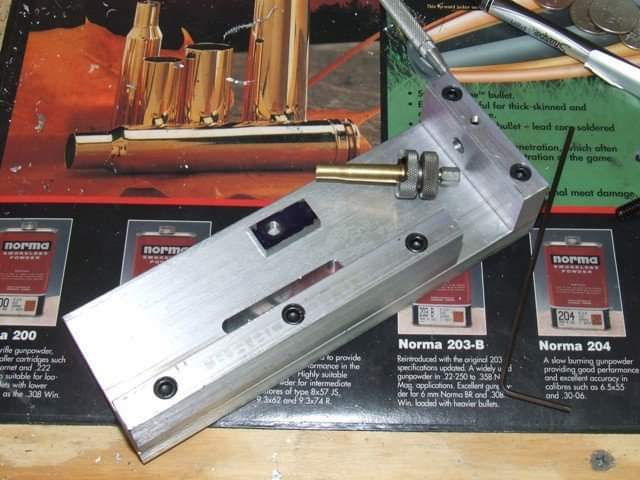

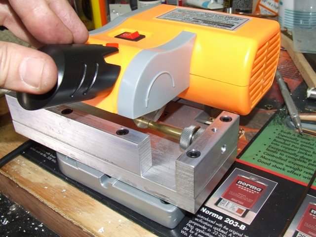

I use the HF chop saw and built a jig using a cut off 223 brass. Work good.
Yeah, I built one too, about 20 years ago, when the 300 Whisper was popular and no one had even heard of a 300BO.
