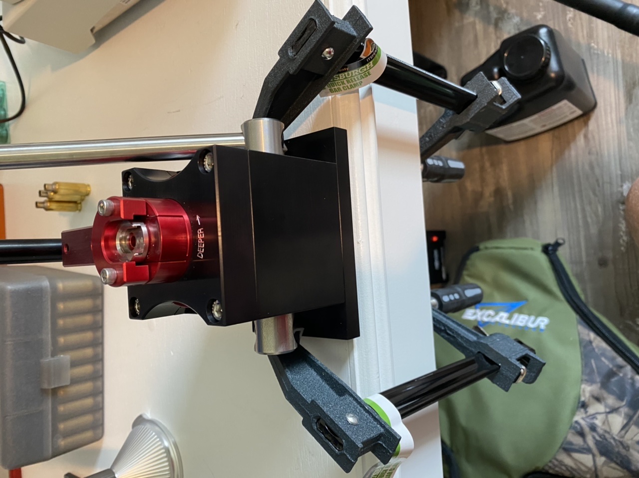

How I set mine up. Keeping it clamp mounted for now. Ive been traveling for work as much as ever recently, driving instead of flying with all the covid mess. Sucks, but at least I can travel with reloading stuff now. These clamps look to be long and deep enough to mount on pretty much any hotel room desk.
