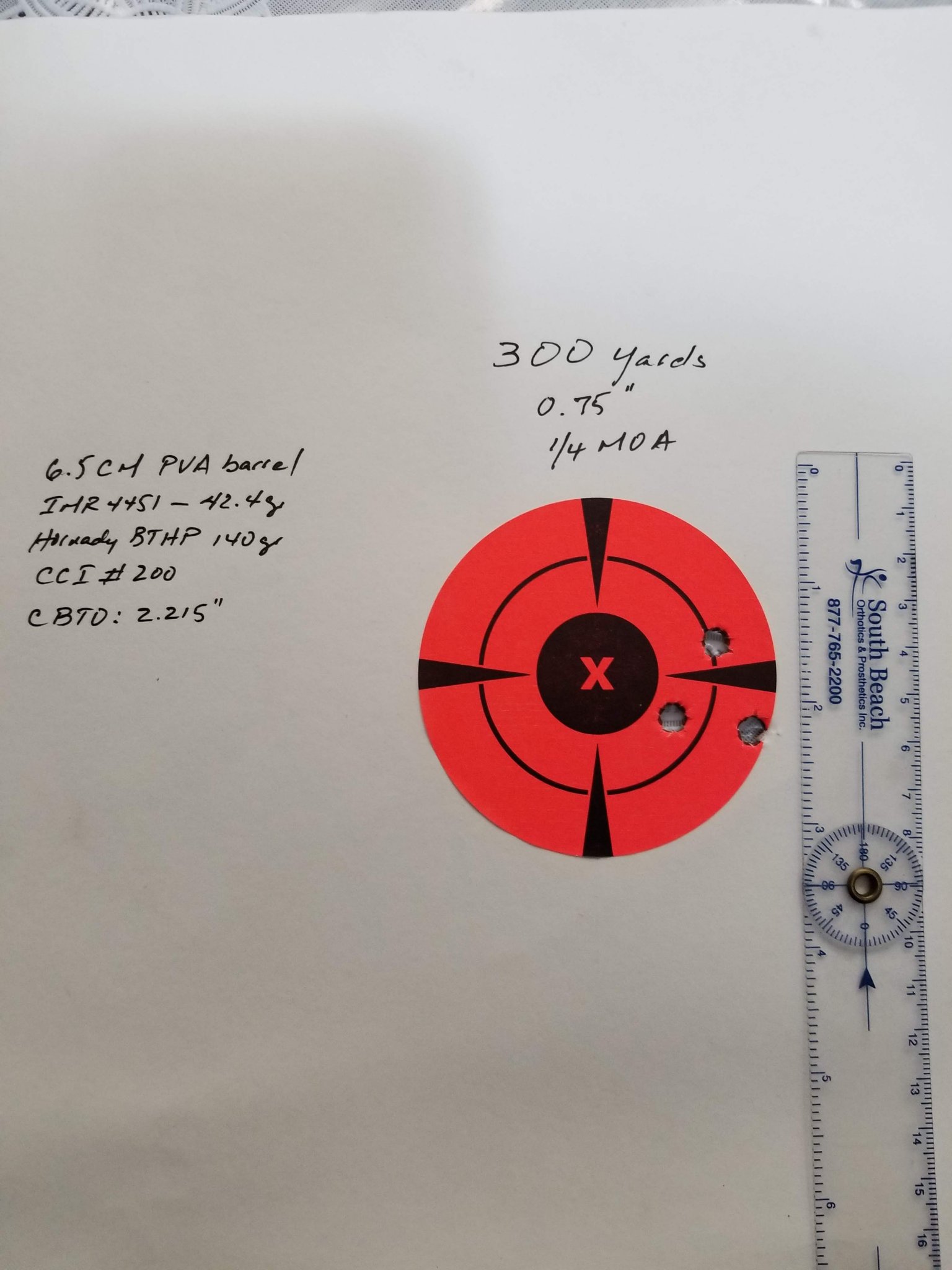

Here are my numbers on a 6.5 CM.
Hornady Match BTHP 140 gr, 42.4 gr of IMR 4451, CCI #200, Hornady brass
Tikka CTR 24" - 2715 fps
Tikka PVA Rock Creek 26" - 2835 fps

How does the PVA shoot accuracy-wise and velocity-wise?
Awesome barrel. Fast, very easy to clean. 3 shots group at 300 yards this Saturday. 1/4 MOA. I can't complain.
