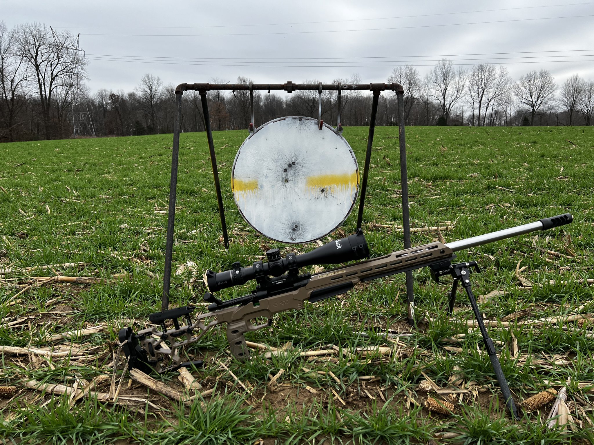

    I take a full sized IPSC and either paint a crisp, horizontal line in the middle, or put a piece of thin, blue painters tape in the middle.
    Then I put it out at 125 yards, dial, fire ten shots, and confirm where I'm hitting above or below the line. Then I do the same at 175, and on out to 250 yards. Keep a record of how this diverges from your solver, and you will have your corrections and trued dope.

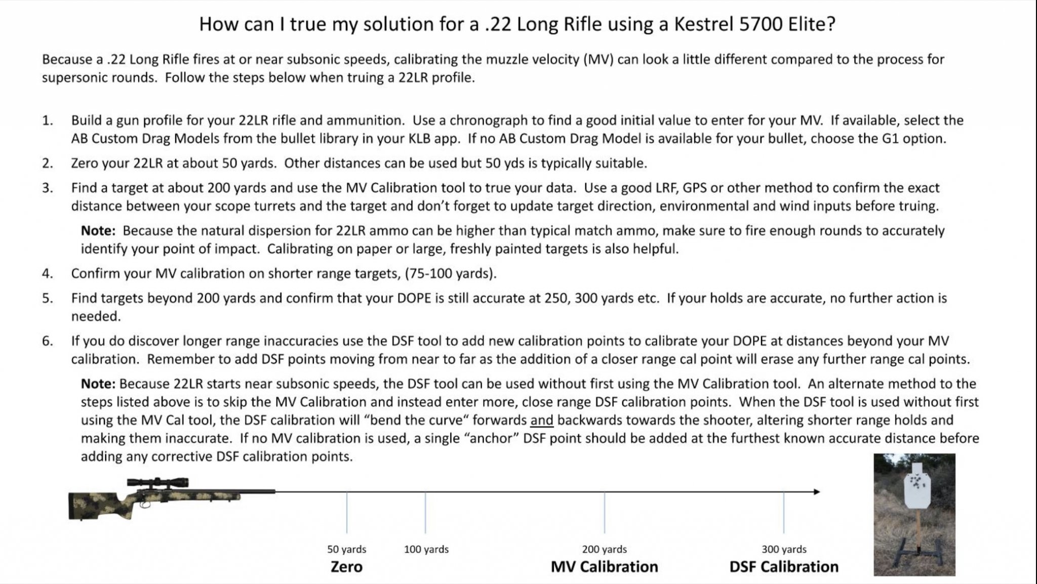

    Assuming you have correct Velocity, Zero Distance, Scope Height over Bore and ammo BC as close as possible this is what I do as well as others in my area.
    50y Zero. target w/ water mark at 100 and verify that dial (1.75 @ 88* is mine ). I will dial 1.8 and verify its about 1 bullet width high. If its not adjust the Cal DSF in the kestrel from Near to Far w/ 6 inputs max. Next yardage is 150. Since and repeat. I will do this out to 400 if possible. It has worked well for me. I have done this with 1 profile from 250 IN & second profile from 250 OUT and that works just as well. There are enough drag models in Applied Ballistics to get you REAL Close on BC in the beginning they there is no need to tweak it.
    A couple of guys around me verify zero as above at 50y then go straight to 200 and do a Muzzle Velocity Calibration ( Cal MV ). Adjust MV until it gives you the proper solution at 200y and verify it at 25y increments from there into 25y. Then from 200 and beyond is back to a Cal DSF as above.
    Just remember large target and waterline painted on it. Example picture is of my CF at 1080y.

    I’ve used this process with good results on several solvers and 22 rifles. relatively quick and easy
    Turn off Spindrift and Coriolis if it’s an option.
    zero @50
    Waterline at 100 yards, adjust muzzle velocity to true actual results with solver
    waterline at 200 yards, adjust BC to true actual results with solver.
