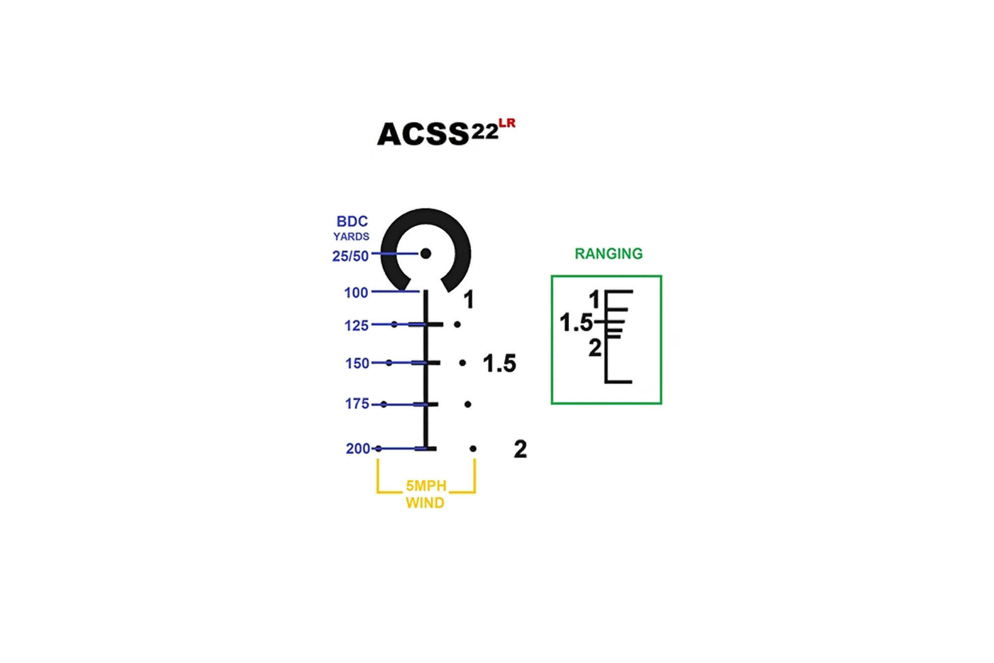

Using a 10/22 Tactical 16.5" tapered barrel, w/ Primary Arms ACSS 22LR 6x on a Hammers 1 inch Low Height scope rings and some aftermarket picatinny base that's the same height as the stock Ruger one. Ammo used was CCI Standard loaded one by one into the chamber.
Was able to get consistent shots out to 300 yards once I found my hold, but ran out of elevation for a center dial at 200. At 100 I had about 19.5 - 20 moa left. I can get away with my rings for a little longer, but suggestions are appreciate too. What MOA base would I need if I want to still be able to dial in at 50 on the end of my negative elevation so I have a lot of room for positive elevation? PA 6x has 50MOA of total elevation adjustment. Seems like a 30 or 40 MOA base may be the trick.
Edit: Forgot to mention my local range goes up to 600 yards. I'm itching to stretch out to 400 and 500. So far I'm getting real good at wind calls.

That scope is not intended to be dialed other than zero. And its zero is set for 25/50, hence the ballistic drop reticle calibrated to .22lr. And what .22lr ammo? Subsonic? Hot? Likely averaged for all ammo. If you attempt to dial the scope for distance, your center reticle may be correct but the rest will not be accurate for bullet drop. I also have the same scope for use on my 10/22.
With that, you need a scope with a reticle that is not bullet drop calibrated in either MIL or MOA and is designed to be dialed for distance. Althon has many great scopes in price ranges from cheap to sort of expensive. And you'll likely need a 50-60 MOA base to dial to 600 yards, depending on the overall travel of the particular scope you use.

I don't really use the bullet drop all that much, maybe for higher velocity like minimag, but otherwise I use the 200 bdc mainly for wind holds at 200 and 300 which works very nicely. I estimated the MOA from the 200 mark to the center dot is about 20ish MOA as well.
