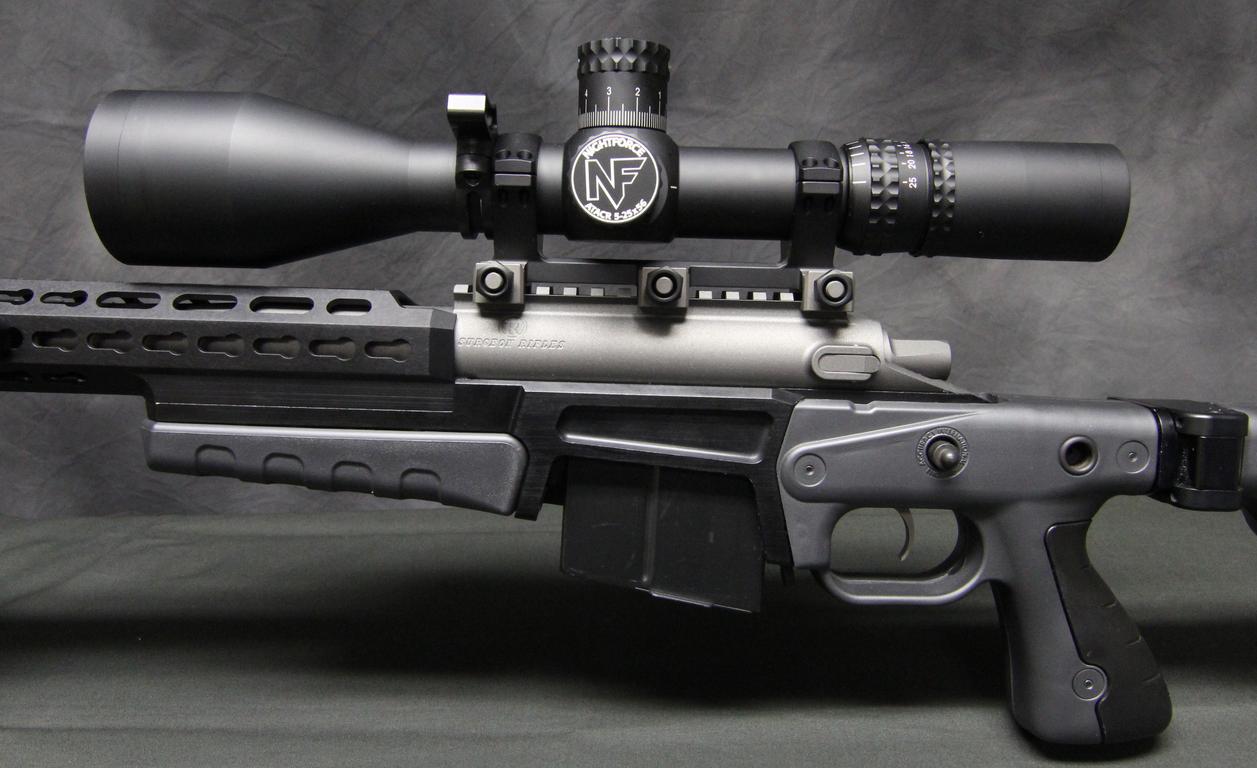

    I have an AX coming and I would like to get some advice on optic mounting options. The scope I'm going to be using is a S&B 5-25. I would like to keep the scope as low as possible but still have enough room for butler creeks.
    Any suggestions on the best ring/mount height?

    Take a look at the Nightforce MagMount (A162) - it is 1.44" high and has 0moa of taper with 3 clamping jaws
    Nightforce 34mm Magmount
