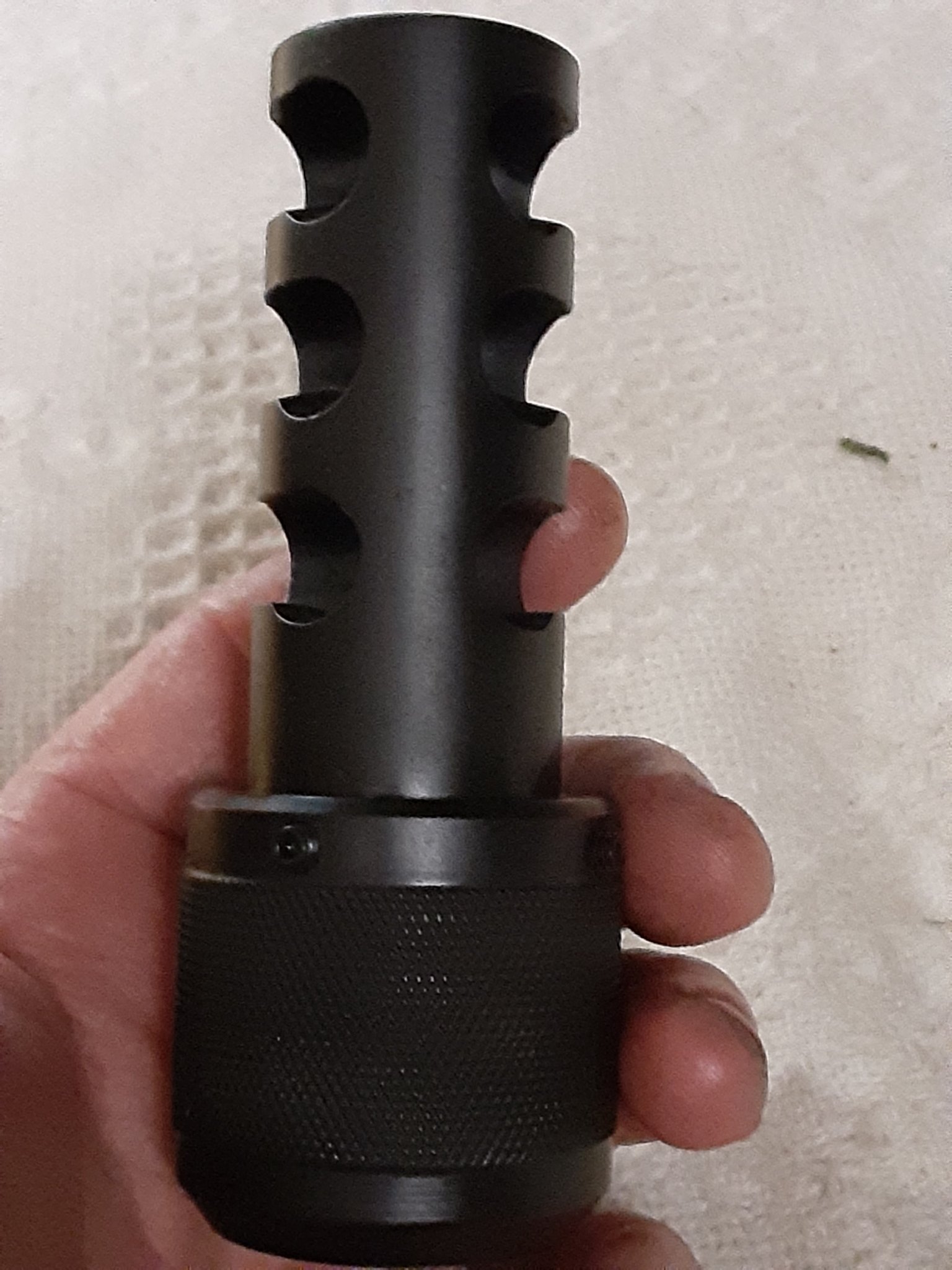

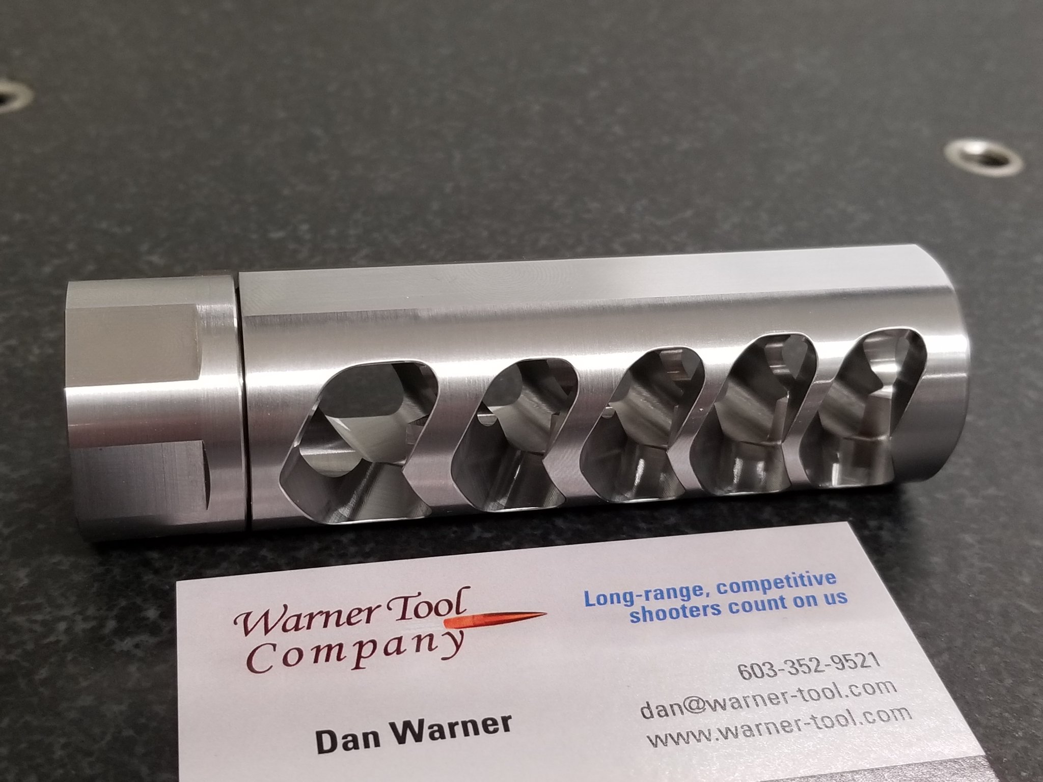

Could use some hash marks like a micrometer.if your looking for reduction in recoil canceled blast and reduced muzzle jump with tune accuracy look no further its View attachment 7312930View attachment 7312931in production the first and only one piece tuner brake designed for elr
Production modle does this was just a prototype. I also opted for larger ports and less to keep the unit shorter shorter brakes are prover to be more accurate . And opted to use a progressive restriction pass threw keeping area in front of crown larger to eliminate carbon buildup of crown . Let me know if your intrested in one .Could use some hash marks like a micrometer.

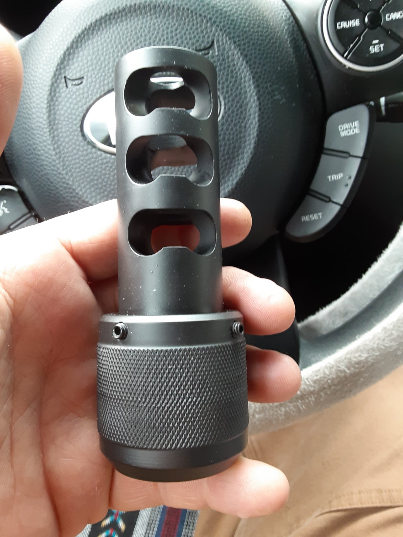

There is a general miss perception that the amount of ports has something to do with reduces recoil. 80% of the rediction of recoil happens in the first 2 ports unless the primary ports are restrictive any thing past the first 3 ports are waste of space. The added benefit of being able to tune in accuracy at high node low s.d vrs having to down load to a lower velocity node is the added benifit of a tuner overlooked by the elr community . Low sd's does not always equate best accuracy only vertical. I am sure I am not telling you something you dont alread know but perhaps have not thought about.I’m interested. Just curious if it will reduce recoil as much or better than the one I have. Be nice to see a sled test like the beast brakes do.
And you have a tuner to go with itMOAB. Directs blast away from and around the shooter. Doesn't pick up and cover the gun or shooter with ground debris. Recoil reduction is maximised and bullet flight is undisturbed. And it is 'self timing'.
I am aware thanks. I’ve asked about having a tuner made for my 375 since it’s not being suppressed for now, and have yet to have a taker. Should have just made one myself. Don’t take this as me assuming yours doesn’t work well, but most everyone says theirs is great and some are better than others. That’s why I like the sled testing. It’s a direct comparison; whether accurate to the shoulder or not, I’m not sure.There is a general miss perception that the amount of ports has something to do with reduces recoil. 80% of the rediction of recoil happens in the first 2 ports unless the primary ports are restrictive any thing past the first 3 ports are waste of space. The added benefit of being able to tune in accuracy at high node low s.d vrs having to down load to a lower velocity node is the added benifit of a tuner overlooked by the elr community . Low sd's does not always equate best accuracy only vertical. I am sure I am not telling you something you dont alread know but perhaps have not thought about.
If you were ever to use one of my exnihilo 4 port tuner brakes you would never use another t5 again plus mine is made here in the USA .I run the T5 on my 375ct and have no trouble see my shots. At matches I have shoot 50 rounds in 4hrs or so with no issues.
