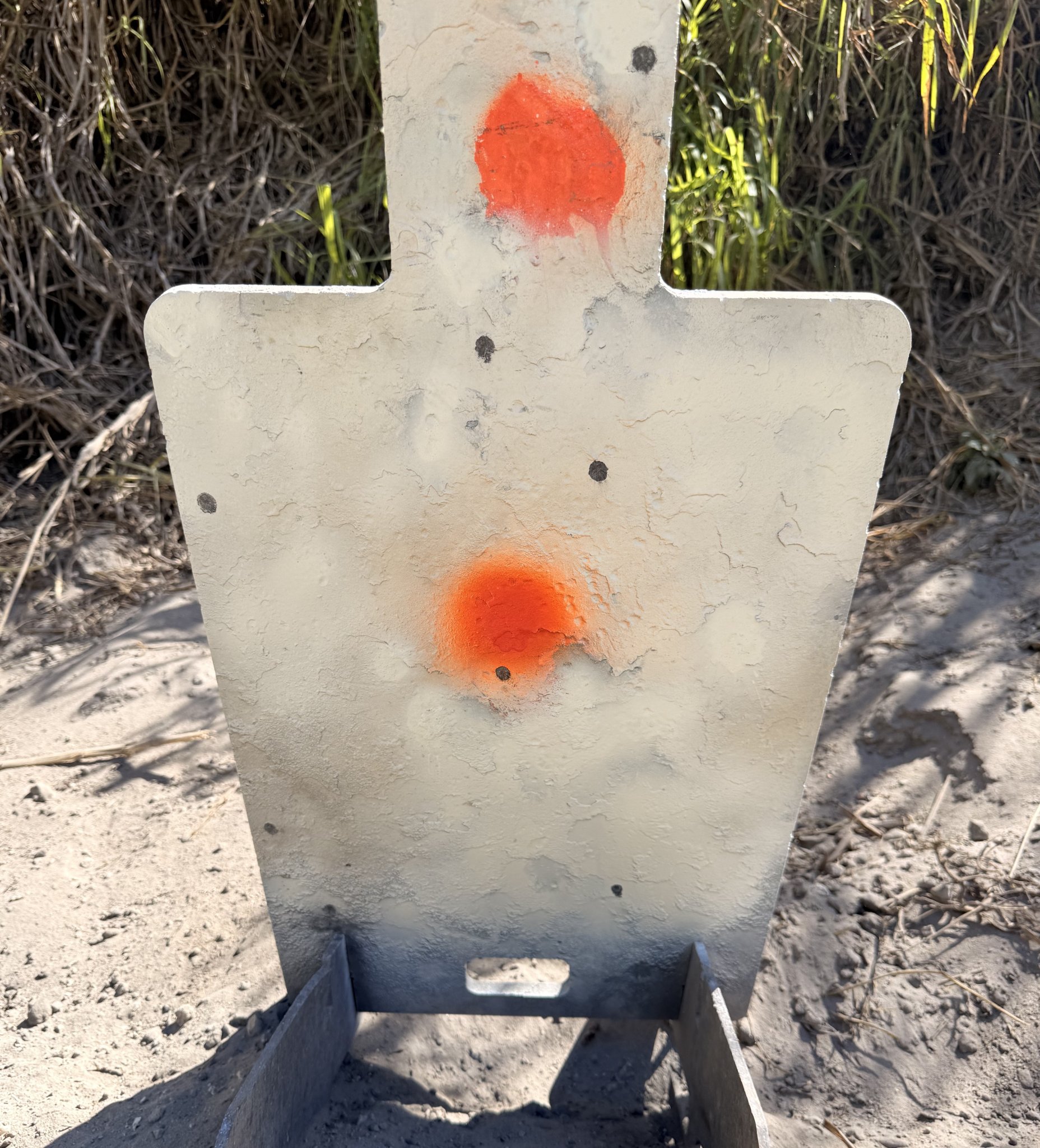

You shoot your .22 at 500 yards???
I do,
Here is the plate from last weekend. It was 512 yards and I dialed 25 mils on the Kahles and still had to hold over an additional 3.5 mils. I shoot Lapua center-x from a Vudoo.
