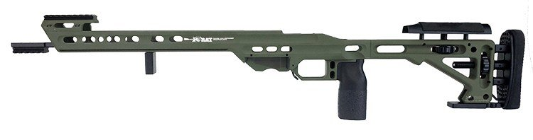

Change of plans: KRG doesn't do a 457 chassis. So just ordered this:
7101864
Oh.... and sent my action to Lilja 4A barrel.
