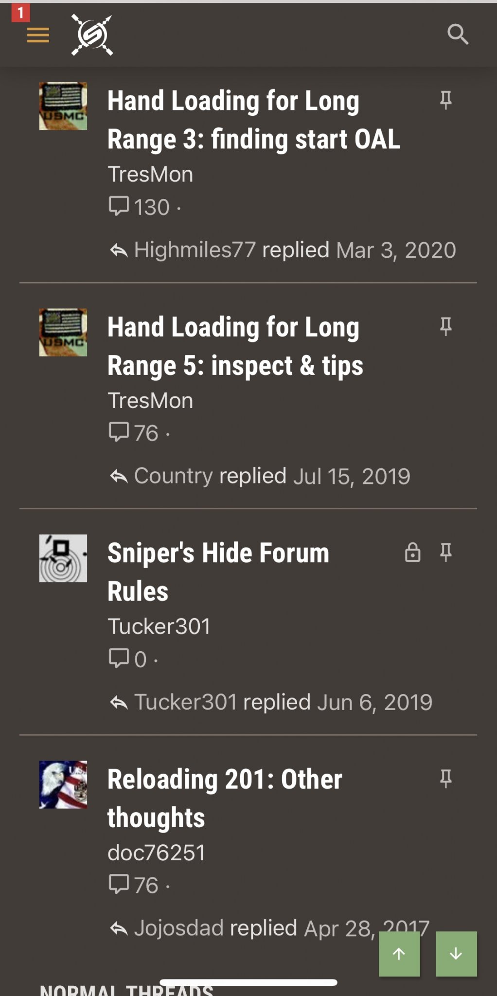

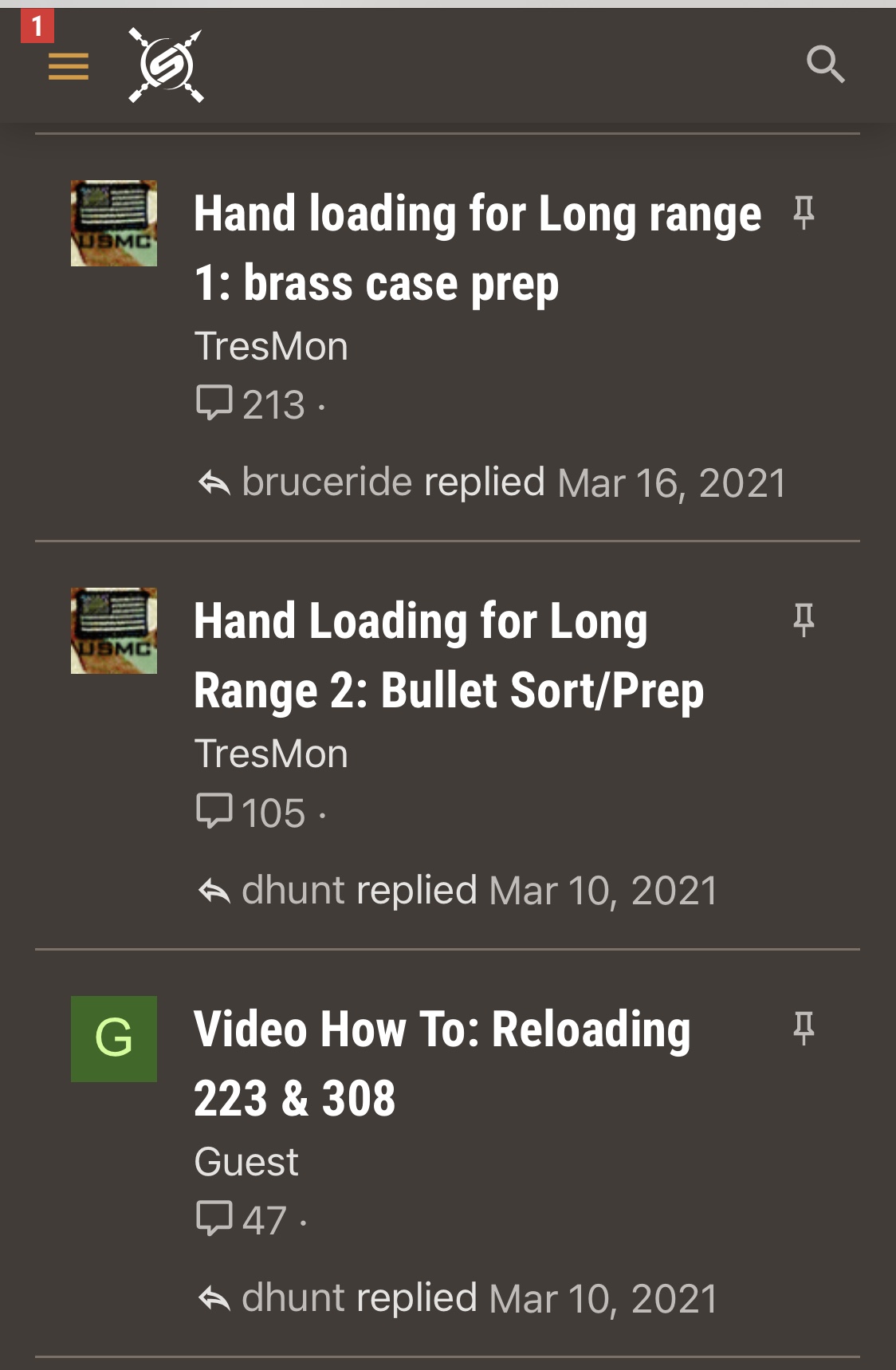

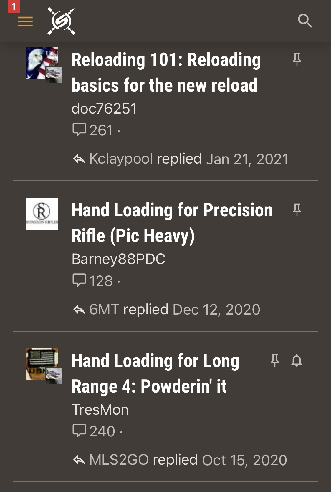

You’ve already received some good advice. I’ll add that there are some well written tutorials right here, on this forum, in this Reloading Depot section. They are pinned at the top of the first page, scroll a little ways down. Here’s some screen shots of nine of these tutorials:
Some of these were written and memorialized here as early as 2010 and while some improvements have been made in reloading gear, these basic concepts are all quite valid.
