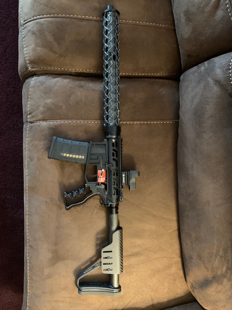

This looks really interesting but will the skeletonized upper receiver have reliability issues in adverse weather conditions, like rain, snow, sand, and mud? The carbon fiber handguard is pretty cool but does it mlok or keymod on the top and bottom for lights, lasers, and bipod mounting points?
It would definitely have all sorts of reliability issues....hence Gucci shit. Also, extremely light and not easy to shoot accurately. There are mlok adapters for the Brigand Arms handguard. Gucci or not, I like it for what it is. It is not the one I grab in the middle of the night. I have a Wilson Combat that I do. That Radian is untested but it is very likely to become the one I grab in the middle of the night. It has a 14.5" barrel but I pinned and welded a TBAC brake on to avoid the SBR bullshit.
Reactions: LilGucci

The pinned and welded Radian sounds like a good idea, I'm going back and forth between the TBAC Ultra 9 and Dominus 30-cal cans, so I might use a TBAC brake too. I wish my Radian builder kit came with a 13-inch hand guard so that I can go even shorter than 16-inch barrel.
