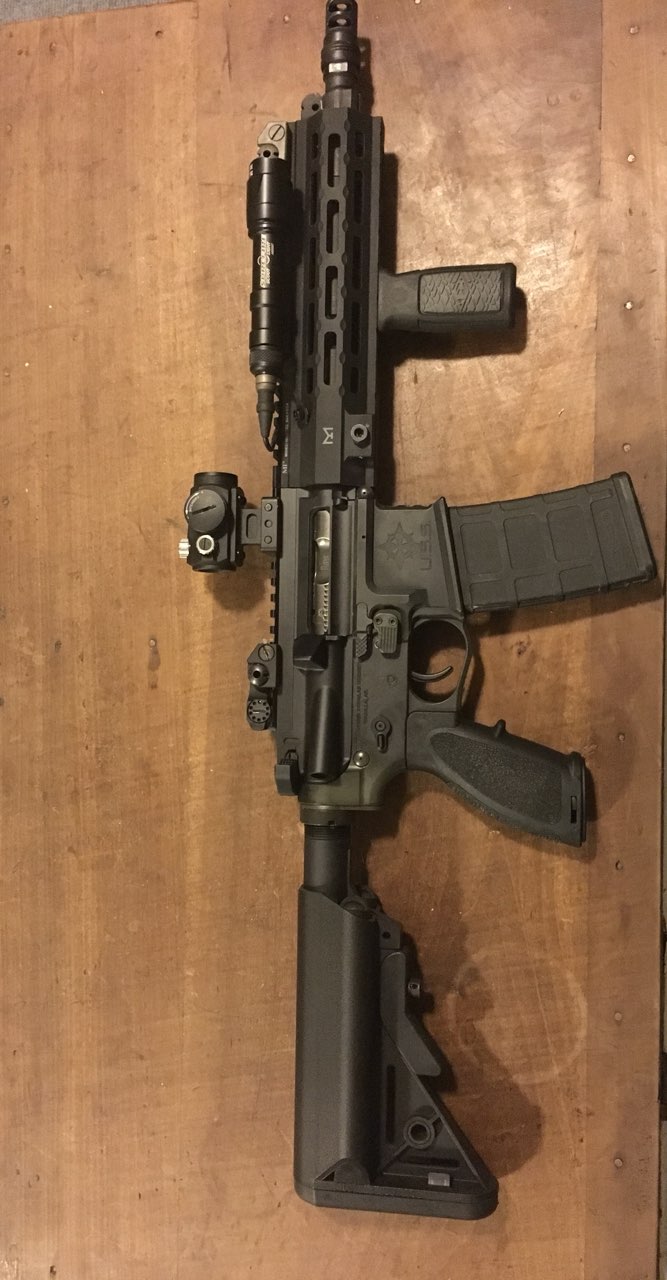

    I have a colt m16 coming and been thinking about going piston upper for the usual reasons. Ill be wanting 2-3 separate uppers. 2-556 and one 300bo
    I run 5.56 10.5 daniel defense di uppers now, but looking to try something different. I will be exclusively shooting suppressed, not AGAINST going a little longer in barrel, but 12.5” is about as far as ill go for now.
    I will be using this for coyote hunts and pig hunts when i feel like it.
    I looked at lwrc, lmt, pws, sig and pof. I have not ran any piston system other than a sig i borrowed from a buddy and never shot it supressed. Sig in my eyes is at the very bottom end of the spectrum.
    Flame suit on!!!
    range i helped out at had a lwrc piston upper on a rental m4. not suppressed, but zero issues and i'm not sure it ever got cleaned. i've used my full lwrc m6 dmr rifle at a bunch of 3 gun matches with zero issues, other than the time i had the ejection port jammed against a barricade...
    From my reading, suppressed and short are the problem. I had my eyes set on building a hk416 but then parts dried up, people “said” it would be way over gassed suppressed and short without a vented gas block. But i have ZERO real world experience with any of it and no friends with anything of substance. Dropping 2k on an upper to find out it won’t run right would drive me mad.
    I have both LWRC and PWS. Both shoot great and have been extremely reliable. Adjustable pistons help with gas blow back. But, nothing is going to get rid of the gas, it it is less with those two rifles. It also depends on what suppressor you are using.
    I have never shot a LMT, but I’ve heard they are very over gassed with suppressors and need to be tuned. I had a Sig MCX and it shot great. But was a little grassier than my LWRC and PWS.
    Reactions: RickyRodney
    What length barrels on your two?
    HK is the only one I would trust. It was specifically designed for High round count, SBR and Suppressed use without tearing the rest of the gun apart. Delta Boys worked with HK to come up with that mousetrap and its why its used by certain units.
    Otherwise just get some cheap 11.5" uppers and burn them up.
    Reactions: RTH1800
    Ill give them another look. Its tough building 3, but i will prob buy 1 soon, run it, see if i like it and continue onward. Going from 10.5 on my original search that has expanded to 12” might make my life easier. I do love my hk clones, they just run.
    Yea the increased dwell time going from a 10.5 to 11.5 is like 40%, much less violence on the action. A 12.5 would be even better.
    If you are doing mag dumps on FA just expect to see issues with gas port erosion. It will drastically reduce the life of the barrel depending on how hot you get it.
    Gas management is the other issue.
    If it was me, I would instead look for a belt fed upper. They are around $3-4K but much more fun. I mean you already dropped 20K+ on the lower, so why the fuck not right?
    Reactions: shoobe01

    I have a hk416 upper that I pieced together with a vented block and it runs like a sewing machine. I don't have the real thing like your lower is, but I have a bfs3 and I can run the piss out of the upper with steel and brass case and zero problems. I'm running a spring CO green spring and vltor a5 buffer system in it. I think for the upper, I was able to put it together for around $14-1500. It is also a tack driver if I put some effort into it.
    I will throw my vote in for the PWS Mk111. The barrel is actually 11.85". I have the PRO version and kinda wish I had went with the Mk111 Mod-2. The PRO upper is good. The upper is extruded and just looks different and feels a little heavier. This is my second PWS rifle and not my last. The long stroke operating system is amazing running suppressed. I can't shoot full auto but I predominately shoot suppressed and the PWS system provides the best experience I've had. I also picked the PWS Mk111 PRO up for $600 so that's a plus.
