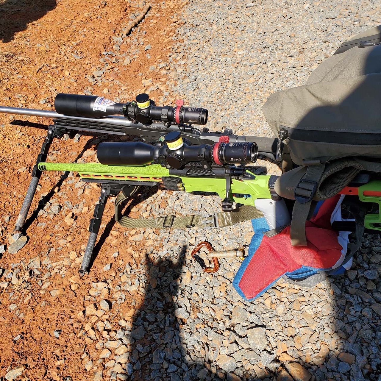

MDT LSS XL stocks
kelbly atlas actions
burris xtr3
ckyepod
my 6br has a 24" med palma
parter 223 is 18" (grn rifle)
both right at 14 lbs with bipod.

Thanks for the pic, sweet rigs. Did you see any .30 calibers in the competition?
