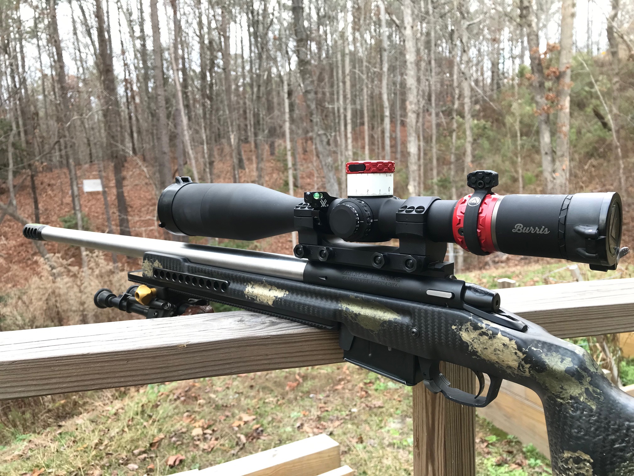

With that 50mm objective you can use a .92" if you wanted real low or go to a 1". Below is a pic for reference of a Bighorn TL3 short action and a 56mm objective scope on a 1.34" height rings and a Comp Contour barrel which is heavier than the M24.
It all depends on you and how you like it setup and what you plan on using it for. If you have a adjustable cheek piece it gives you the ability to fit it to you. It also depends on what you are going to use the gun for. A hunting rifle I want it to fit me. As for an ELR gun like it or not the scope has to be above what I find comfortable. Than I do the best I can to fit the rifle to me. When ELR shooting it does no good to have the barrel getting in the way of the target because the scope is too low.

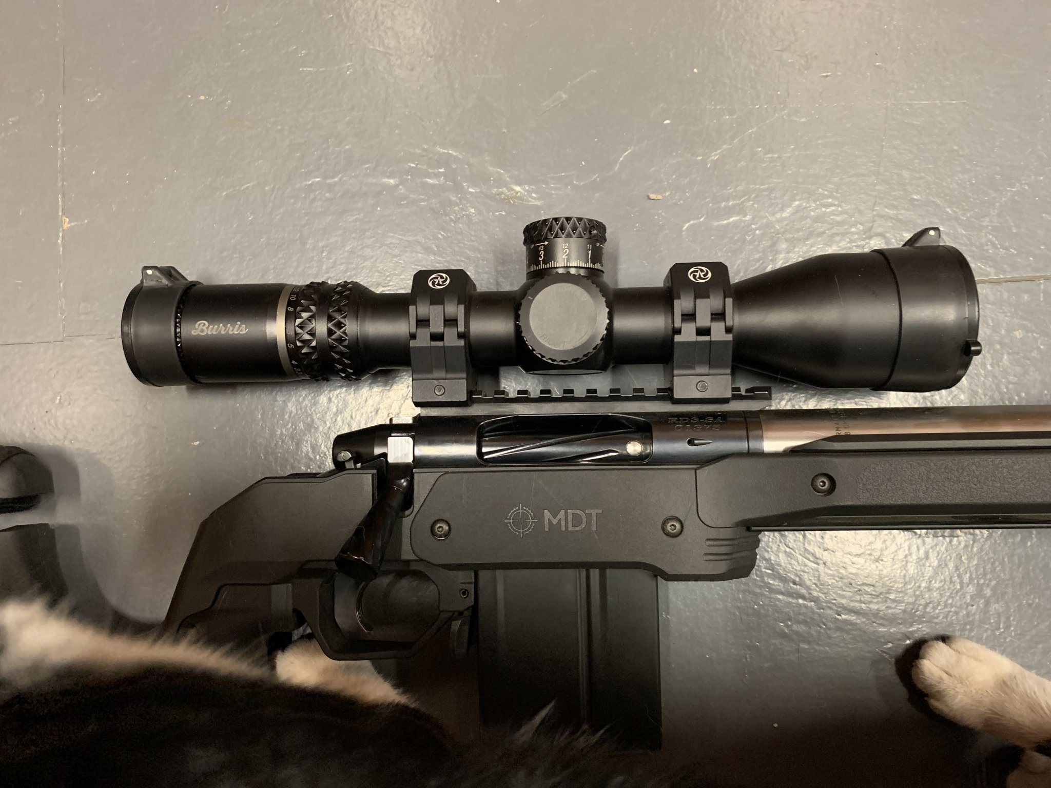

Here is my origin with a proof comp with my 3-18 xtr3 with its included caps sitting on 1.1” rings
It’s not overly low and it’s not overly high. Personally I wouldn’t go higher, you can see my cheek piece is up a bit plus a wiebad on it.
Reactions: wade2big
Yeah I wouldn’t go higher than that either especially with the stock he has not having an adjustable comb. He can use a stock pack and build it up some if needed though.

Keep in mind because of the relatively overall short length of the 3-18 and lengths of the scope in front of and behind the turret housing that the angled portion of the objective housing can sometimes interfere with the front of the scope rail on a short action if the rings are too low.
Look at the picture in post #6, if those rings were lower the objective housing would probably hit the front of the scope rail.
On a long action where the rail extends further forward it's going to be a real concern, and might require taller rings to keep the objective clear of the scope rail... which might make getting a solid cheek rest difficult as your PH stock doesn't have an adjustable cheek rest.
