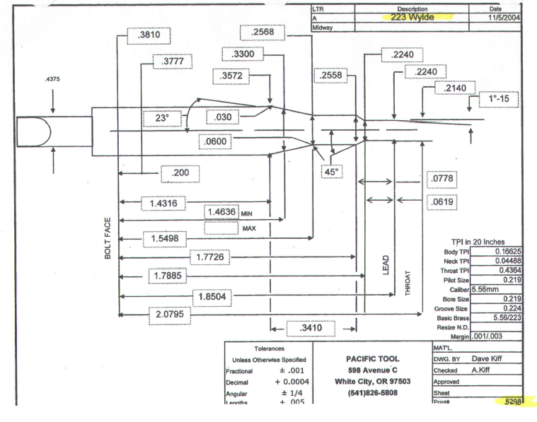

What is the freebore or throat length between the Wylde and the Match. Is one better suited for the heavys?
Criterions wylde is a .0619 freebore (as are pretty much all of them)
1517352649778-png.6870369

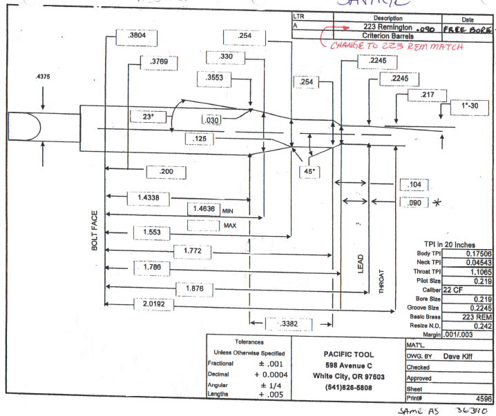

The criterion rem match is a .090 freebore and the throat is .004" tighter. When I asked some said that the criterion match still wouldnt be enough for the 90 sierras and that if you really want to run them then a freebore of .169 would be better suited, though way beyond mag length so single feed only.
1517352660762-png.6870370

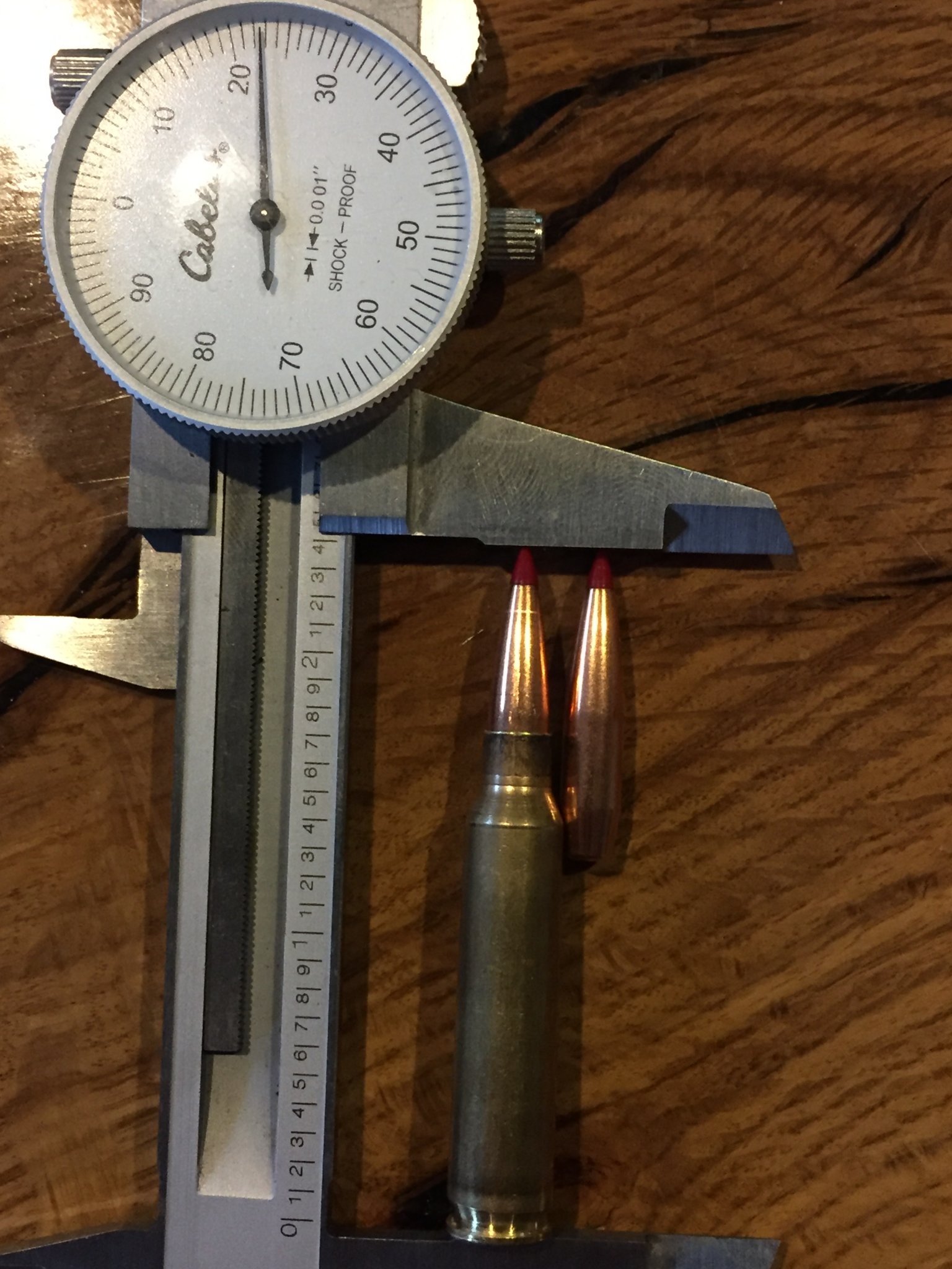

I can't get a 75 ELD-M within 20 thou of the lands at mag length in a Wylde chamber. Not sure how you would be able to do that with 30 thou more FB on top of that. My COAL with a 75 ELDM 10 thou off the lands in a new Wylde chamber is 2.65" IIRC
That's too long for sure.
I want a 75 eld around 2.45" ish.
What mags are you using? I trimmed the front lip off my accurate mag and it looks like I would have enough room. Ill try to get calipers on them this evening to compare oals with yours.
75 eld in a pva wylde chamber
Touching found via wheeler method is
1.892 ogive = 2.432 oal according to my notes
I wonder why yours is so much longer? I will admit that I had a tough time finding it and was initially way out at and beyond your measurement but worked my way back to where I am now and it had the traditional free bolt drop finally.
Maybe I need to run it again or check with a cleaning rod or borrow someone’s hornady gauge but I felt pretty confident in my result at the time.
This is one I already had loaded that’s seated .010 off the lands
The accurate mag by default is 2.3” but shave that little front lip off and you can get it to 2.5 and the plastic aics pos can take 2.55. So with where I’m at now I have plenty but you’re already way beyond.
