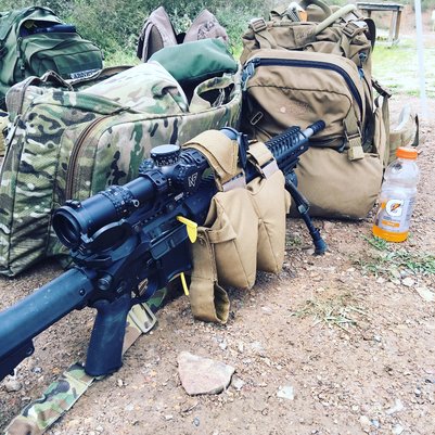

I've only shot one PRS Gas Gun Series match so far and used a NF ATACR F1 4-16x42 Tremor 3. It performed flawlessly and there were a lot of shooters running the same scope (not sure about reticles however). I used 10-16x the entire time and there was only one stage where I would have liked a little more magnification to try to spot misses with the tiny 77gr bullets but I'm not sure that it would have actually made a difference and I would have severely limited my FOV for finding the next target or spend time running magnification back and forth. Ideally better wind calling or a ballistically superior round would have made far more difference than more magnification. The Tremor 3 performed flawlessly holding elevation and wind as well as dialing elevation and holding wind, sometimes on the same stage. I'm sold on the reticle.
That optic will remain on my 223 DMR setup but the 6mm gas gun I'm putting together now will get a S&B 5-25x56 Tremor 3 but mainly because it will be shot to much further distances as well. If all shooting was inside 800 like the gas gun series (the match I shot the further targets were 680yd) then I'd have no reason to get a 5-25.
There's a lot of great options and I don't think you could go wrong with any of the quality optics in similar magnification ranges but I would highly recommend choosing one with repeatable turrets with a zero stop and christmas tree style reticle in whatever system matches the turrets. I like the Horus options the most, you can't go wrong with the Tremor 3 or a H59.
A low magnification optic would put you at a serious disadvantage.
