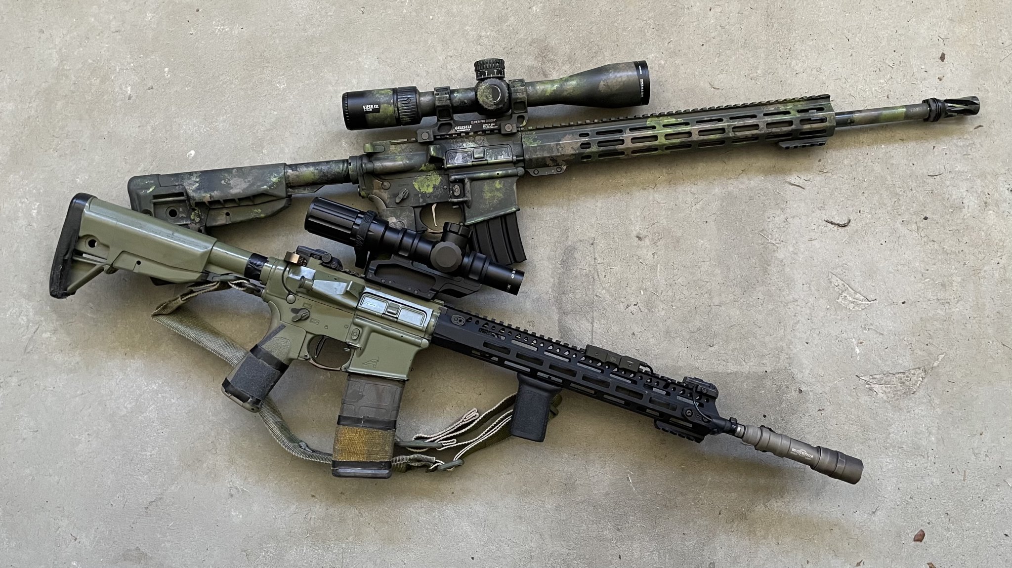

What scope height are you running
SPR: 1.54”, 20MOA
Recce: 1.93”, 0MOA
Perhaps a 1.7” would be a good do-all height, but I’m really enjoying these two heights for their respective purposes.
Whatever is needed to get the day optic on plane with the clip on 🤣
