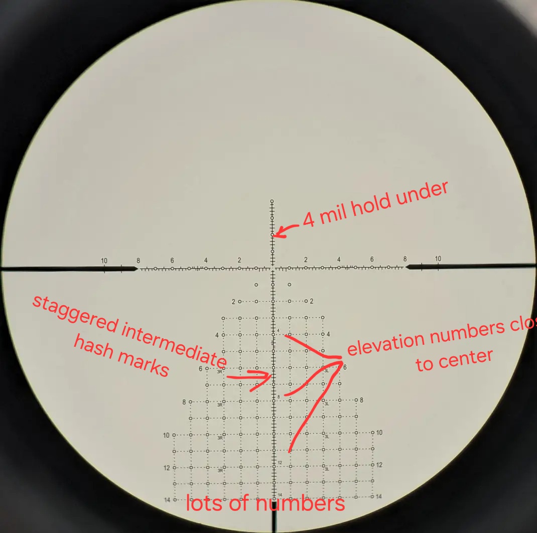

This is the probably the best reticle I have seen for my uses, the ZCO MPCT3X:
These aren’t all deal breakers necessarily but I would really prefer to have all those features. Some scopes that almost meet the criteria are:

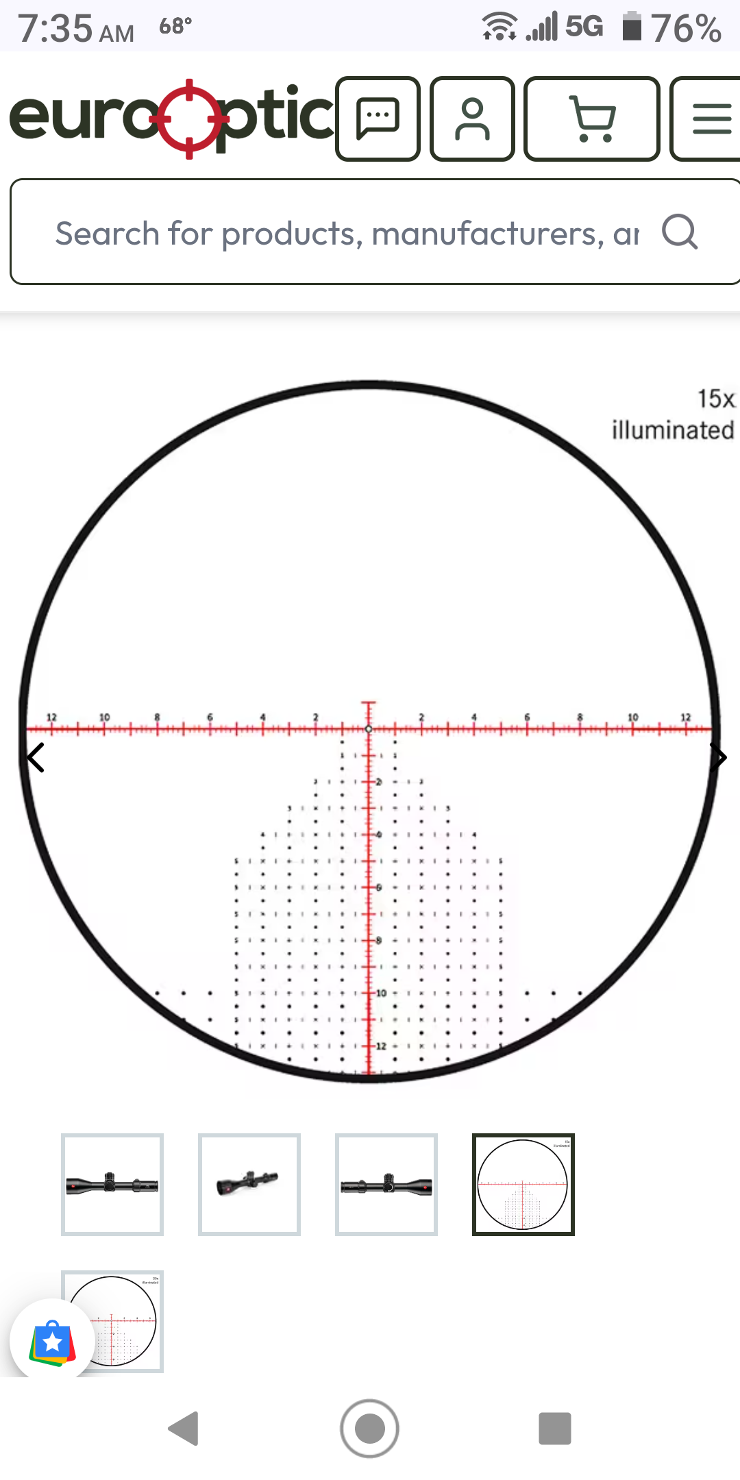

Zeiss LRP S3 Series
-FFP/MRAD (obviously). YES
-Magnification minimum 5x, maximum 20x (preferably higher). 2 choices, 4-25x50 or 6-36x56
-Minimum focus distance of 25 yards (preferably 10 yards). 4-25x50 is 15 meters to infinity / 6-36x56 is 10 meters to infinity
-Max weight around 36oz (preferably lighter). 4-25 is 36.7 oz / 6-36 is 39.1 oz
-Locking turrets (locking or capped windage a must.) Locking windage yes, Elevation does not lock
-Illuminated reticle. Each unit has dual illumination red and/or green – dial selector, daylight visible
-34mm tube. - YES
-About $2500 USD max price. Right on target – $2299.99 and $2499.99
Also has best in class for total elevation travel -46.5 MRAD and 32 MRAD respectively -
ZEISS LRP S3 First Focal Plane Riflescopes for Precision Shooting
The reticle itself should have:
-Christmas tree design (preferably a bit narrow and not really a grid.) YES
-Elevation numbers close to the center and lots of them. – Zeiss' are at the outer tip of the line for MRAD, but centered on the vertical line for the MOA
-Minimum 4 mil of "hold under" marks above the cross hair (for use with weapon mounted LRF and holding under for close range targets at matches.) The Zeiss has 3 Mils “hold under”
-Markings not overly thin. Subtensions range from 0.2, 0.4 and 0.6 for most marks that the shooter would use
-Staggered intermediate hash marks between full mil marks. YES, staggered .2, .4 then a .5 dot, then .6, .8 and 1.0 etc all the way to the end of the respective line
lrp_s3_datasheet_reticles.pdf

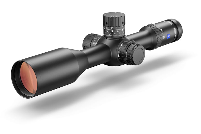

That Stryker isn't bad, the turrets aren't too tall, not like this Zeiss or something:
I know I am being picky and whiny and that's because I'm a picky and whiny person. But also have a Tangoinnos Fire4000 WMLRF that will be obscured by a tall turret.

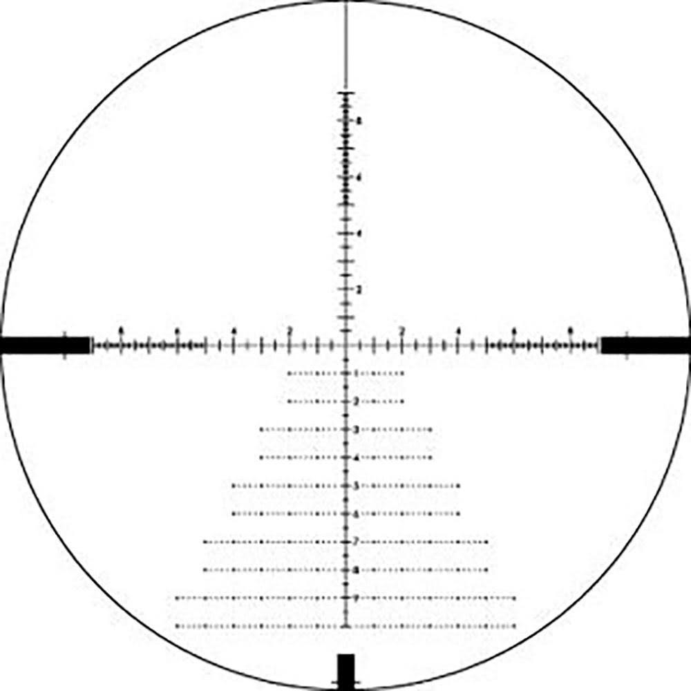

Conversely, if you want to stay a bit more on budget, Vortex Viper 5-25x50 FFP is very impressive for the money. It checks all of your boxes and is probably the bang for the buck champ here. There isn't a huge amount of elevation adjustment in it, but enough for NRL Hunter.
