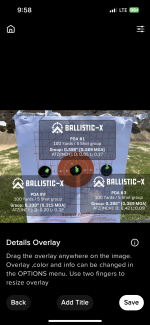

So, when I shoot over 600yard paper target, the top and bottom length is 9 inch, 6 inch wide.
Everybody told me that is due to your factory ammo, Horandy 6.5CM 140grs ELDM, and factory barrel.

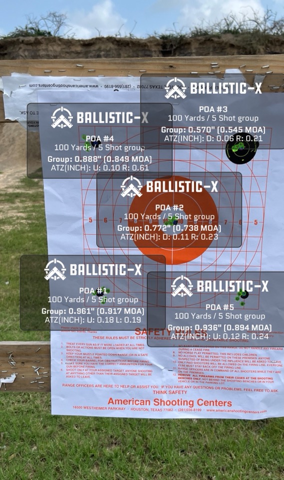

As you can see, within 100yard and 200 yards, groups are, I THINK, pretty small and tight.
But when it comes to long range, it spread.

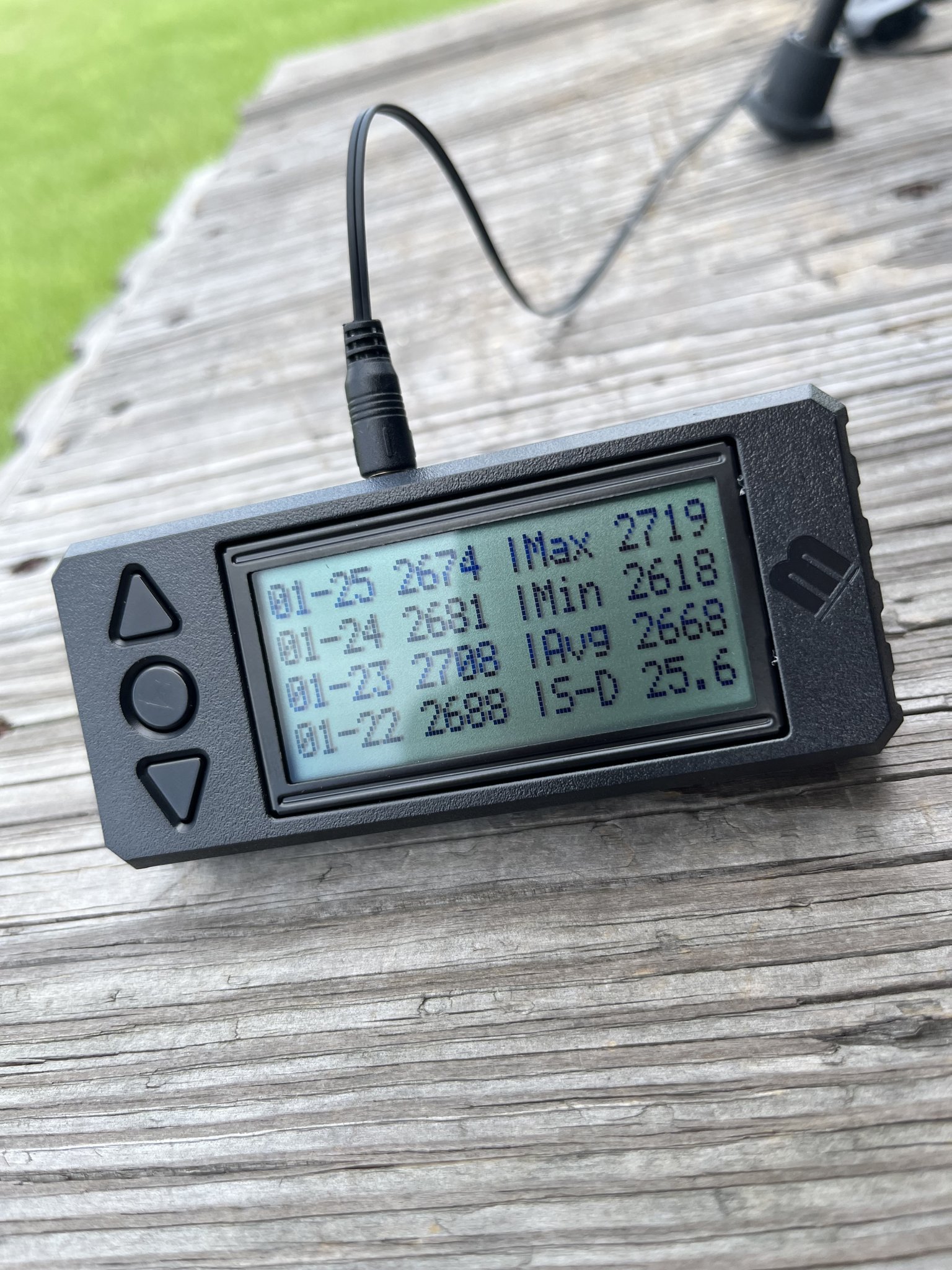

and last pic, you see that I just checked hornady 140gr 6.5CM ELDM, and ES was 100, and SD was 25
So, what I am really wanna ask is, what is the next step? What should I do for the better performance

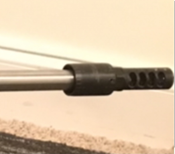

Custom barrel? I think i need for now, I can swap the custom barrel, So i will go to local gun smith, but
what is the best custom barrel? Proof research's one is not the custom barrel?

You have 101 fps extreme spread according to your chrono. That by itself will produce almost 6” of vertical at 600 yds. Ideally, you need to reduce your velocity spreads by roughly 75%. Youre not gonna get there reliably with factory ammo.

As said above; 100 FPS extreme spread is going to introduce A LOT of vertical dispersion at 600 yards regardless of how good a barrel is. We're talking about 7 inches of vertical spread with your bullet and cartridge choice, depending on atmospheric conditions.
Correcting that would be my first step, and you are going to have to handload to introduce any real control into the situation.
Changing to a premium barrel and continuing to use that poor ammunition is going to make little difference for a lot of money spent.

We’re all of those 200 yard groups shot at the same point of aim, without adjusting your scope? If so, you should create a “composite group” that included all of the impacts- which will give you a better idea of the rifle’s true precision. I suggest this as it appears that your groups are walking around on the target…
I think I adjusted my scope couple times, cuz that is my first time shoot out to 200yards, so I did not have my own data.
But, I will check the composite group.

4. I already have Area419 hellfire match, but I can apply the barrel tuner too?

Yes you can put an ATS tuner on with a brake. It threads on behind the brake.

A new barrel really won’t clean up the mv dispersion in factory ammunition. It may seem like the easy button, but you’re still limited by the ammo.
But, hand loading can make what seems to be a “meh” barrel shine- or at least not suck. I think there is a bigger potential “bang for buck” in hand loading, but there is also a learning curve and additional experimentation required.
If it were me, I’d see what I could wring out of the current barrel with careful loading, then consider a rebarrel if my precision goals were not achieved. I would expect to need to hand load for the new barrel, and have not wasted valuable barrel life of the new barrel in learning how to make quality ammunition…
Oh i will check the tuner too!

Put the chronograph away.
Set up on the bench, exactly as you intend to shoot, and dry fire.
Does the reticle move? Does the reticle move the same direction? Does the reticle move the same distance?
Now shoot 1 group. Dry fire some more, rinse and repeat.
The 100 yard groups are good enough for a lot of disciplines. You need to move that same level of marksmanship further down the range.
A 6.5 CM is easily a trigger pulling contest out to 300 yards on most days. i.e. If you don't move when dry firing and don't move when actually firing and have good execution and follow through, you hit where aimed.
At the 600 yard line it is no longer just a trigger pulling contest and your ability to read the environmental factors begins to show.
The SD and AVG you show are a .4 moa vertical spread at 600 yards according JBM Ballistics' trajectory computer.
A reality check on this skill. If your groups are nice and tight side to side, but tall, then you need to be concerned about extreme spread, as long as it's not anticipation. Until the vertical spread is more, say maybe twice as much as, than the horizontal spread, marksmanship needs more work than ammo.
