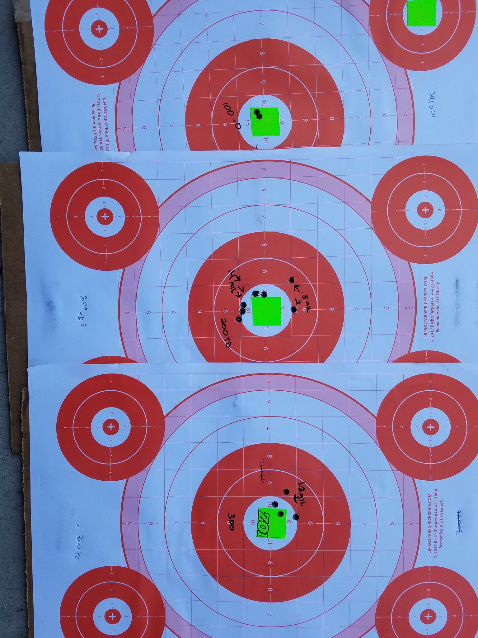

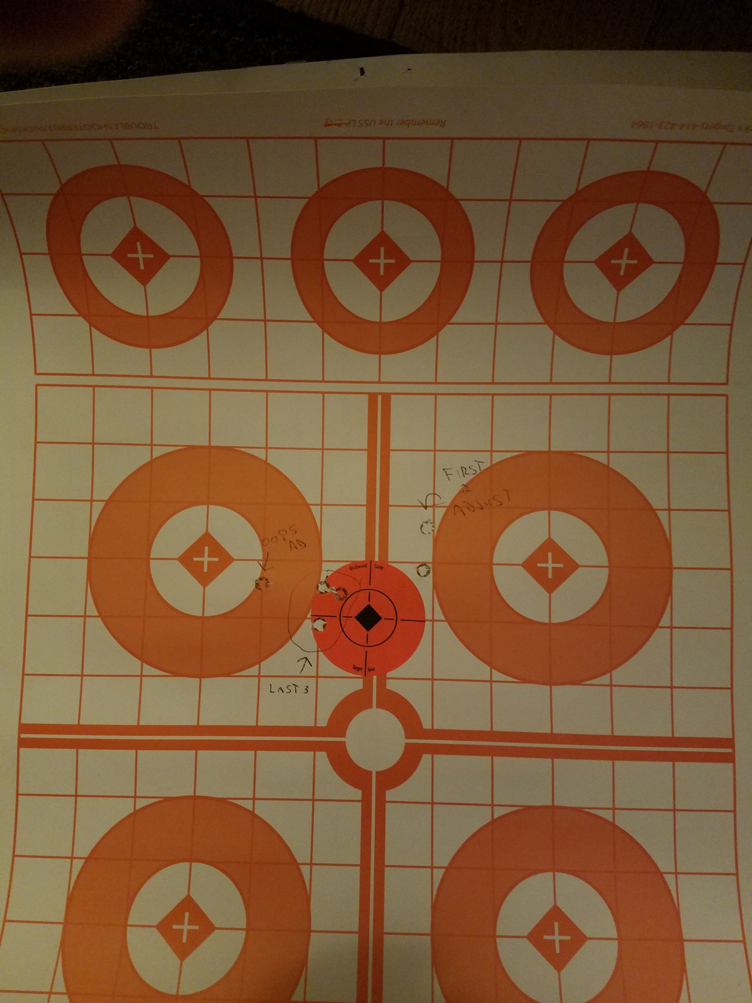

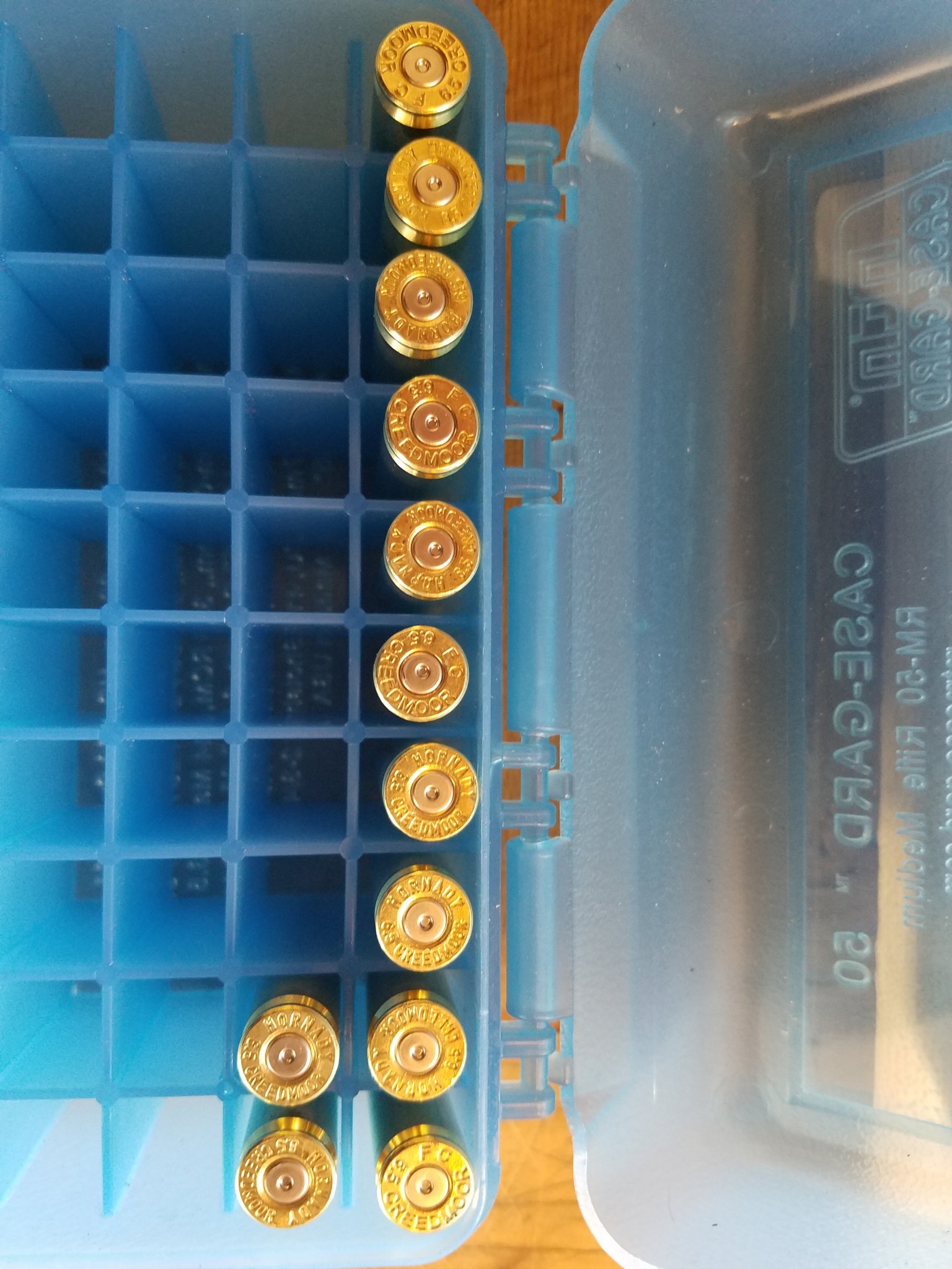

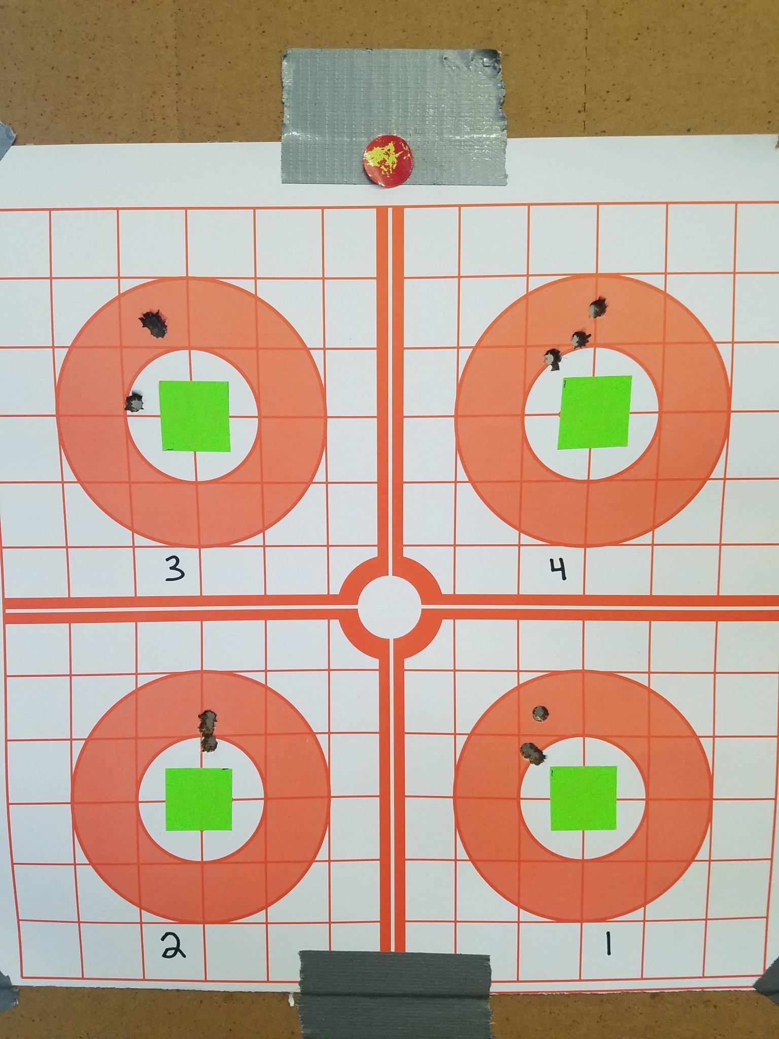

I think I know the answer already but I'm going to ask it anyways.
I just got my rifle put together and started load developement. For now I have 140gr Hornaday Match Monster bullets and IMR 4064. I've come up with a pretty nice mix that seems pretty accurate doing about 2625fps with no pressure signs. My powder drop is 37.1gr. Yesterday I was able to get to a range that goes out to 300yds and the results were satisfying. I wasn't sure how the gun or my ammo would do but everything went pretty well. I do have some H4350 and some 140gr ELD bullets, but since I am brand new at this I think I want to focus on the current load until I learn more later in the season. I don't have a ton of the better stuff and it doesn't seem I will get any soon. I also have another 1000 Nosler Custom Competition bullets on order, and I think they are very similar to the MM bullets. The ogive is further forward towards the point of the bullet, so I have to push the OAL back to 2.785 to get the bolt to close. With a dummy ELD loading 2.820 is no problem.
There is the long winded background, now the question...................... The first match of the season is April 10th. I was hoping to have the chance to get out somewhere and build some data before I shoot a match. As it looks now, that won't happen other than what I did yesterday. I just sent an e mail about one opportunity I may have but I'm not counting on it. I have .2mil at 200yds and 1.0 at 300. I don't have a Kestrel and I learned the Marc Taylor weaponized math at the class I took with him and Frank last year.
I know there is a lot of data available, but until I would actually try it it's theory. Do I jump in with both feet and say fuck it, I want to shoot and see what happens? Baptism by fire is usually a pretty good teacher, but the matches are expensive and components are not readily available, as everyone knows. I don't want to shoot 100 rounds into the wind but I guess you gotta start somewhere.

That is my 300yd target, I'm trying to get the other one to send.
If you have access to a 300-yard range, you can get a fair amount of truing for any given load.

Double check your zero and target distances. Drops of .4 for 200 and 1.2 for 300 sounds about right for a 140 class bullet.

Do not use mixed head stamp Brass when trying to load precision ammo.
10-4! Luckily all I have is a bunch of Hornaday once fired ( some of it twice now) and some new Starline brass. I will re check everything when I break into the Starline. I even have some new SRP Starline to hedge my bets against not being able to get any more large rifle primers. Again, I'm sure that will be a new load starting over.
My comment was due to the picture you posted. It had Hornady with some FC head stamp mixed in.
Internal case capacity differs & that will have you chasing your tail trying to work up a load.

That was a good catch. When I looked through it all I saw was Hornaday. The pic was for someone on here to verify for me I had no pressure issues. That may very well explain my every once in a while 50fps velocity spike. Nice!! They are still in that box in the order I shot them in so it will b easy to check.
