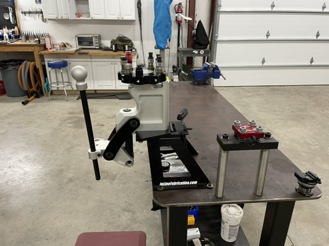

Consider using stand offs to allow use from either side.

I also use C clamps and put the vise away when not in use.
