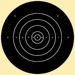

That's why every now and then I go to NRA 600 yard prone matches and shoot in F-TR. This target is 3 ft across at 600 yards (6 MOA) but it tells you shitloads more about your shooting ability than any steel plate, of any size, at any distance:

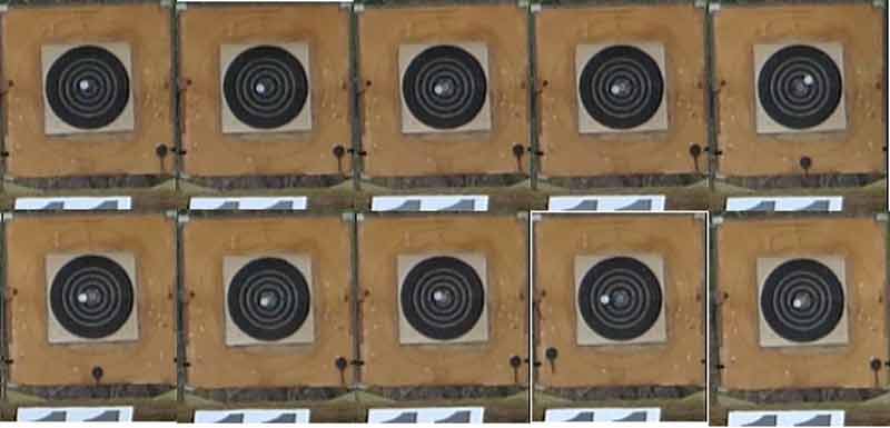

I have just started 600 F class (4 meets)
I practice a a local 100 yd range using scale 3 inch targets for load development, practice, sighting in.
Last time out was a 94%-10X my personal all time best.
Pic of one string. Ouch, an 8 :mad: and a pulled high and right 9.

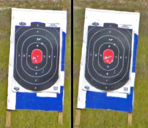

Let's talk about 750yds ... at 750yds I am shooting IPSC(2/3) which is a 6x6 "face" on top and a 12x18 inch "body" on the bottom.
I won't say I can see every miss, because high shots are hitting in a tree line ... though even those I can see most of ... and if I am short or to the left or right I can see. And that's either in the day time or at night with thermal (have to heat the steel). In fact, with the thermal, I can see the trace and the hits and the misses.
Further, in most conditions I can see the splotches on the target when I hit. I paint the targets after each session, so I have a fresh surface to see the splotches of the hits against.
So, I can see 90% of my misses day or night and about 80% of the time, I can see the splotches of the hits on the target, showing me exactly where on the target I hit.
Now I'm an olde man, so you youngsters should have a much easier time of seeing these things than I do !!
Summer, clear conditions ... can see the splotches on the targets in these conditions. And can see most misses, though high misses are harder due to the tree line ... but I can still usually see them, since even when I miss I only miss by an inch or so, I I am looking near the right spot. And high misses are rare anyway, the vast majority of misses are wind misses to the left or right.
Another summer shot ...
In the rain, it is definitely harder to see the misses and the splotches of the hits ... though I can still see most shorts, lefts and rights, but but not overs or the splotches. With 5.56 sometimes can't hear or even see the hits. But with 6.5 or 7.62 I can. The thickness of your targets needs to be aligned with the calibers you are shooting, there is no "one size fits all" for steel.

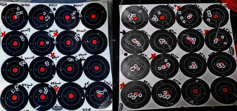

For ranges up to about 300 Yards with splatter targets, I record pictures with an older FZ70 digital camera.
As long as I keep good notes I can correlate loads to pictures and Chrono results. Like in the previous 3 inch target groups.
From my notes I kept track of scope adjustments and later marked the targets (little black arrows in the previous pics).
Or, dialing in in this pic. This way I don't need to keep all the paper in a scrapbook (the really good ones go one the fridge :) )
