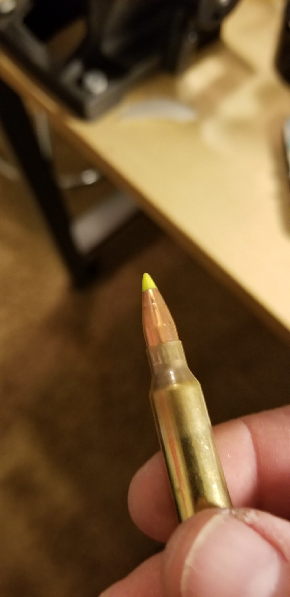

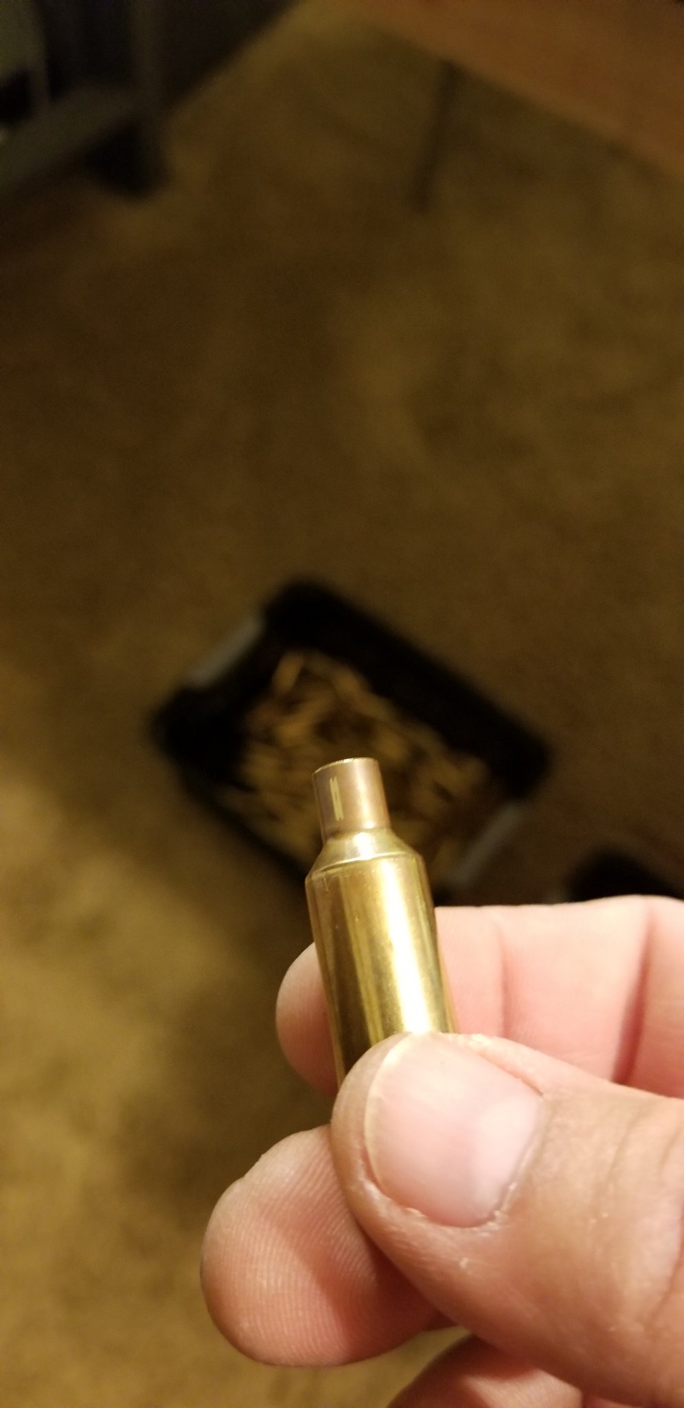

What the hell is causing these marks on the neck?

Need more information. Are the marks from the die (after processing, but before shooting) or from the rifle ( before processing)? Plus, your pictures are for two different calibers with different shoulders. Is this happening on more than one cartridge? Plus the pictures are not really sharp to me on my phone, so hard to find details that might be telling.

Top one looks like new brass that wasn't deburred, Polish the bushing, a flashlight will tell you if it is scratch free, then deburr your case mouth, it's just grit from dirty mouths getting worked down.
The only thing that throws me off about this is that in every case, the marks are equally spaced, like fluting. Lube usually fixes it for me
The ring around the bullet indicates either your adding to much crimp too early, or you have way too much neck tension. The later could also be causing some of the gauling it looks like you're getting. Measure you're loaded neck, even on that mangled one, and subtract .002-.003" from that. That is the bushing you want.

I own a shit ton of Redding bushings, and many of them will do that. I hone the standard steel ones myself to clean up the shitty chamfers(which is what’s causing that). The Tin coated ones do it far more than the standard steel in my experience. Wilson bushings, in my experience, have a nicer internal finish, and will solve that problem. Regardless of bushing make, if they pick up brass particles on them, like if you don’t clean the case well enough after trimming and chamfering, the brass on brass galling will contribute to that.
Maybe I missed it but if it’s a Tin coated bushing, polishing it will remove any brass that may have adhered to it, but it won’t change the bushing at all. The coating is too hard.
The .223 case is completely processed and cleaned. I only annealed it on an AMP annealed. The 6 dasher is also cleaned, but tumbled in rice. The .223 seems to have more marks on it but the dasher has more prevalent ones. It may be a matter of not enough lube after hearing this.
So it’s probably not galling then.
You can flip the bushing over and run it numbers down as well. The other chamfer may be more friendly. Bushings typically have a slight taper in them so you’ll get more sizing(a few ten thousandths), but it won’t affect anything.

If the bushings are absolutely clean and more lube does not fix the problem, drop the setting on the AMP by 02 as over annealed brass is a cause of galling. The AMP settings were created using the lot numbers that they post, but they do not account for differences in weight within the lot, or after the brass has changed in volume from stretching. They literally test with whatever was sent to them, regardless of new or many reloads. I have been sacrificing brass after 3-4 firings to the Aztec mode for verification. Some are dead on, some to hot, some not hot enough.
Your bushing has been scored (I had this happen using graphite neck lube). Flipping the bushing over may help, but IME, once it (the bushing) is scored, it will continue to leave that mark on the neck of all your casings.
Reactions: DIBBS and Shifty6BR
I've xp'd the same thing before with one of my redding bushings, tin as well. Not sure how much brass you have run thru yours but I started seeing mine after some hefty use. I have found it to be purely cosmetic for the most part and just went with it as end results were not affected. Eventually I got tired of looking at it and replaced that particular bushing and all was well again aesthetically speaking.
Put some Flitz or Brasso on a felt polishing tip and with a dremel (or high speed drill) polish the inside of your bushing. I had one that just happened to fit through the bushing ID with just a bit of resistance.
It will not remove any of the hardened steel, but will remove any brass or carbon on the inside of the bushing. Don't go crazy, but 6-8 good passes.
Did it last night on my bushing. Dremel on speed 6-7 (out of ten) about 6-8 passes with Flitz...nice shinny mirror finish again. Brass went from looking like yours to no scratches in about 1 minute.

That's easy to take care of, take 600 or 800 grit Emery cloth to polish the bushing. It happens from time to time with my bushings and regular dies. I just bought some polish to try out but haven't tried it yet.

I sent a sizing die to Forster for this exact problem.
Here's what they said, "Die has been repolished to remove the brass build-ups that were causing these scratches. To prevent this in the future, be sure to chamfer and deburr especially new brass...."
