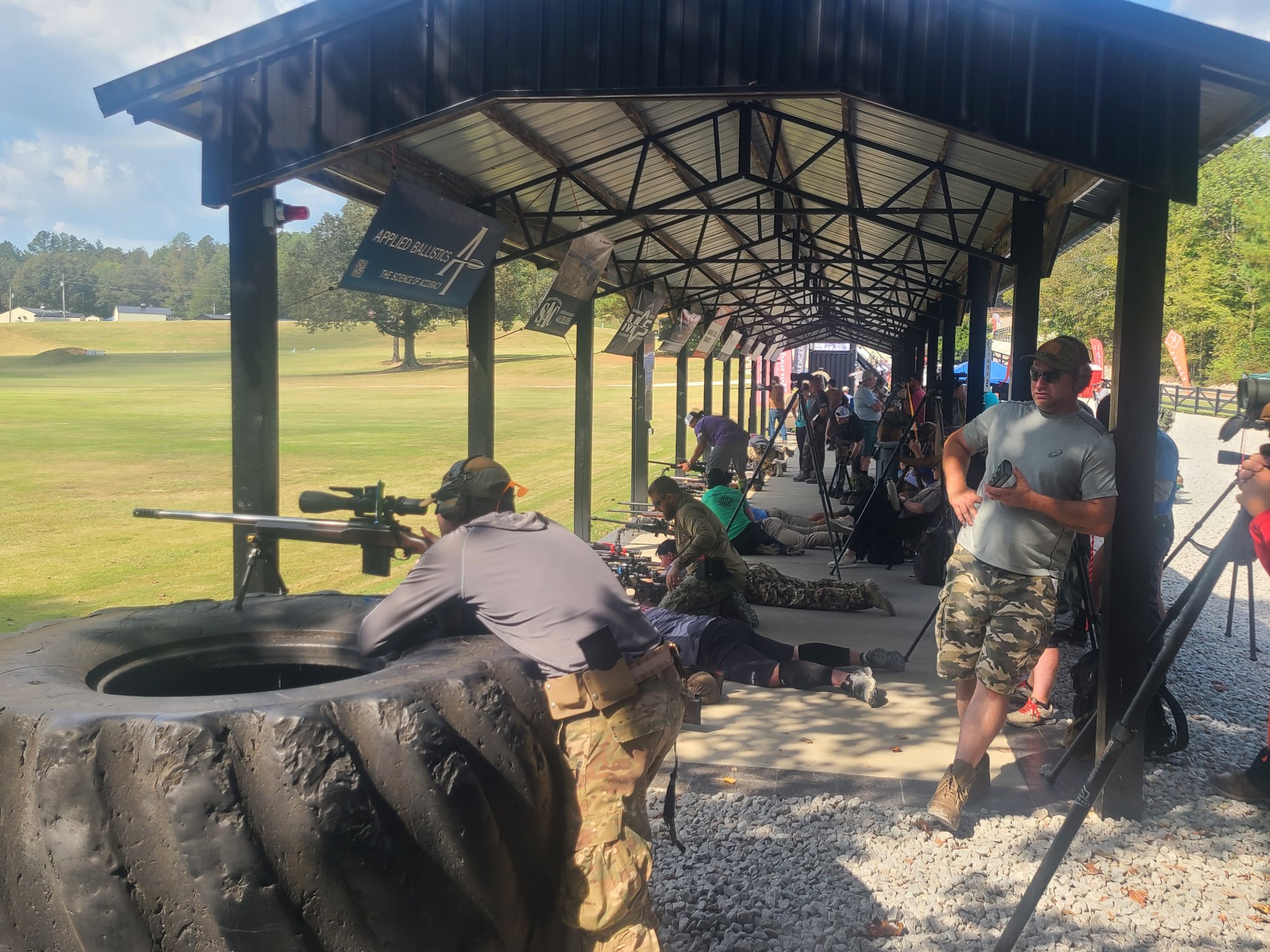

GapGrind k&m- A ton of people. So many people, 20 person squads, pros do all the spotting, some stages AMs have a different COF, Solid props, all prone will be done from shaded concrete floors, 90sec par, rarely leaving plate for wind, soupy mirage, afternoon sun that’ll make seeing targets tough. Zero day is a war zone, get there 1hr before they say it opens, they’ll already be people shooting.

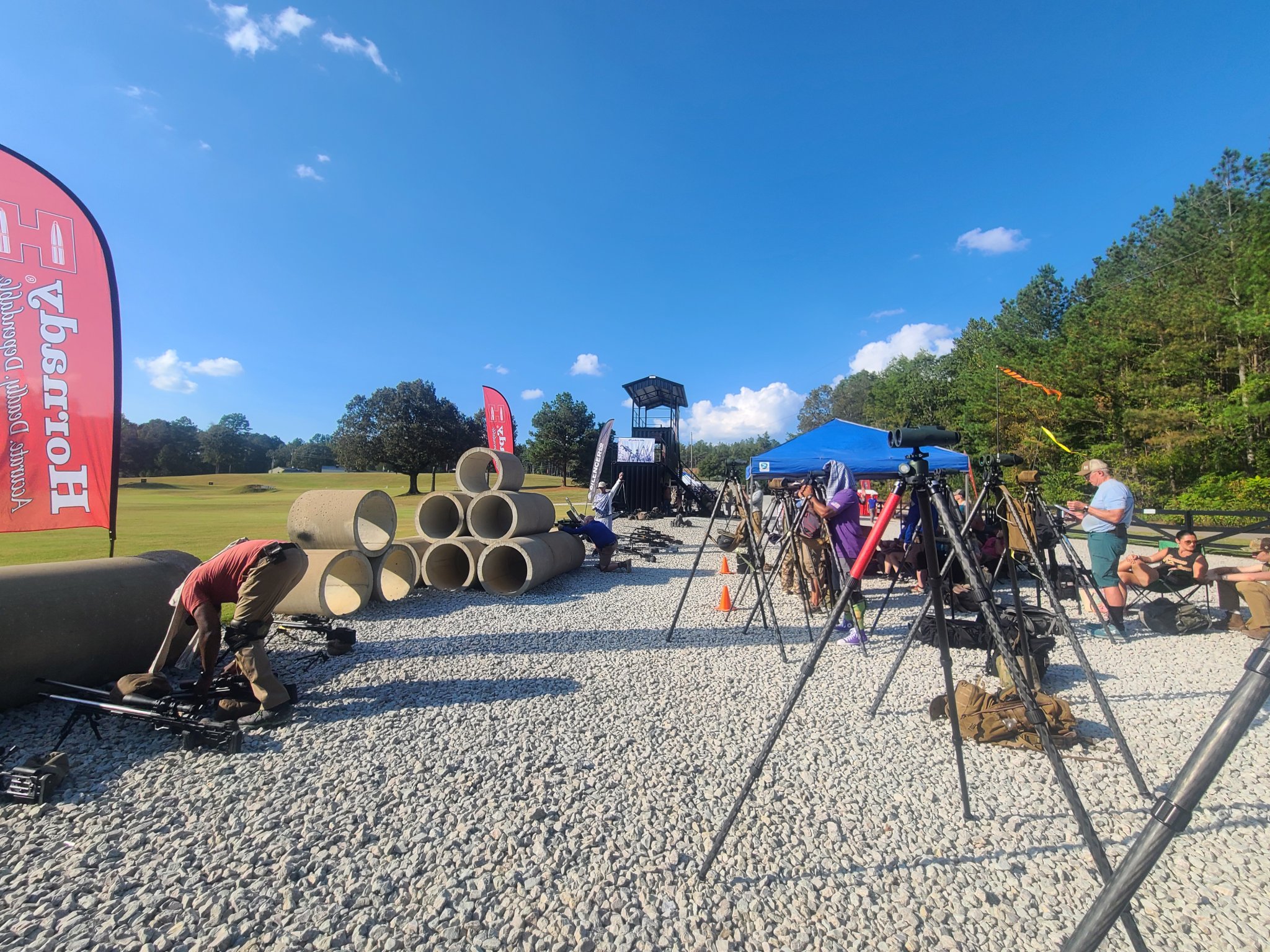

I feel it remiss to not mention that most of the ranges are near golf course level of grounds-keeping.

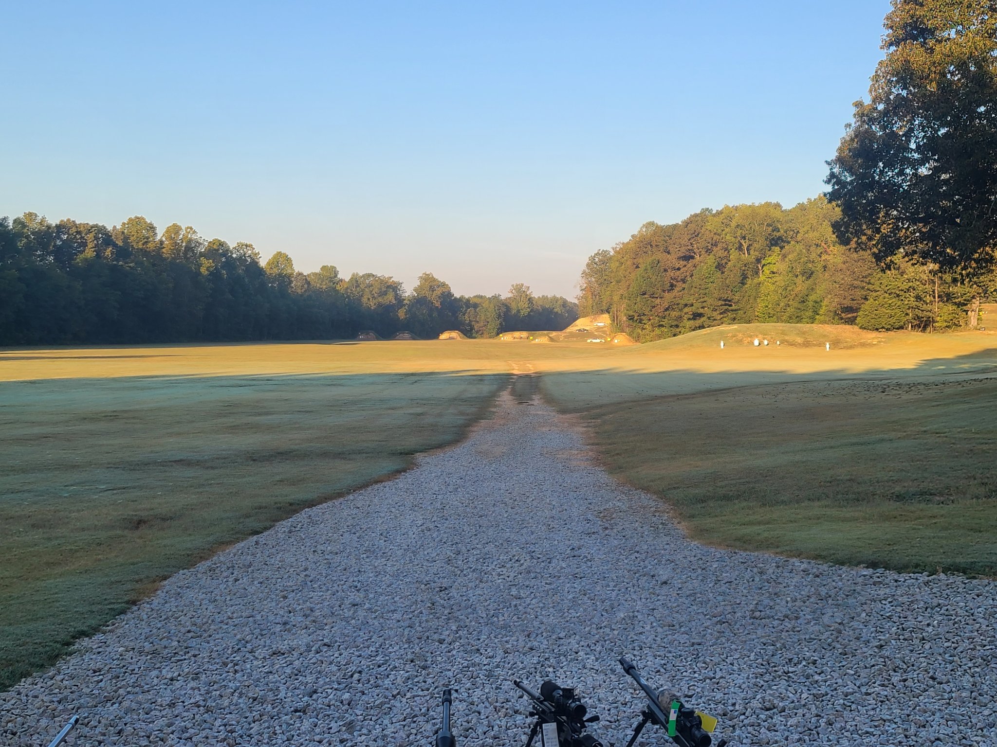

Prepare for anything! We’ve had mornings in the low 40’s and afternoons near 90. They usually try to get through at least 11 stages on Saturday to shorten up Sunday. The last stage or two on Saturday will most likely finish with the sun in your eyes, making it nearly impossible to see through your scope, so plan accordingly. You ARE allowed to use whatever you take to the line with you to help you with the sun. The PRO’s can help the AM’s with that, but PRO’s are on their own. I’d also strongly suggest bringing knee pads. After 2021 (the big muddy mess), every shooting line is either concrete or large gravel. It’s nice that you’re no longer laying in a swamp (my wife has a picture of me prone in a mud puddle up above the clubhouse), but the large gravel sucks on the kneeling stages! Most of all…have fun!

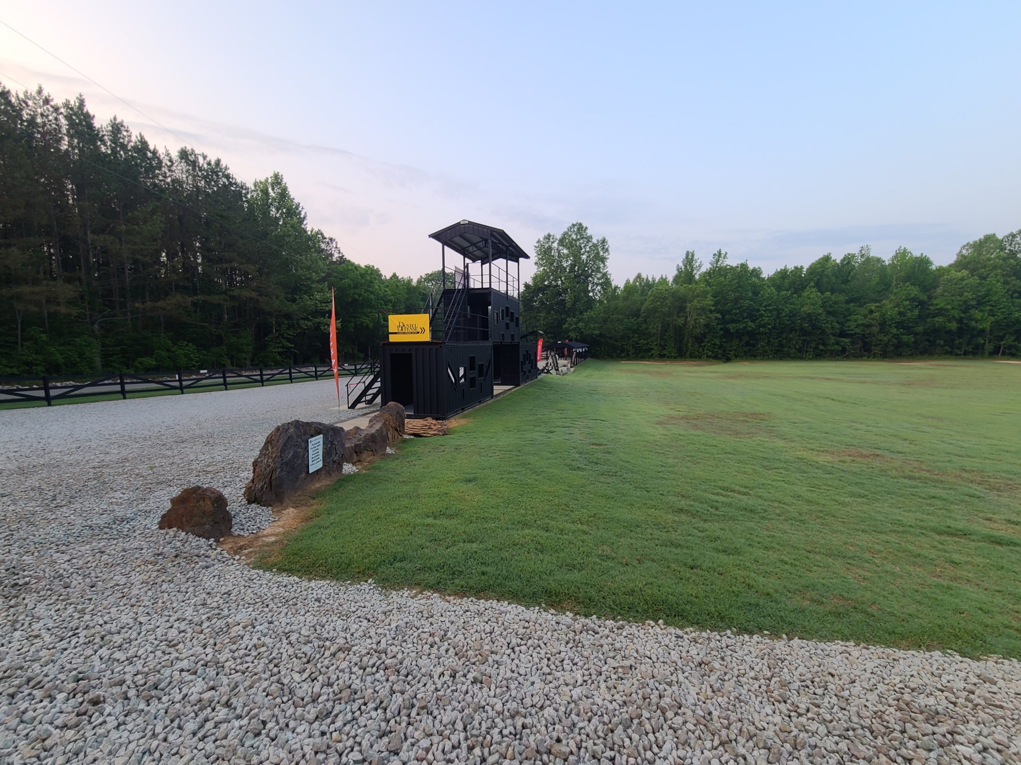

Shot the Grind last year - shooting it again next weekend. K&M is a gorgeous square range facility (as the pictures above attest).

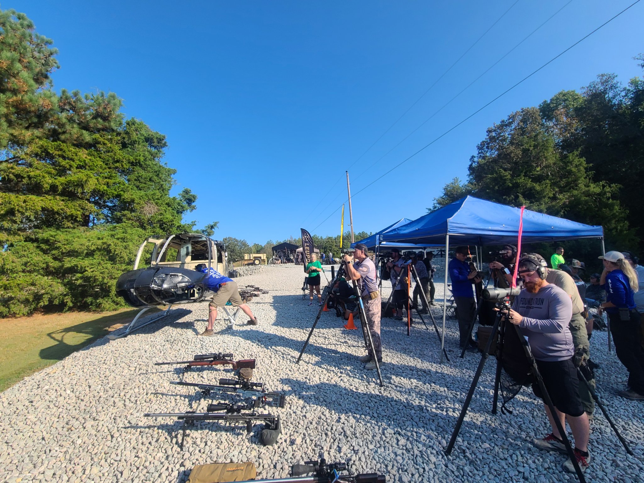

Lots of prone stuff, where you start prone on the rifle - it helps with match pace. Props last year included tires, barricades, rocks, cement culverts, a helicopter, cars, cattle feed ring, shipping containers with ports in the walls, etc. Generally all very solid stuff. We were allowed to start with tripod deployed on at least one stage last year, but it didn't make that much difference to stability on the stage.
Expect a couple of long walks, including a hike up ... what, 50' elevation? ... for the highest numbered stages. They have trailers that help with rides between major parts of the range, and some of the gravel is pretty chunky - several of the folks that I shoot with favor carts for their rifles and did nothing but struggled all weekend trying to get their carts around across the range. I'd recommend just hoofing it and catching a ride on the trailers for the big moves.
