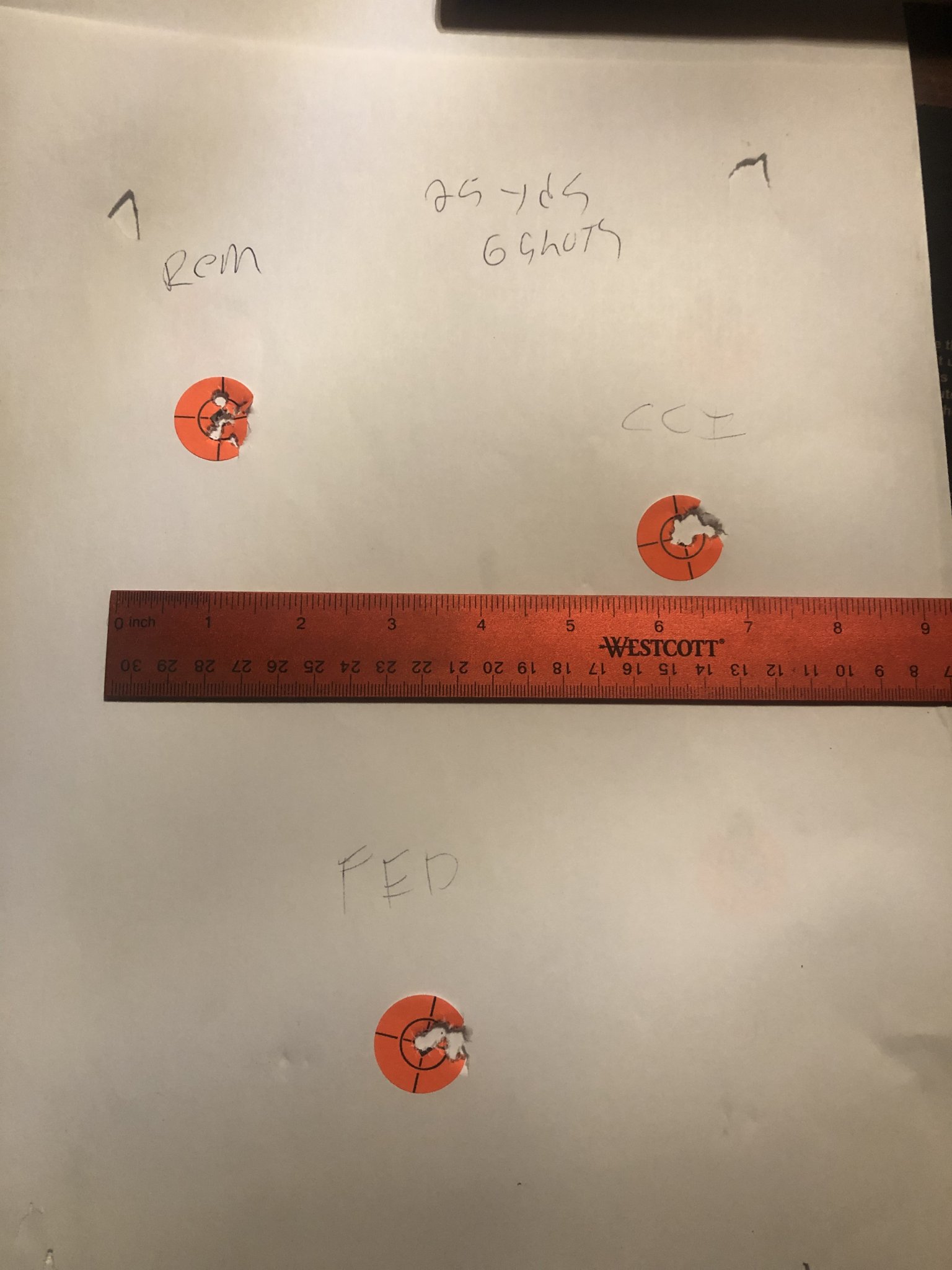

I put a B14r together and finally had a chance to shoot it today. I only had 3 different brands of ammo, Remington gold bucket, federal match and CCI. All three grouped 6 shots slightly under a half inch at 25 yards and right around an inch at 100 yards. Vertical the shots were all pretty close but horizontally is where the groups opened up so I’m pretty sure I still need to work on my form. My question is what size groups should I expect from my rifle with quality ammo? There happened to be another guy at the range shooting .22 when I was there so I started asking him about what he was shooting. He was getting one hole groups at a 100 yards…. but he also had a custom rifle. So what will a stock Bergara barreled action in a MDT chassis do if I do my part?

My 22/45 and 10/22 I use for steel challenge runs Remington gold bucket best so I have a ton of it on hand. I’m not really planning on using it for the MARS season. I haven’t had time to look any quality stuff yet……I was like a kid on Christmas morning and wanted to get my new toy to the range.

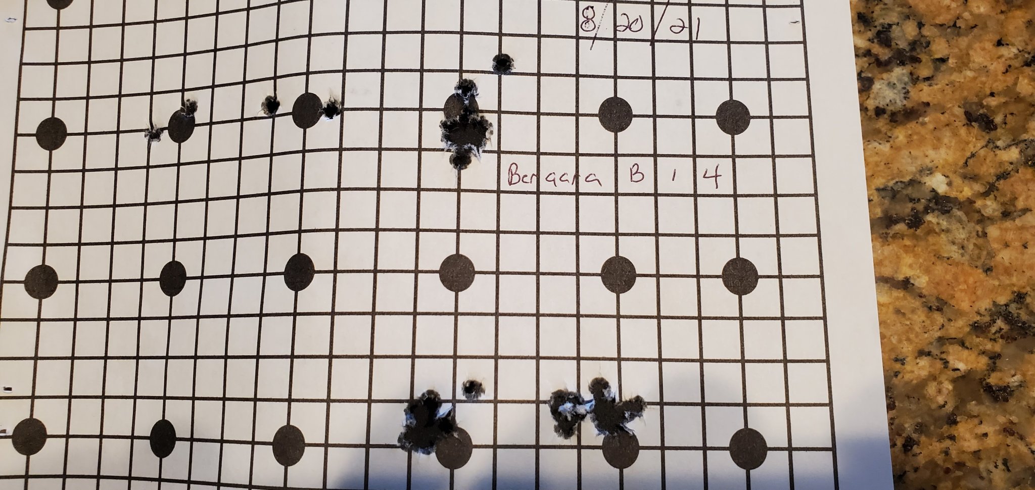

B14 R with Lapua Center X lot tested. This is 10 rounds at 50 yards with an ATS tuner on it.
Just an example of what you can get if you work at it.
Factory stock and carbon barrel with Diamond trigger.

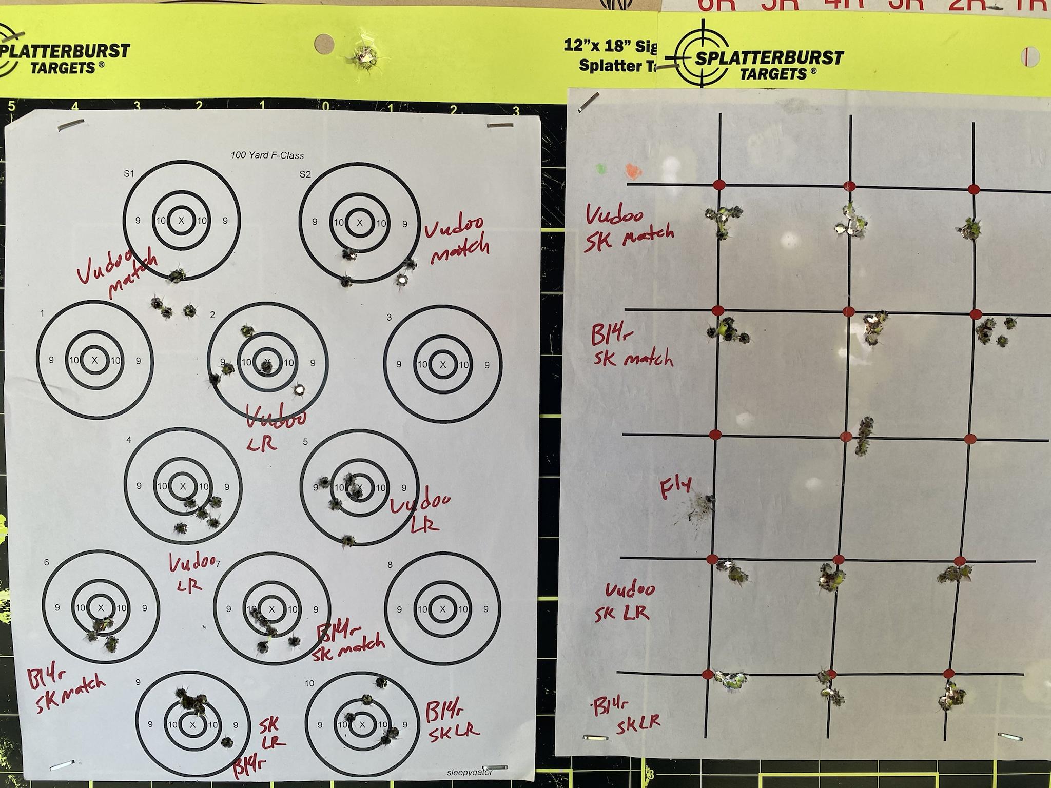

I had horrendous results with Eley Team, Match and Tenex in the past. Then, I tested lots over the past 3 days that were great. The target below is with my Vudoo, but my B14r was able to hang very close to it (shooting small pieces of broken clays on the berm 27/30 hits) at 100yds.
The only absolute with rimfire is that there are no absolutes when it comes to ammo/lots.
