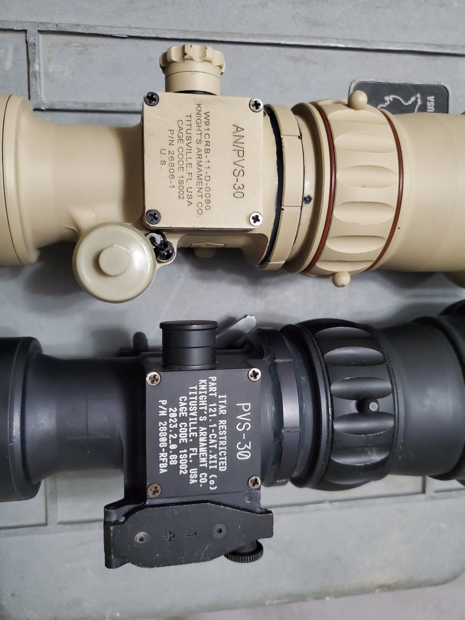

Does the newer single battery PVS30 show the FOM anywhere like the older pvs30s refurbs?
