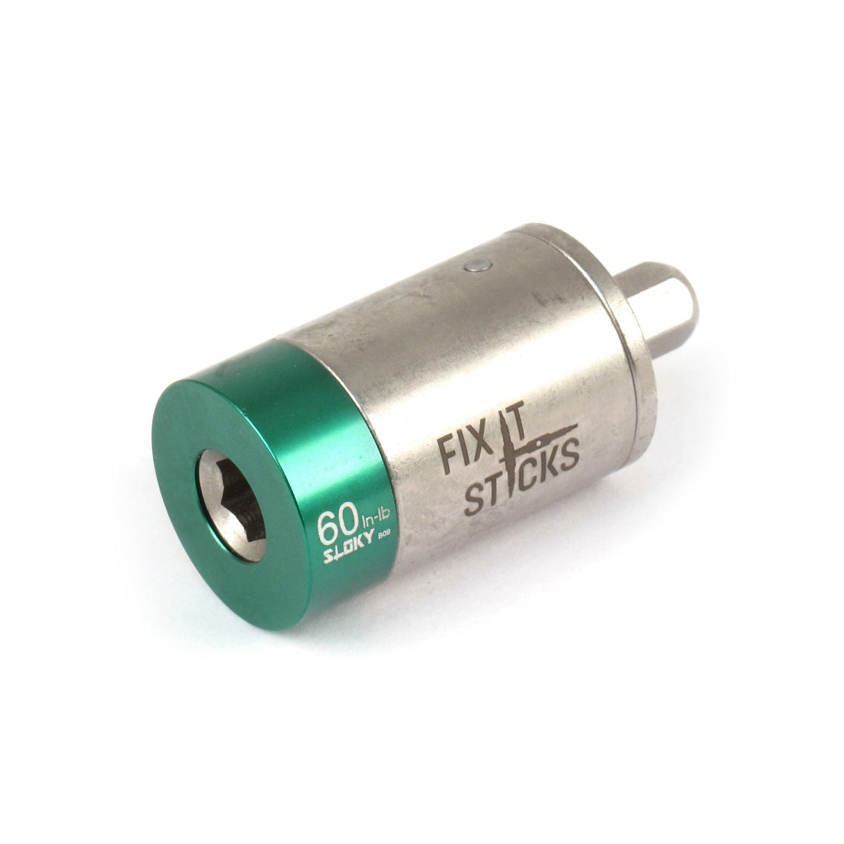

    Just order a larger Fix It Sticks limiter. That said I would not go anywhere near 100+ in/lbs on any action screws. I'd watch chasing one guys opinion.

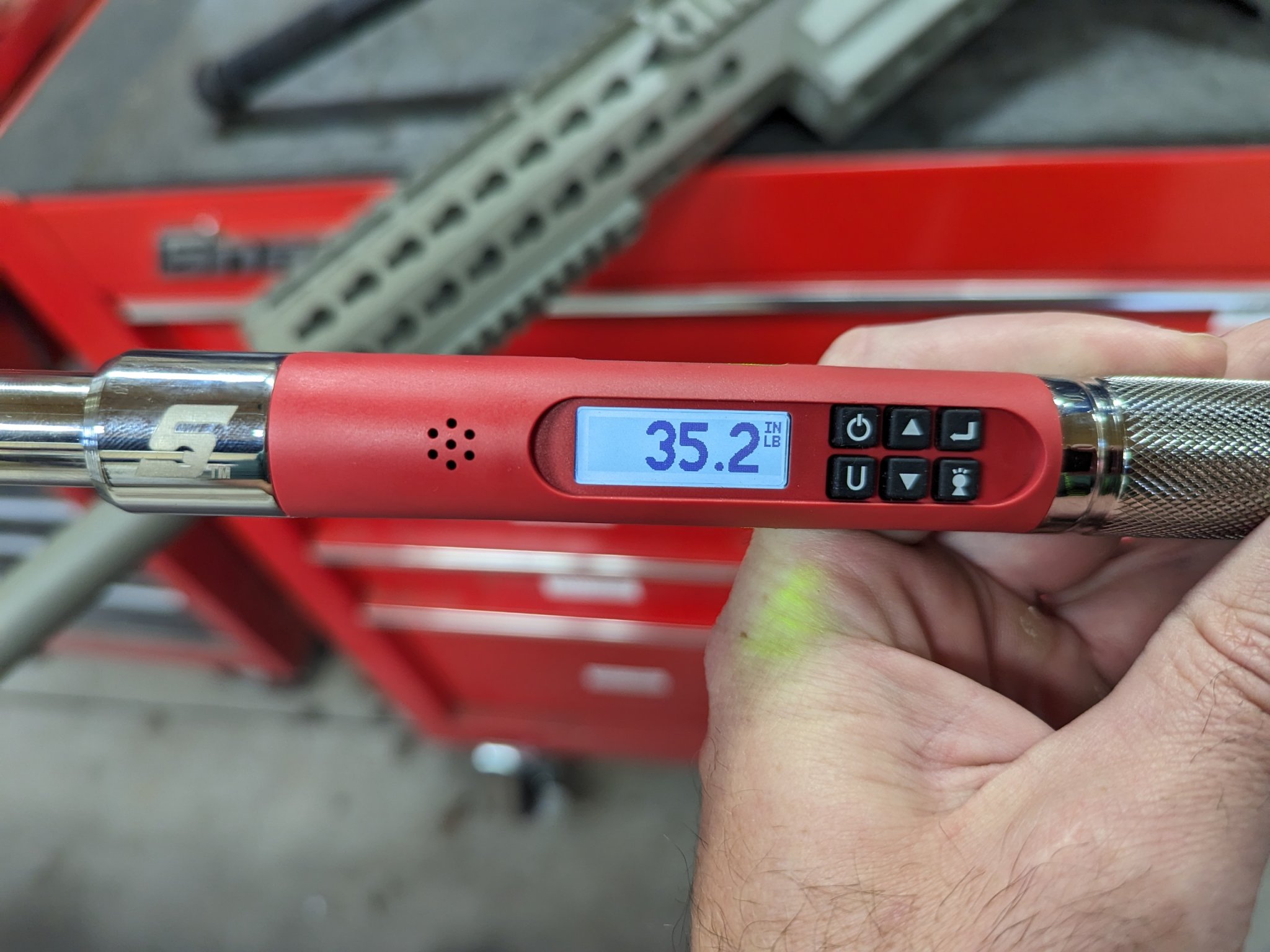

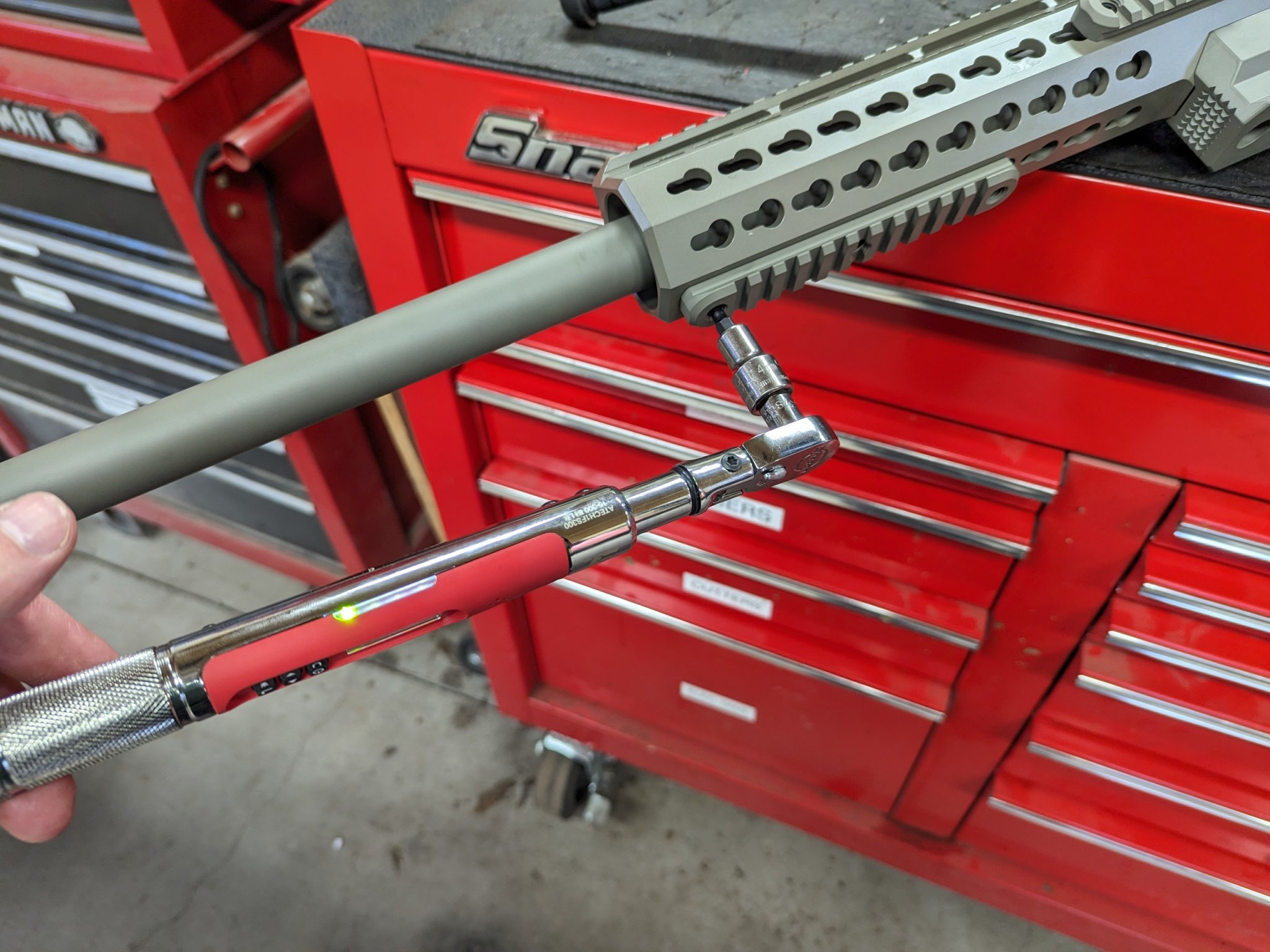

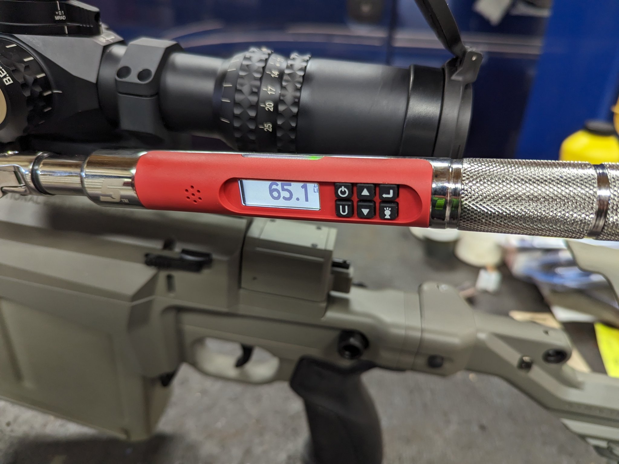

    The practical answer? Fix-It sticks. The baller answer?
    Not cheap, but then again neither is the stuff it's torquing.
    Call me a heretic, but this is all that I use:

    I have the 3/8 and 1/2" tech angle but can't talk myself into the 1/4" one yet. Great torque wrenches.
    I felt the same way when ordering these tools - there's not much apparent value in the 1/4" on a pound-per-dollar basis. I mean, the 1/2" 15-300 ft-lb wrench is about 3x the length and only costs 10% more. But any honest evaluation of my problems over the past 30 years of amateur wrench-turning suggests that the little screws are the ones which are far more likely to give me a Bad Day(tm) in the shop, and thus any tool that helps me avoid such problems is worth the money.
