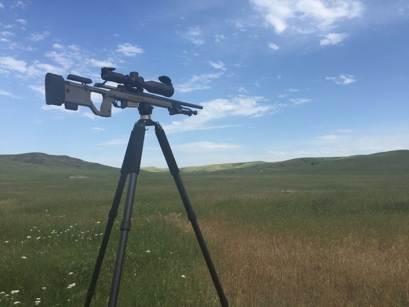

Here is a pic of my Desert Tech attached to the RRS leveling base, using their DTA adapter plate. It's tilted all the way forward, so it will show how much tilt is available from the base.

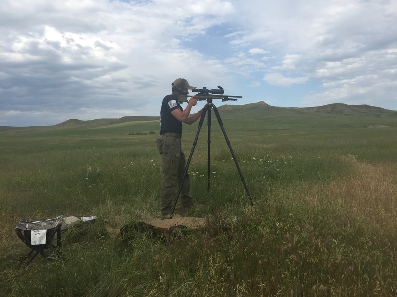

Feisol 3372 and RRS TA-U-LC leveling base has worked well for me. Below is a picture of shooting off it from a standing position, and nailing PD's out past 500 yds. Super solid, and makes getting on fleeting targets quick and easy.
