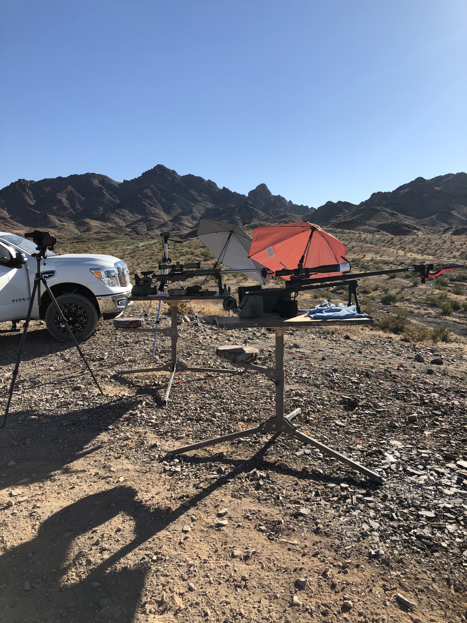

I live in Bullhead City and with have a couple of places 15 to 20 min drive from my house. We can shoot out to 4k. We were out this morning testing some rounds at 2805 yards. I am shooting the 400 CE Lazer with 131.5 N570 getting 3068 with an SD 5.6
My friend was testing some round in his 50 bmg single shot.
