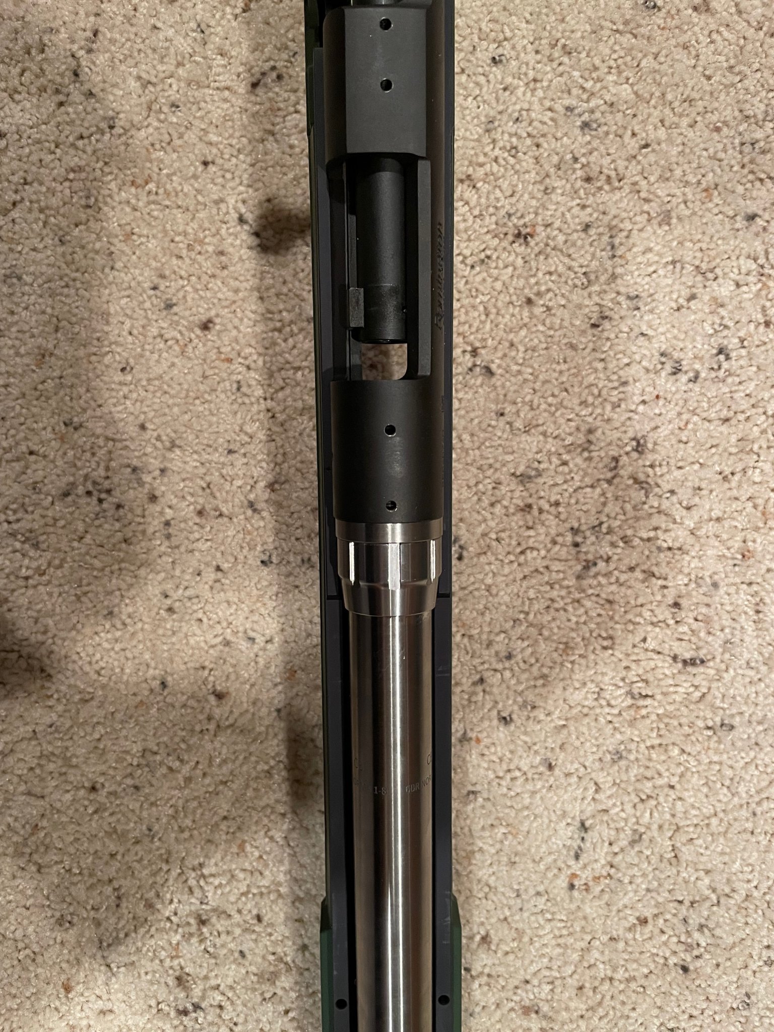

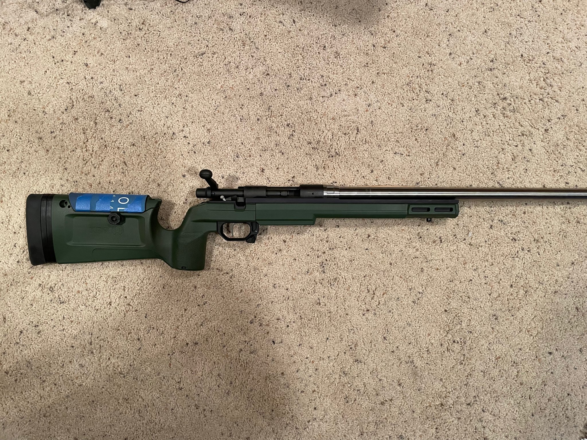

Well, got all the parts in from Northland Shooter Supply in addition to some soft jaws for my vise for my 6 BR build. Had some time yesterday and decided to get to it. My local gunsmith already removed the original barrel from the action. I cleaned up the action, paying special attention to cleaning the action threads. Next was removing the ejector from my R700 bolt, then dry fitting everything to make sure there were no fitment issues. With the new barrel threads lubricated (lightly) with some Lubriplate 130-A and the barrel nut screwed on, I screwed the barrel into the action. Put the Go gauge in the bolt and screwed the barrel in until I felt resistance and then hand screwed the barrel nut up to the action. Then tried the No Go gauge and the bolt wouldn’t drop. We’re in business! Put the action and recoil lug into the action vise and the barrel into the bench vise and torqued the nut down. Then tried the Go and No Go gauges a few more times to be safe and I was done! Ejector back into the bolt and then the barreled action into the stock. Now I have to get some of that nice new Lapua brass loaded up and get that brass a first firing. Looking forward to this being the easy button as others say!
View attachment 7834774View attachment 7834773.
From my experience it is the easy button. It is not uncommon for my 6BR to be sub 0.25 MOA (I've had several groups in that range in the same day so totally repeatable).
