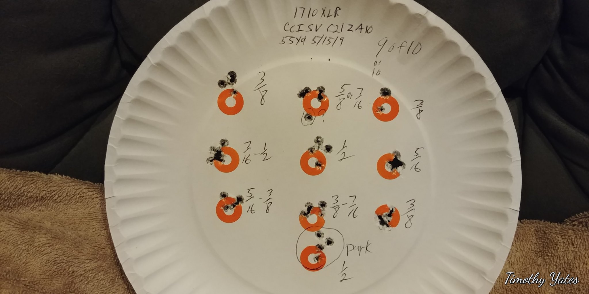

I’ve also had one magic lot. Shoots better than Eley, but only had 300 rounds of it.That lot could do 10/10 inside 2 inches at 100 and half were inside 1 inch.
CCI SV has the ability to be accurate. You just have to get lucky with the lot number. I made a note on all these targets to remind me what was shot with ZA10 lot number. I started out with three cases and I'm down to my last brick.
ZA10 lot number
Some other lot number. Same gun.

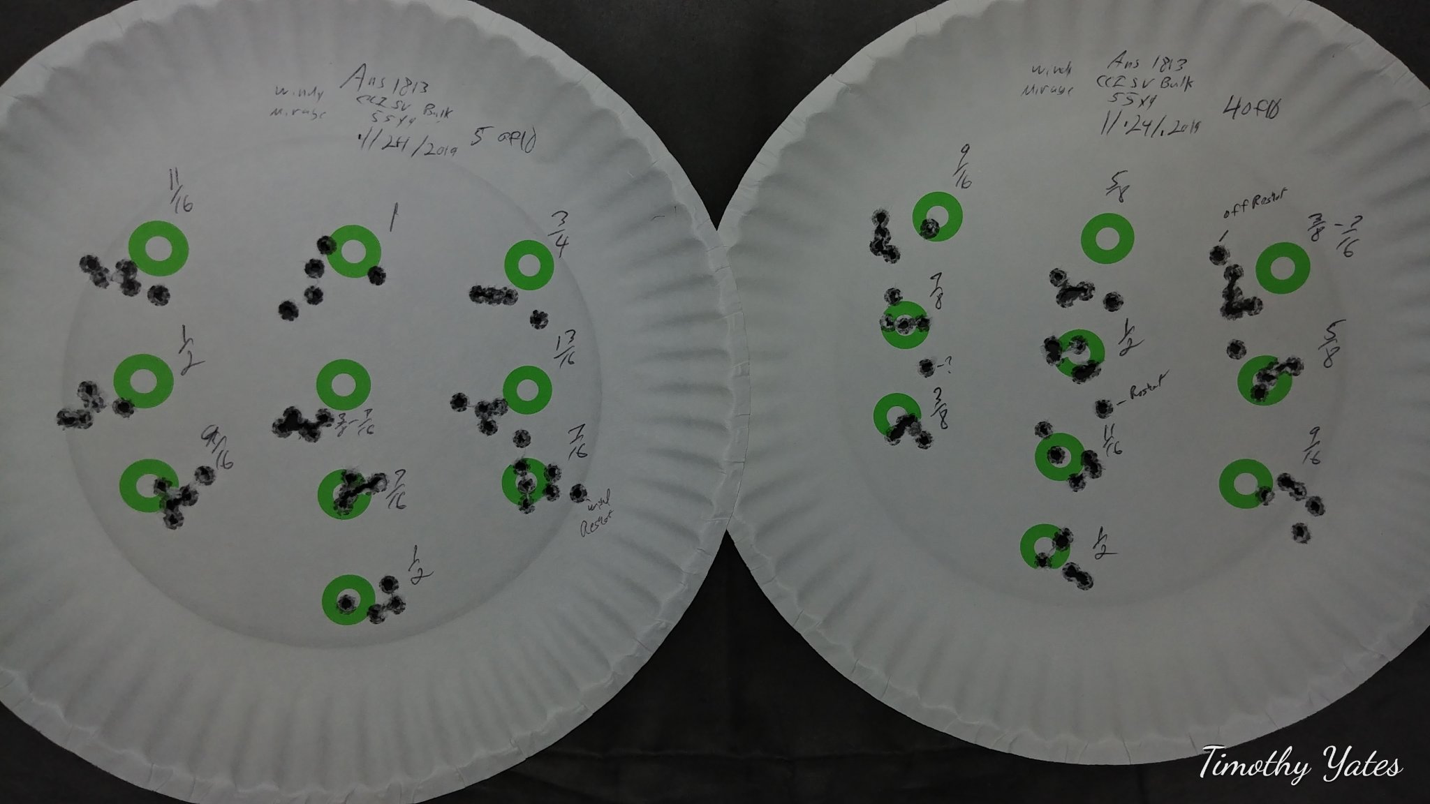

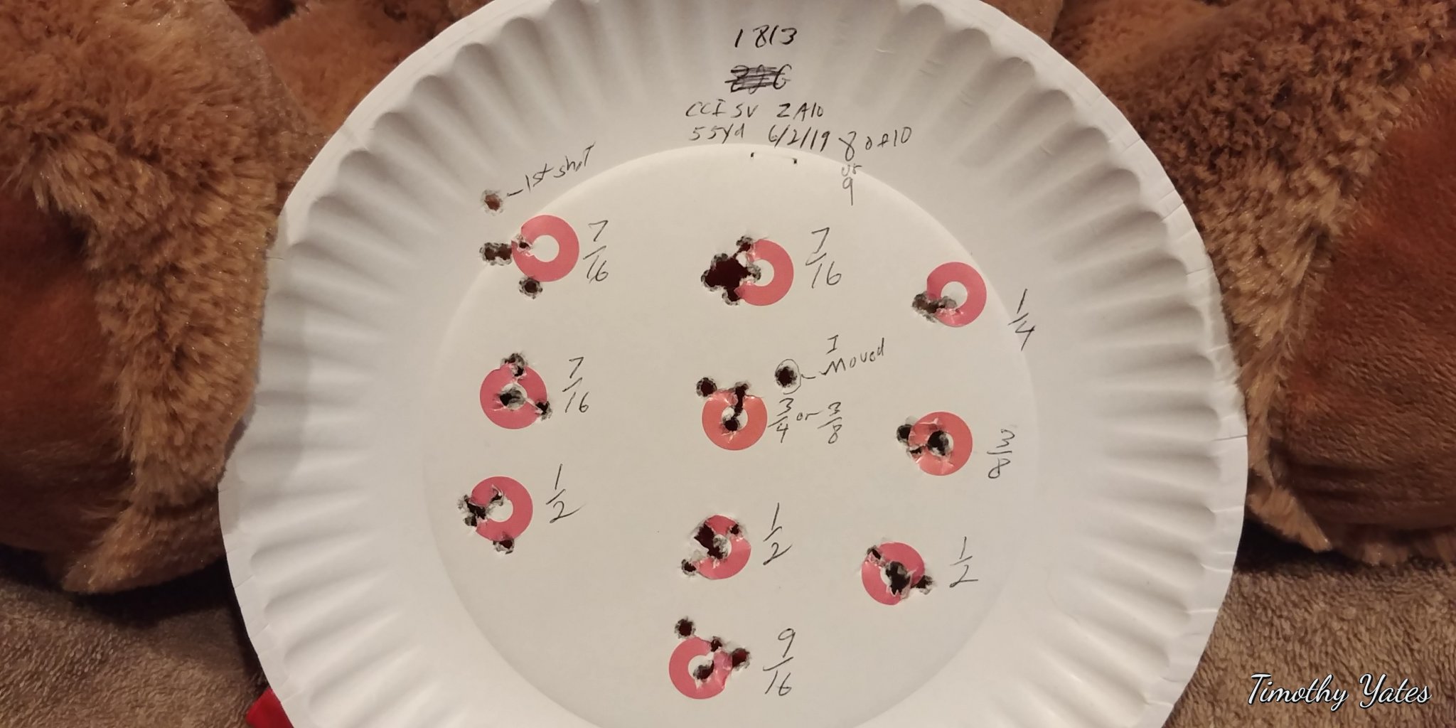

1813 ZA10
1813 some other lot number.
