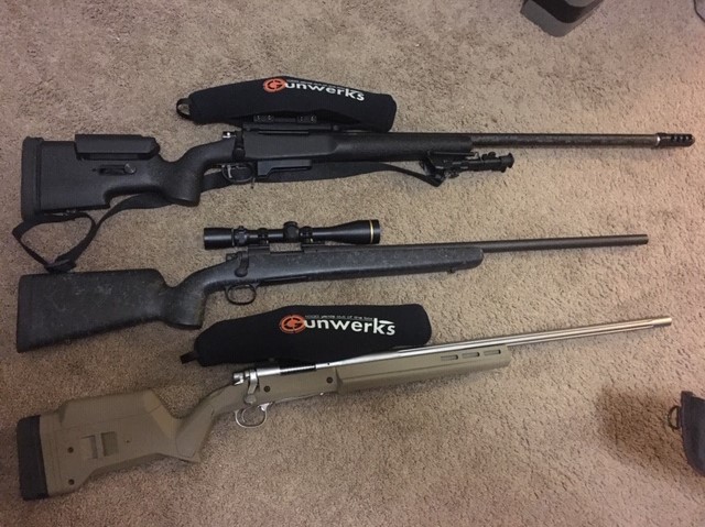

What a difference stock design and caliber make.
My old Sako TRG-42 I could see impacts in 338 Lapua and it weighed at least a couple pounds less.
My 6.5 Creedmoor I can watch impacts all day long.

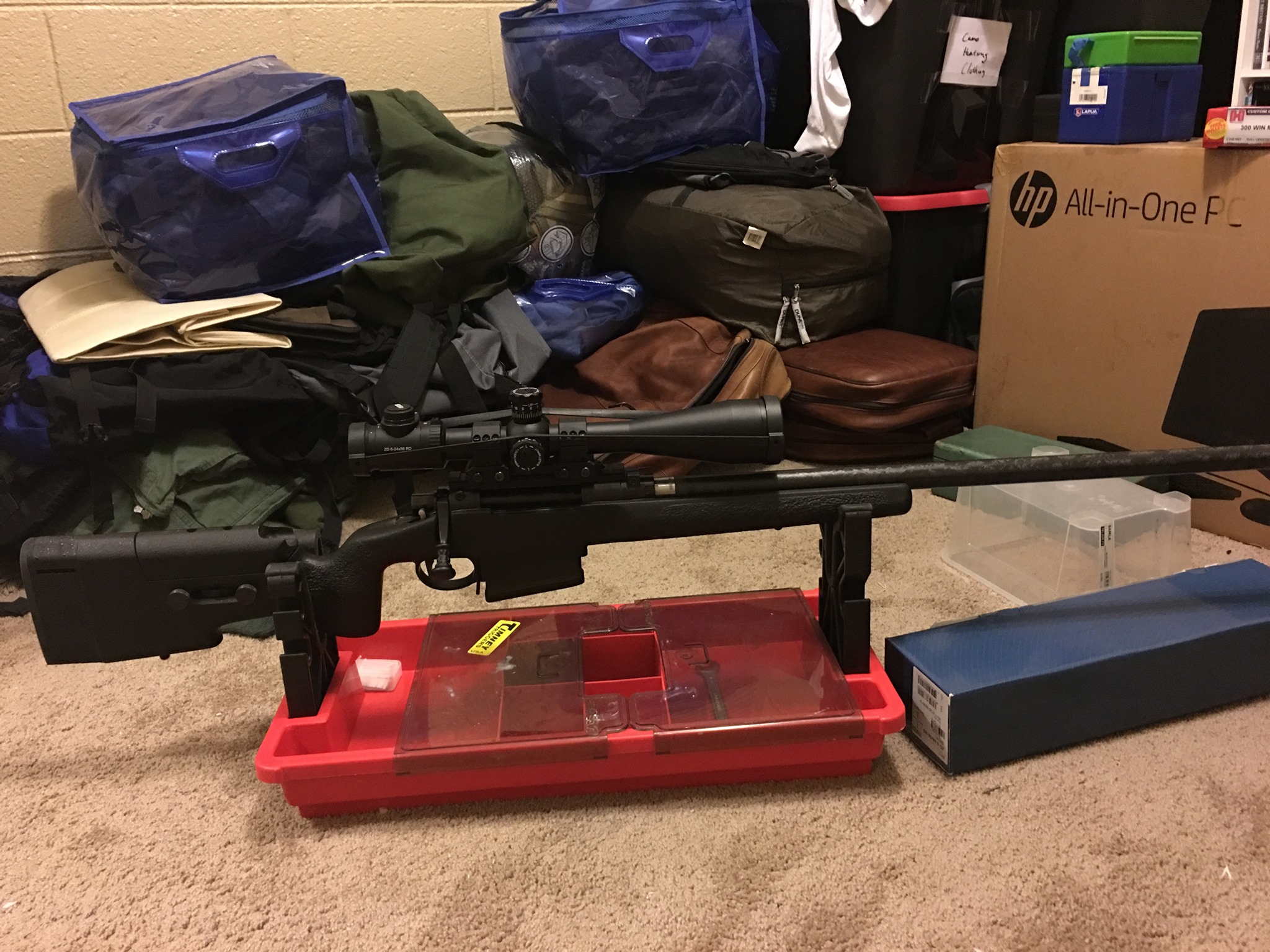

I can tonight. But this is what the recipe is.
American Rifle Company Nucleus LA
Tier 1 Uni-Mount
Meopta 6-24x56 ZD
McMillan A-5 with adjustable cheek and thumbwheel (I have some foam wrap around the cheek piece to keep it from moving and duct tape around that so it remains slick.
AICS aluminum bottom metal. Similar to Badger, but I not Badger and I can't remember who made it.
Proof 28 inch Carbon Fiber barrel
Fat Bastard Brake
CG-Xtreme Trigger
Weighs about 13 pounds. Based on manufactuers specs, I am at 12.7. But my bathroom scale tales me 13.2. So somewhere in that range.

I can spot shots with both my 300’s with a suppressor but at 100 I’d have to back the power off a bit. The rifle doesn’t move much but if I’m load testing on a higher power I’m not spotting shots at 100-200 yds
