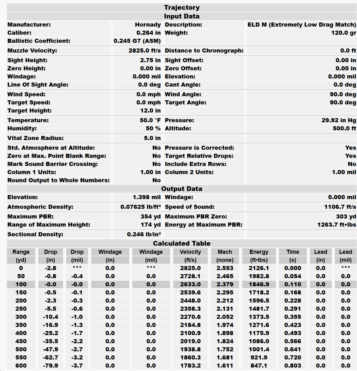

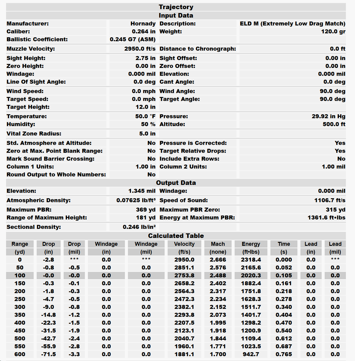

3.2 MILs just seems high for a 120g ELD moving at that speed. I looked at my data versus some generic data based on your data (see below) and the numbers aren't off by much.
My data says 2.5 MILs to 550 yards for that bullet (granted I am moving it at 3030 FPS out of a 260R). Same atmosphere.
Your data ran though JBM (sight height guessed): 2.8 MILs
7044993
In fact, I have to slow down your bullet to 2825 to make the data match (again, this is sort of rough - but still valid in it's own).
7044994

You should not have trued up your muzzle velocity that much. This is almost surely the main cause of your issue. You need to check velocity and leave that pretty dang exact in your calculator. Shoot at about 1,000 yards and change the B.C. in your calculator until reality and your dope line up. The free version of Strelok can do wonky things with B.C. some times, but once it is trued up at long distance you will have great results from there and closer.
Reactions: _Raining
